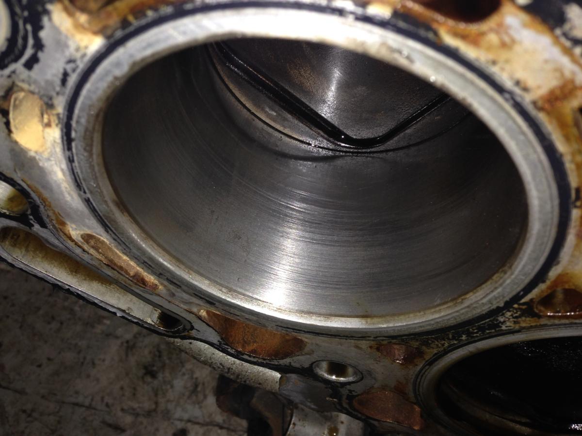

Can the block be saved with that damage ?
Good question, as its a close deck block ive gone ahead and had it split, just awaiting martins verdict. its was put togther with some form of sealant and had no gaskets whats so ever.

What's the condition of the bore sleves in the cdb ?
You might get away with just a hone , if not mabye a over bore .

Bores arnt too bad one is pitted so going for a +1 on all 4.

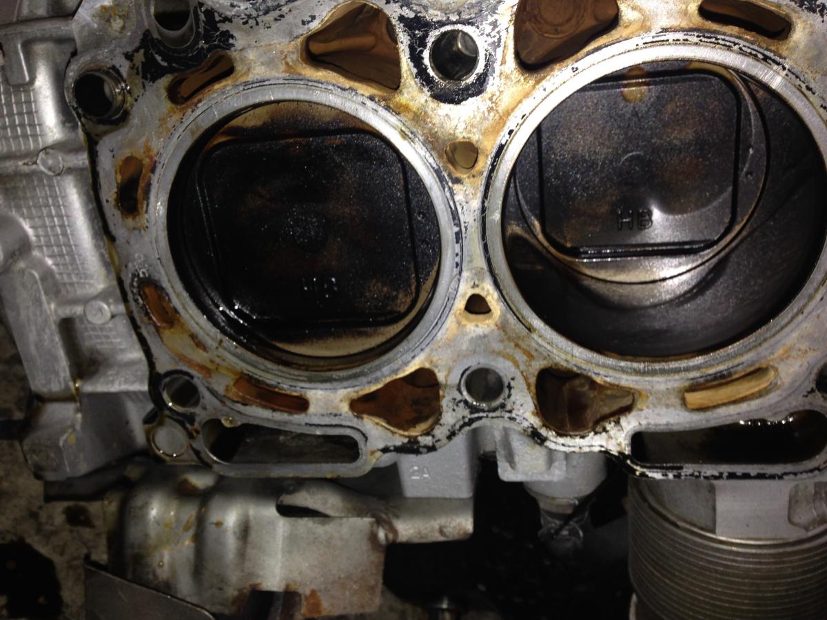

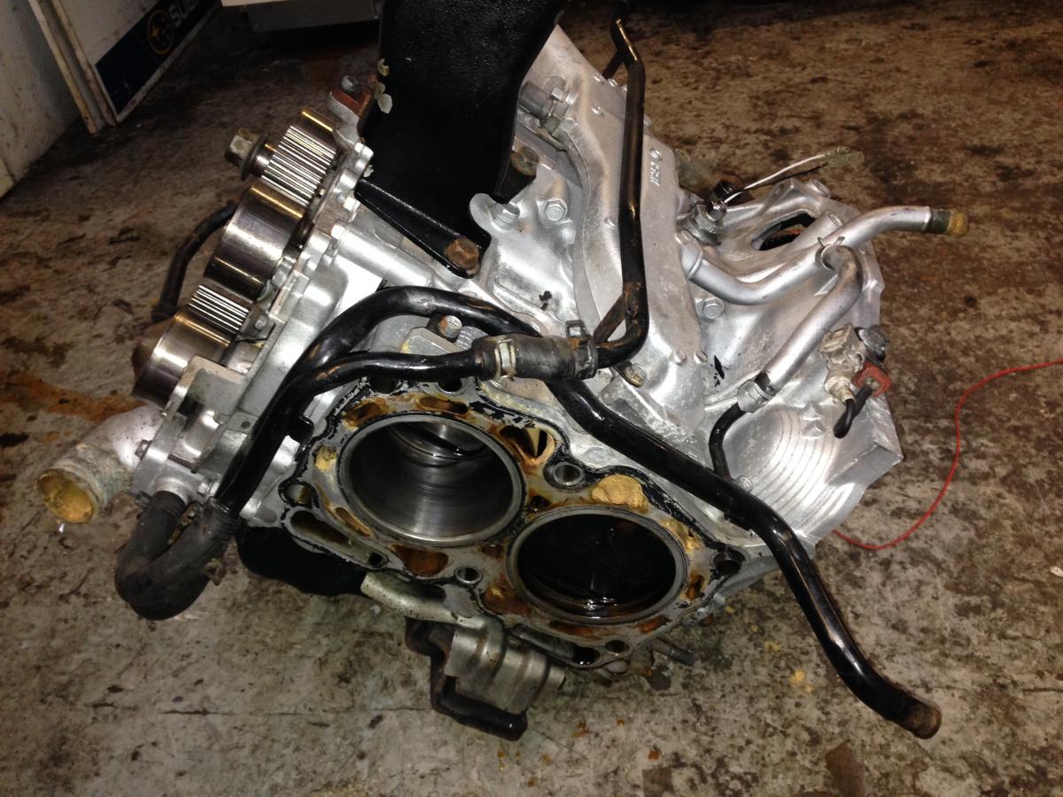

Here are some pictures of the block itself. didnt bother with the heads as there a complete rightoff.
As such i need x2 Heads off a V5
TD05 ( two good condition TD04's For sale)
STI intercooler.
and a few other parts.
post-1324-0-40476000-1390154551_thumb.jp
post-1324-0-20678000-1390154559_thumb.jp
post-1324-0-23600700-1390154566_thumb.jp
post-1324-0-06803600-1390154573_thumb.jp
post-1324-0-70361800-1390154577_thumb.jp
