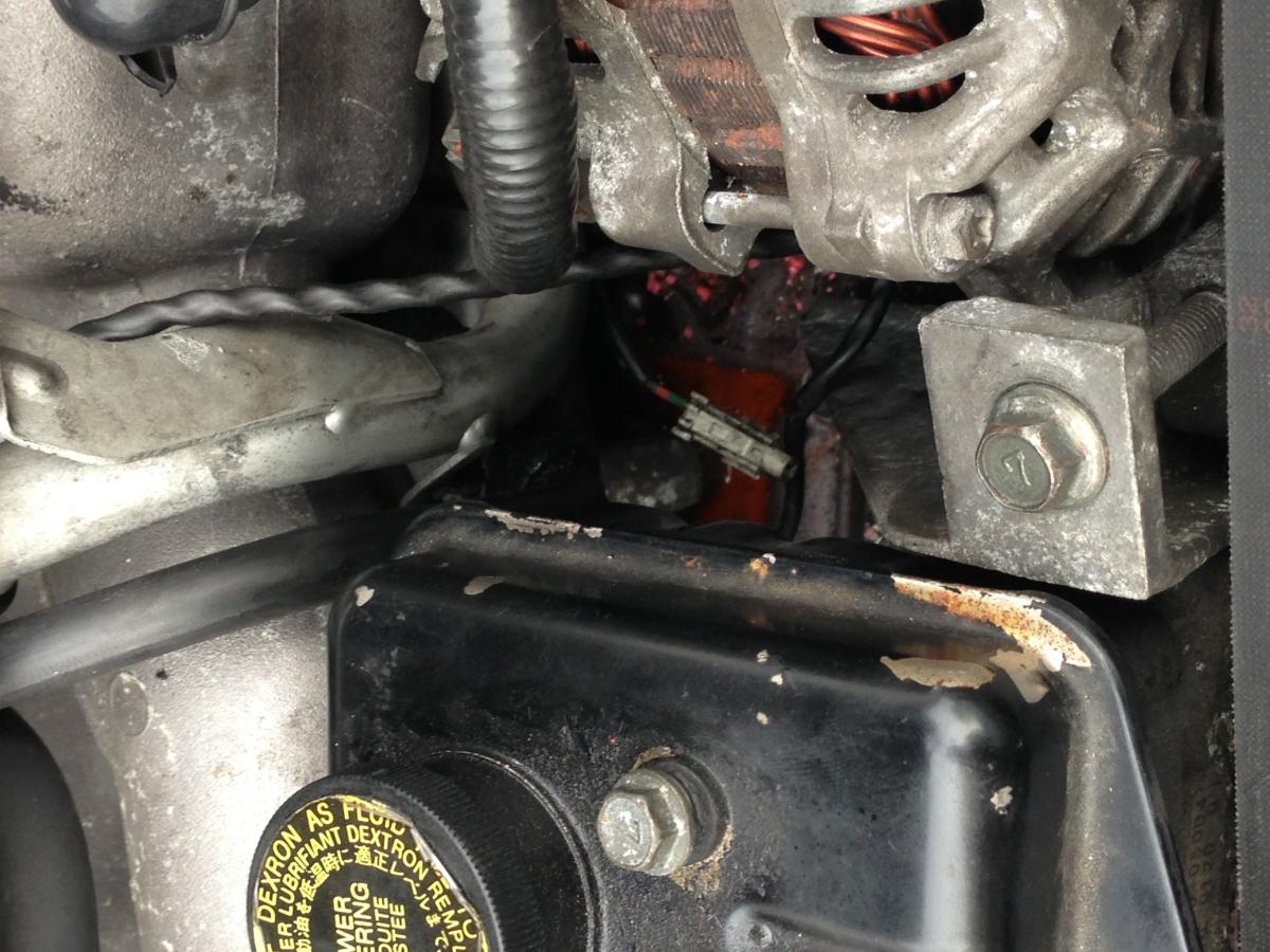

Wheres this meant to go? Its hanging there it
May be why car not starting , ive gt spark and fuel i tried easy start too but nothing
That looks like the plug for the back of the power steering pump.
Agreed from the picture
