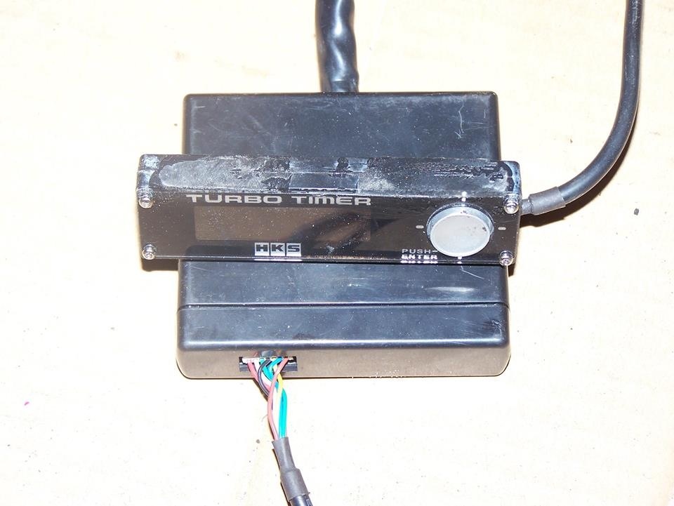

post-1928-13964522495_thumb.jpg this is it
You do have to tap it into the handbrake, the turbo timer won't come on if the handbrake isn't on. Or in theory you could put a piece of metal on top of the handbrake contact and trick it into thinking the handbrake is on all the time but the dash light is on, or you could find out what signal the hanbrake gives off and replicate it somehow. Although I would keep the handbrake on if not in car and the engine is on.
Yeah you do but I'm guilty of not doing that to others disapproval :D just the earth wire did it if I remember correctly
I do live in a hilly area so leave the handbrake on and in gear out of habit. Mine didn't work with just the earth wire.

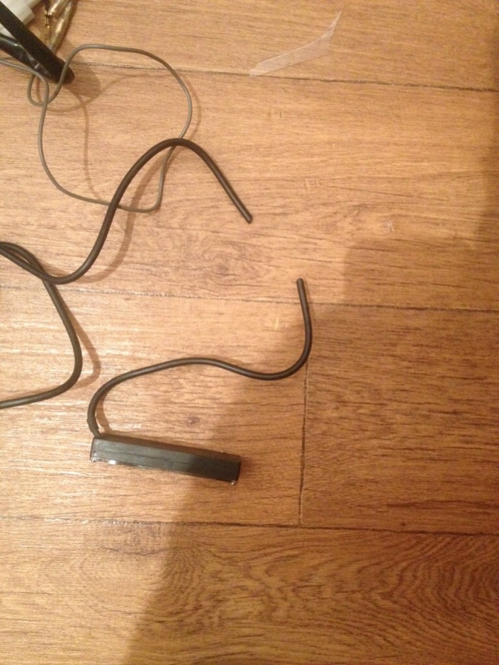

Got it today and look the wire to module is cut waiting for seller to get back to me as he never said nothing about it before sure I can sort it with a block connector or somethingpost-1928-139661419266_thumb.jpg
