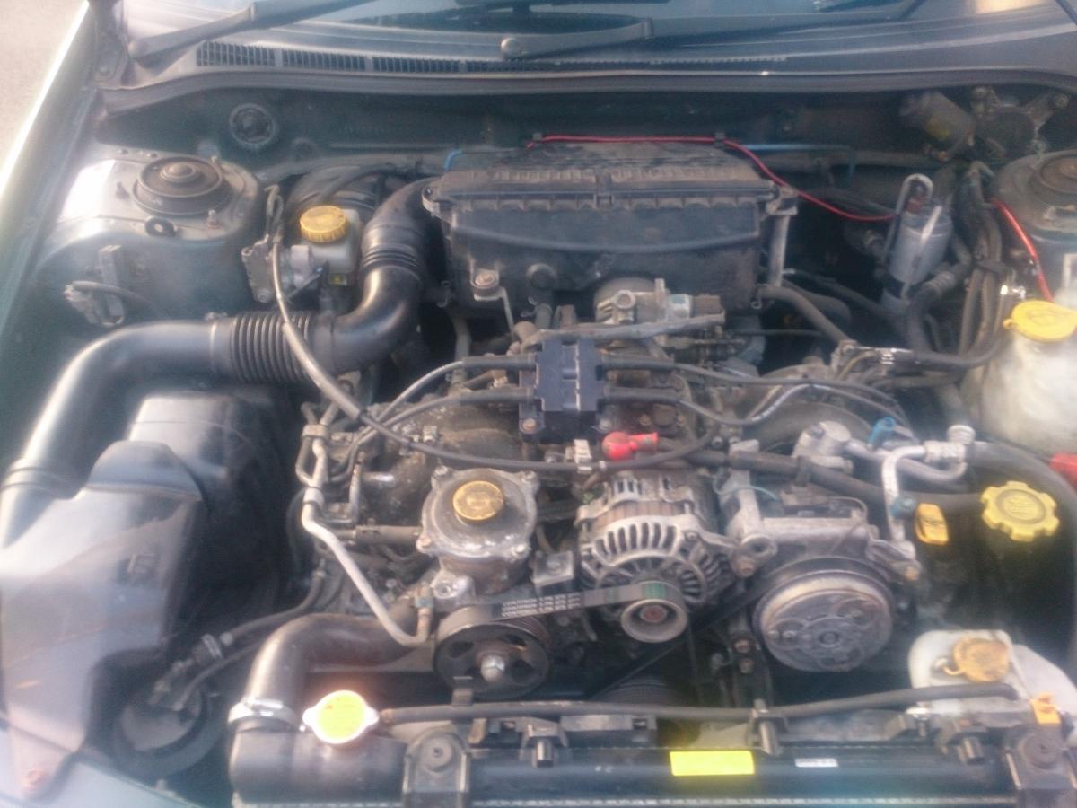

That's my engine bay and if you can see it's just got a plastic intake no sensors all the way up to the filter I appreciate all.your help guys really do

Maf should be after the airfilter box but can't see one :(
Scooby Petes said what I would have said with the problems. I'd also check for any split cracked damaged pipes. spray some water around the air intake bits after it's warmed up and started to idle and run lumpy. I would say it's got a split pipe so would be 1st thing I would check :)
