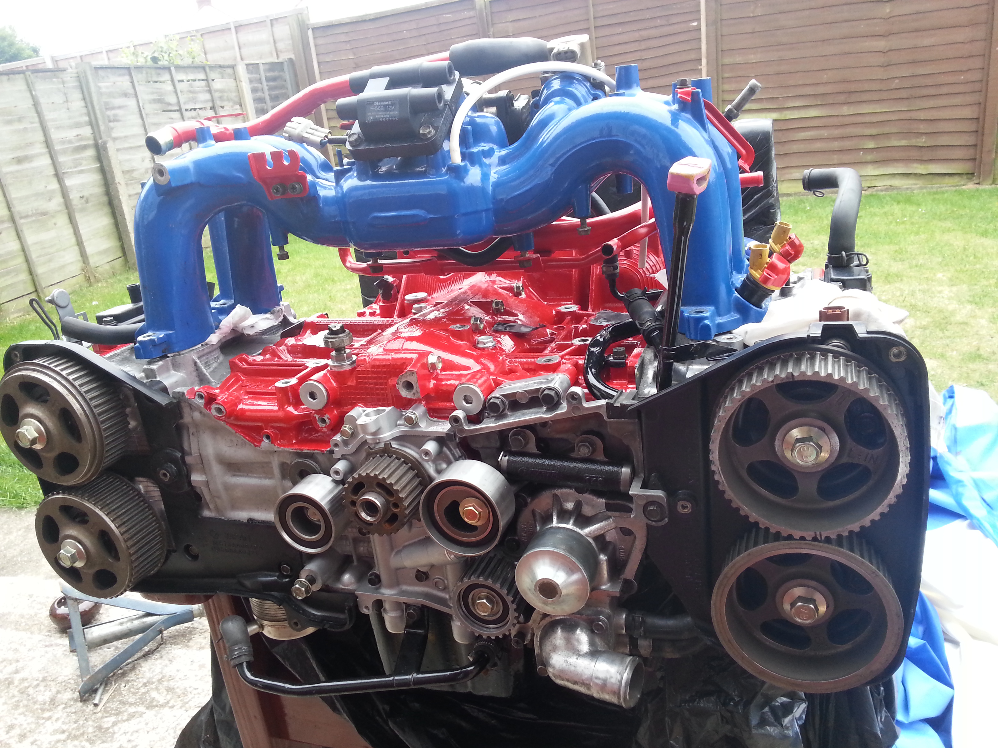

A rally engine builder gave me a bit of advice while i was building my engine and described the earlier tensioner as "hydraulic" rather than spring loaded
Here's a pic of the early one in situ it looks like a little hydraulic piston above the water pump and is different to either one in the links
Yeh they basically same in principal as both types are hydraulic.
Your type has the hydraulic over spring assembly in the separate alloy cylinder that then pushes the piston onto a tab on the pulley.
Later type has the pulley & hydraulic over spring assembly all in one working as a pivoting arm.
I like the earlier one too as hydraulic unit stronger & the pulley is stronger in mounting too.
Got that type on my old 95 Legacy ...
Not everything new is better, bit like front wishbone bushing idea on the 05 onward foresters went a bit junk ...
