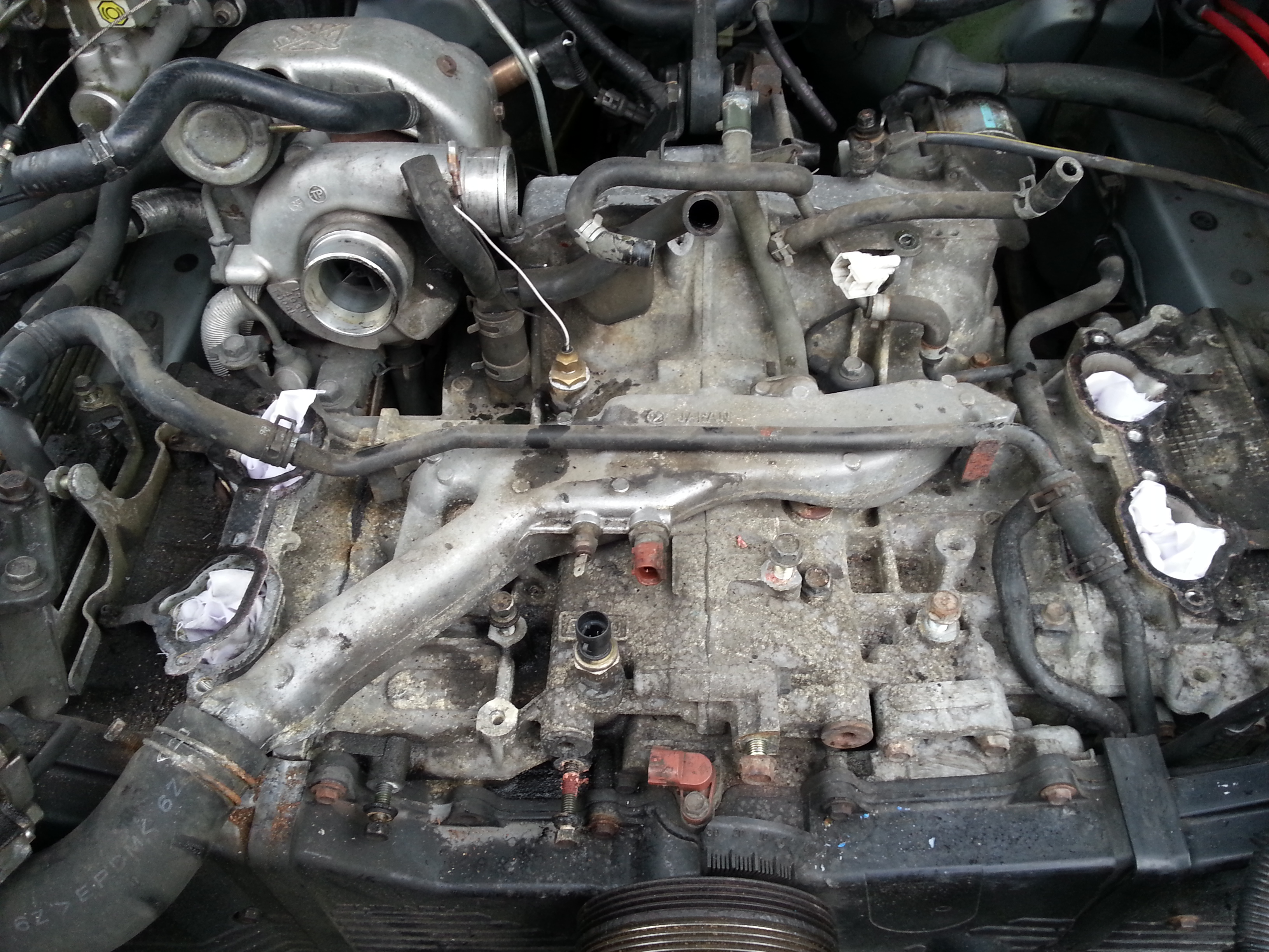

Oil pressure is the black plug at the front which fits in place of the oe sender
Oil temp is the white wire at the rear left ,make sure the area around the bung is clean before removing original bung (you don't want !Removed! dropping in the oilway above cylinder 3)
fit the brass "ferrule" (nut with the hole in stants kit) and then screw the oil temp sender into the ferrule . Make sure you do it in that order as the sender hole in the ferrule is sometimes tapered to aid a seal
Boost just needs vacuum and you've probably got a blanked take off on the inlet .

as it's a subaru specific part made to locate the oil temp sensor above cylinder number 3 (hottest cylinder next to the turbo)
most kits are for a wider range of makes so I had to buy "stants" kit just for the brass bung with a threaded hole in it, see when they turn up .

I was lazy and installed mine on top of no 3 cylinder so would need to relocate the oil pressure to under the alternator, and add another sender to the original bung. Just depends of I can be arsed

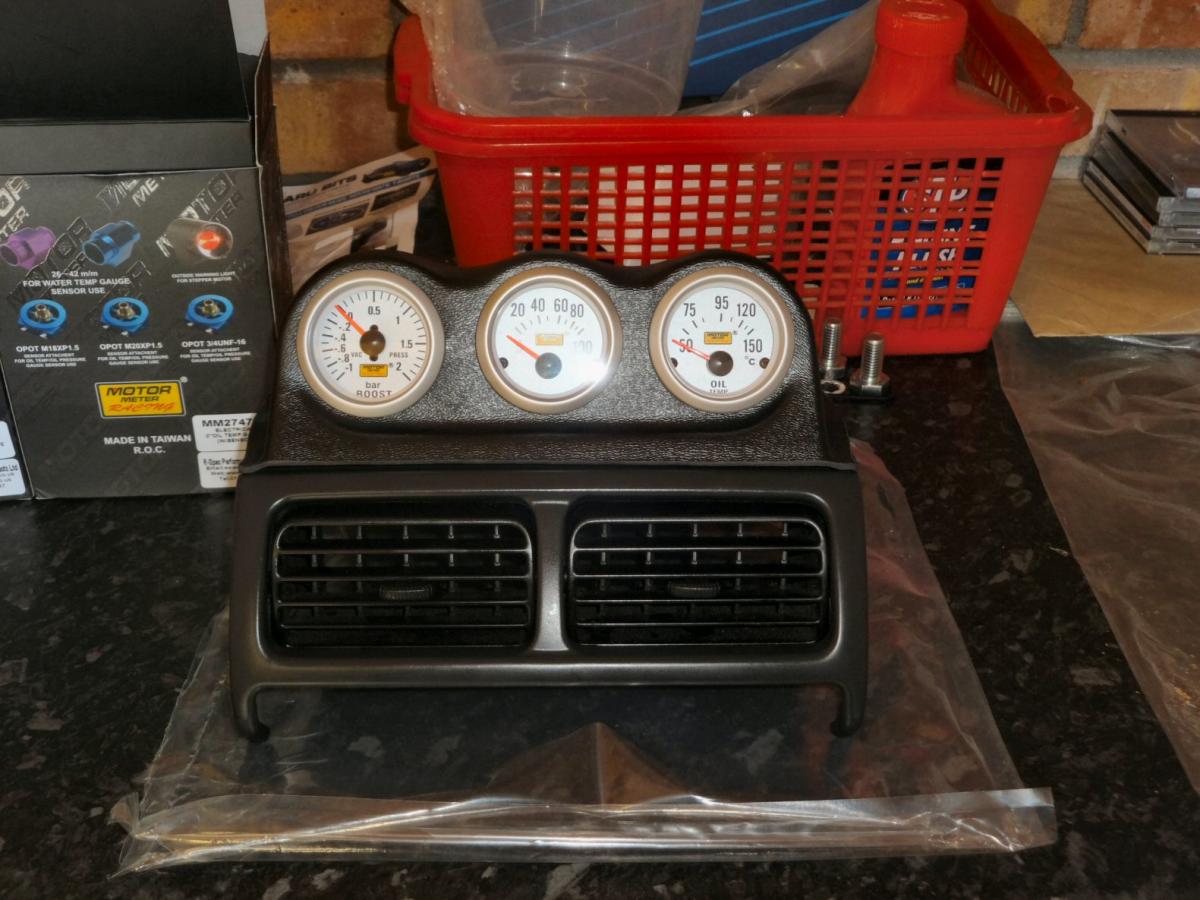

Right everything has arrived now,gauges,dash pod,"stants kit" so let the madness begin...Well on Saturday hopefully..Better get my swear tin at the ready :D
Good news mate i'd start by just offering the pod and gauges up to each other make sure everything fits before you start ripping the dash apart,
Yea knowing me I normally jump in head first,so i'll take my time on this, pod and gauges then boost gauge first as its the easiest.
did you get a center pod?

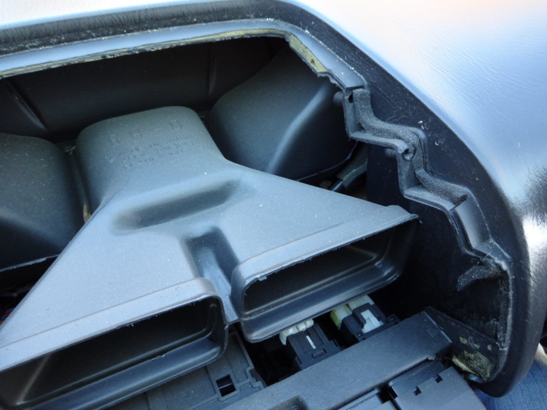

Heres a pic of the gauges,but wheres the feed from the clock? Or can I use a feed from somewhere else?Few quid in the swear tin so far :angry:
post-2940-0-87809400-1417866720_thumb.jp
post-2940-0-94106100-1417866727_thumb.jp
Hmm did you cat not have the clock situated where you've put the pod ?
If not you could always take the perm live and battery on live from the hazard warning switch. Does mean removing more of the facia, do you have a multi meter ?
Don't know what you mean about the clock?Got a meter and at the moment ive taken a live and ground off the cig lighter(thought about hazards),not connected permanent yet,just testing,got the vac pipe through that !Removed! grommet,going to test in a while-having a cuppa now
