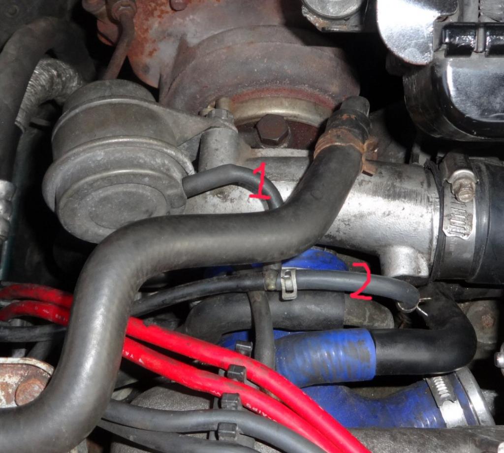

Boost gauge lights up,no movement on gauge when I took it for a run?Have I put the t piece in the wrong place?I put it where number 2 is?

I think so, I was told to take it from as close to the manifold as possible, I cut the vac hose that runs from the manifold to the boost soliniod. And inserted there. I'll see if I have a pic
Cheers stants..Gave up as the missus was giving me grief !So its a right mess inside my car at the mo :D
I can't highlight the area I'm afraid but if you zoom in to the left of the coil pack underneath the ht leads you'll see the t piece where I plumbed mine in

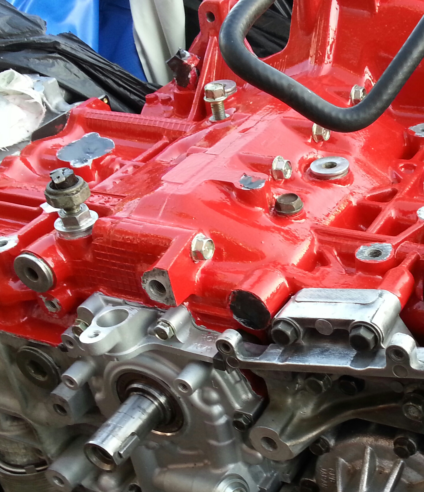

Sounds like they're electronic sensors by the description, I didn't take any specific pics when I fitted my sensors
First pic shows oe oil pressure sensor and bung for oil temp
The oil pressure is behind the alternator (on cars without ac) just remove the belt ,loosen the alternator and swing it out of the way .
Remove the plug and undo the top brass bit (not the nut with the hole in) fit the new sensor and run the wires back to the gauge .
You can just see the silver oil temp bung behind the black pipe and gold vertical bolt in first pic . The bung is a pita to get out so removing as much as possible to gain better access is best ,Mabey do this when you upgrade your turbo as most of the bits will be out of the way [emoji6]

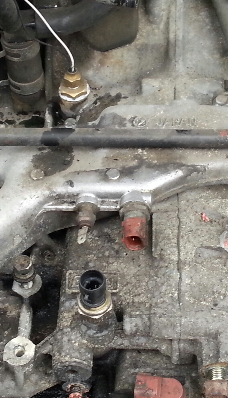

Second pic shows both electric sensors fitted but note the brass bung with the hole in (from stants kit) is fitted first and the electronic temp sensor (with a white wire attached to it ) is fitted into the brass bung with the hole in
Dunno if that makes sense but best of luck bud [emoji4]
