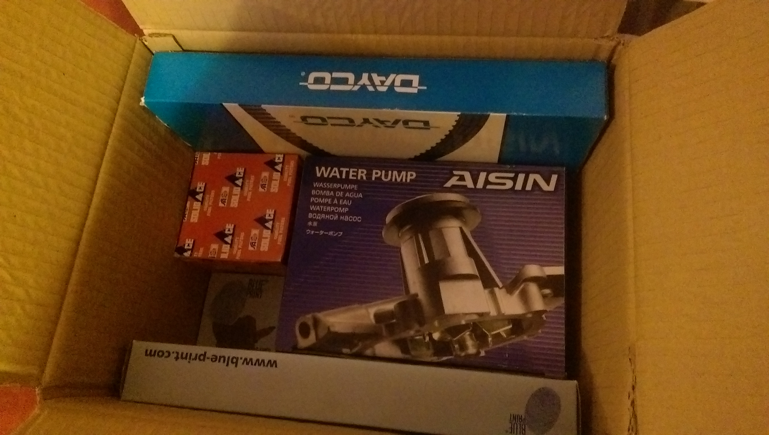

Up to you what you do but a belt & waterpump could be your low  cost option if you so wish. ICP do Dayco belt & quality Jap made pump for £76 the set.
Blueprint pumps are about £42, Mahle pumps about £31.
Mr B thank you for that. I appreciate all your help and advice. I'll go for the belt and pump and have the mechanic check out the condition of the tensioners/idlers. Do we get any discount with icp?

If ordering from ICP give reg/chassis number via ebay before buying just to be sure all right parts & no hassle.

Belt & pump, Dayco is part of same company who do Subaru OEM belts too.
I only use ICP Dayco or Blueprint kits, not fan of gates myself.
