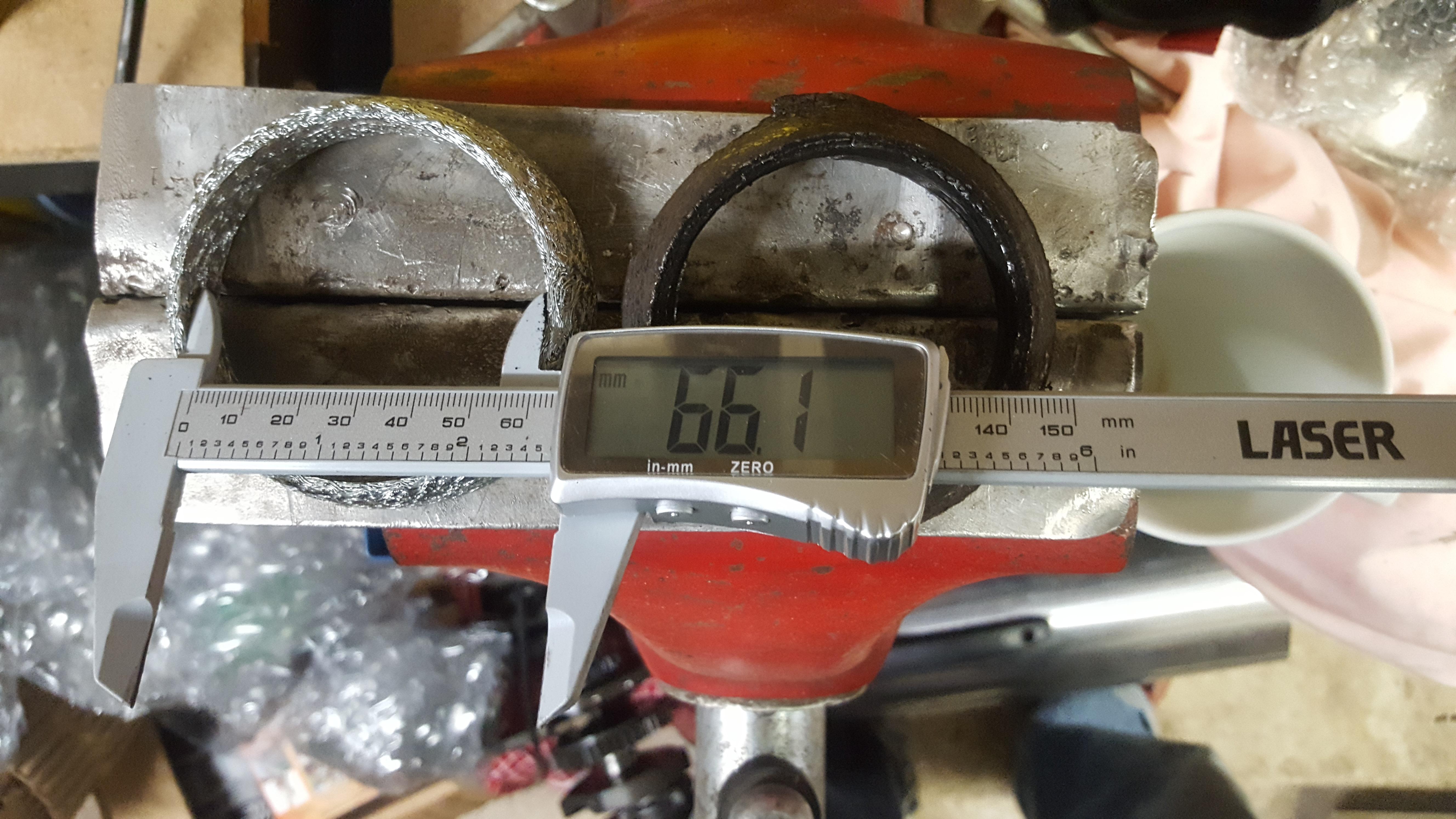

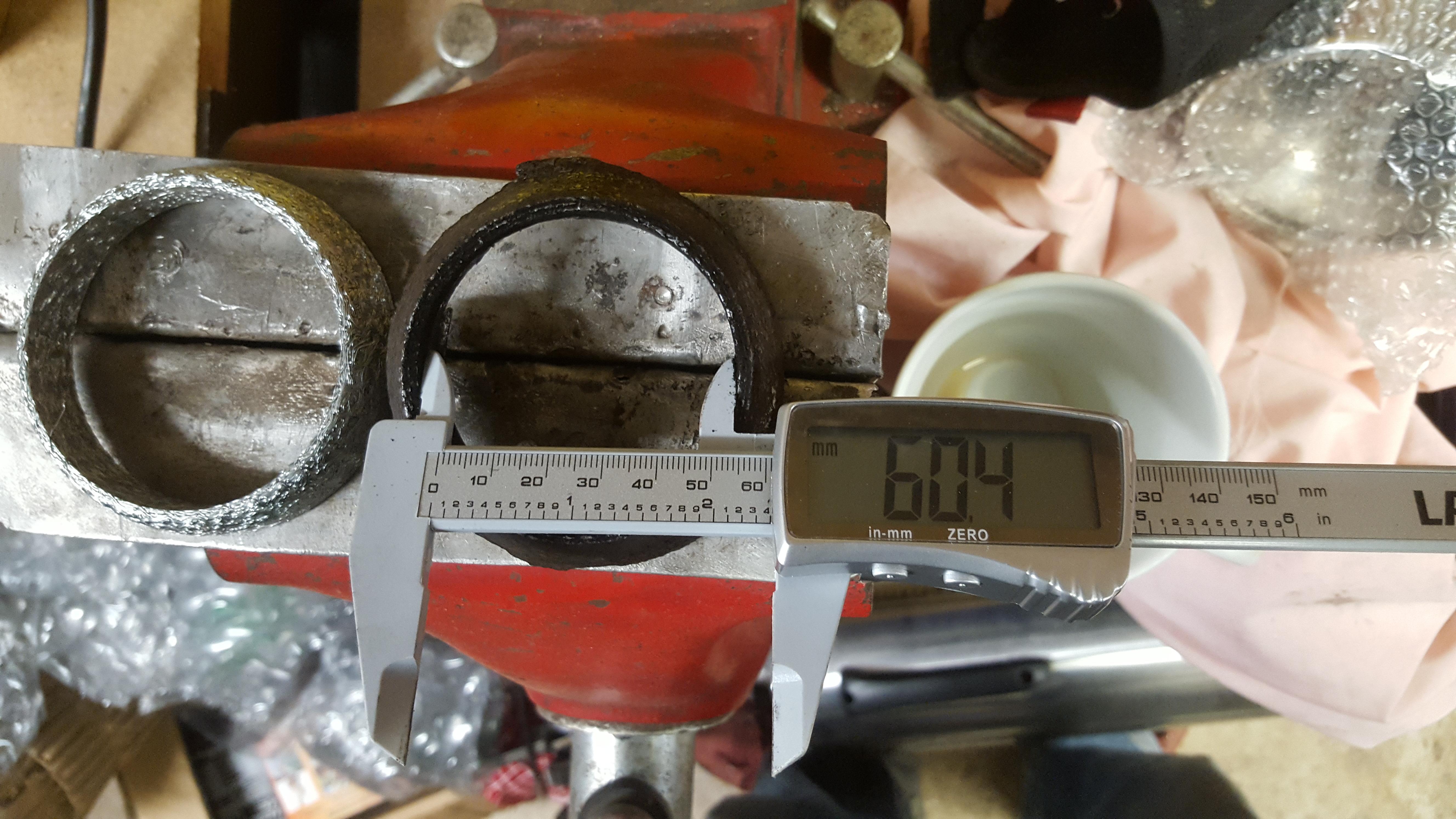

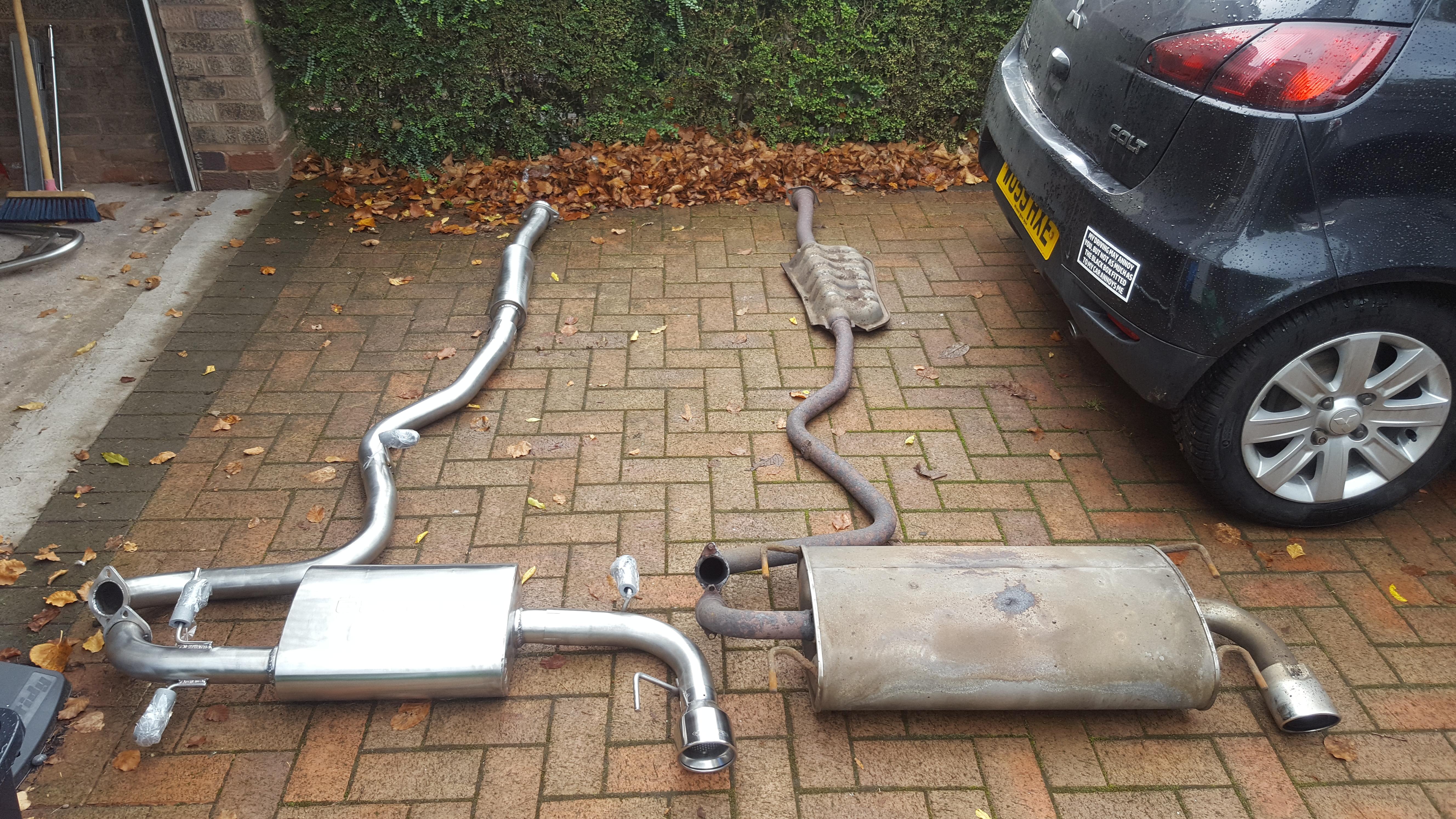

Jay762 Posted November 1, 2018 Author Report Share Posted November 1, 2018 Changing the exhaust - not many listed for this motor being an NA so after quite a few weeks researching took a punt on one for a WRX - S, turbo but single exhaust outlet. Opted for the Cobra one as full stainless, good price point and not too loud. Turns out it is compatible. There is a single difference and this is the donut gasket between cat section and main system. The WRX S has a larger bore pipe so the inner diameter of the donut supplied by Cobra is 66mm where the RX is 60mm - the outside diameters are the same so if you can get away with the gasket not disintegrating (mine did) a bit of exhaust gum and you can reuse. If not eBay can get you a replacement 1 Quote Link to comment Share on other sites More sharing options...

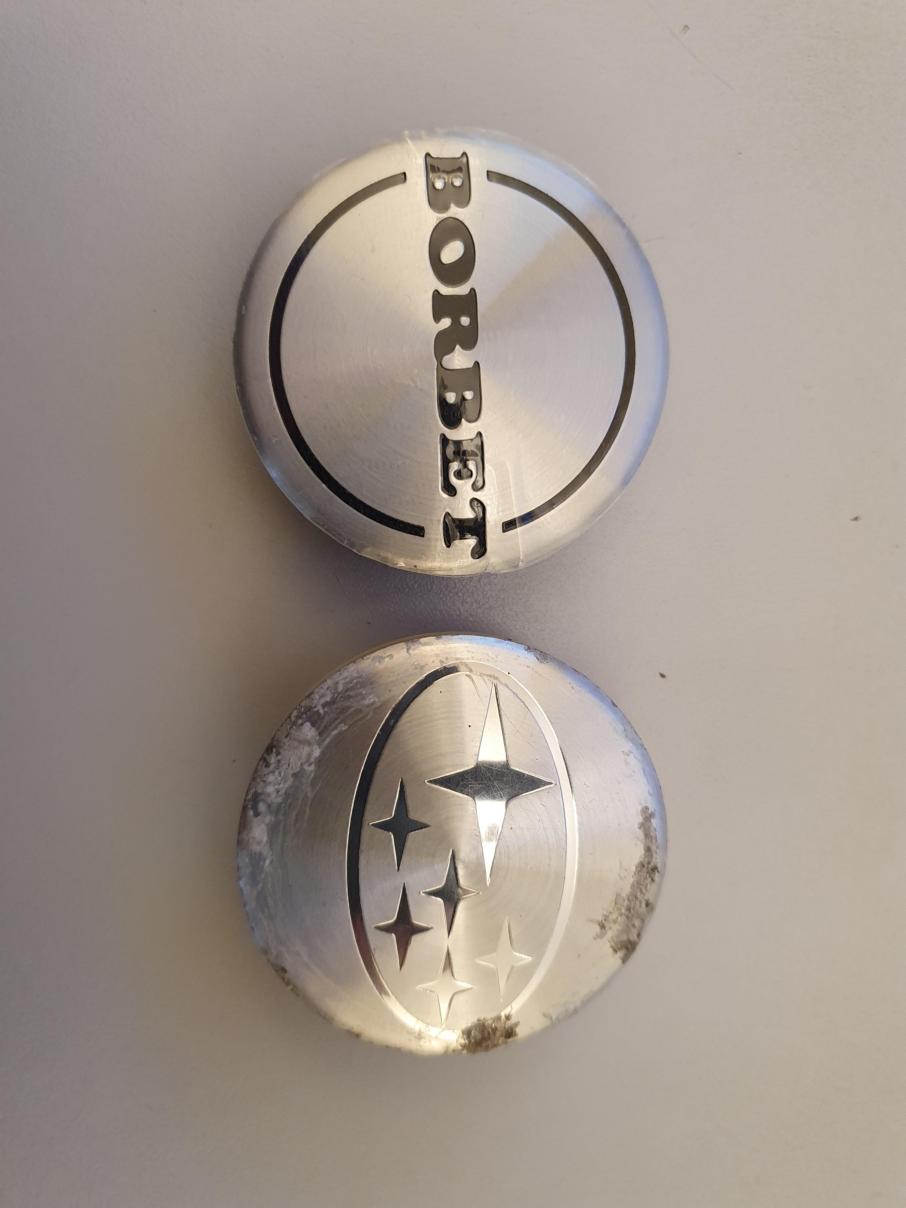

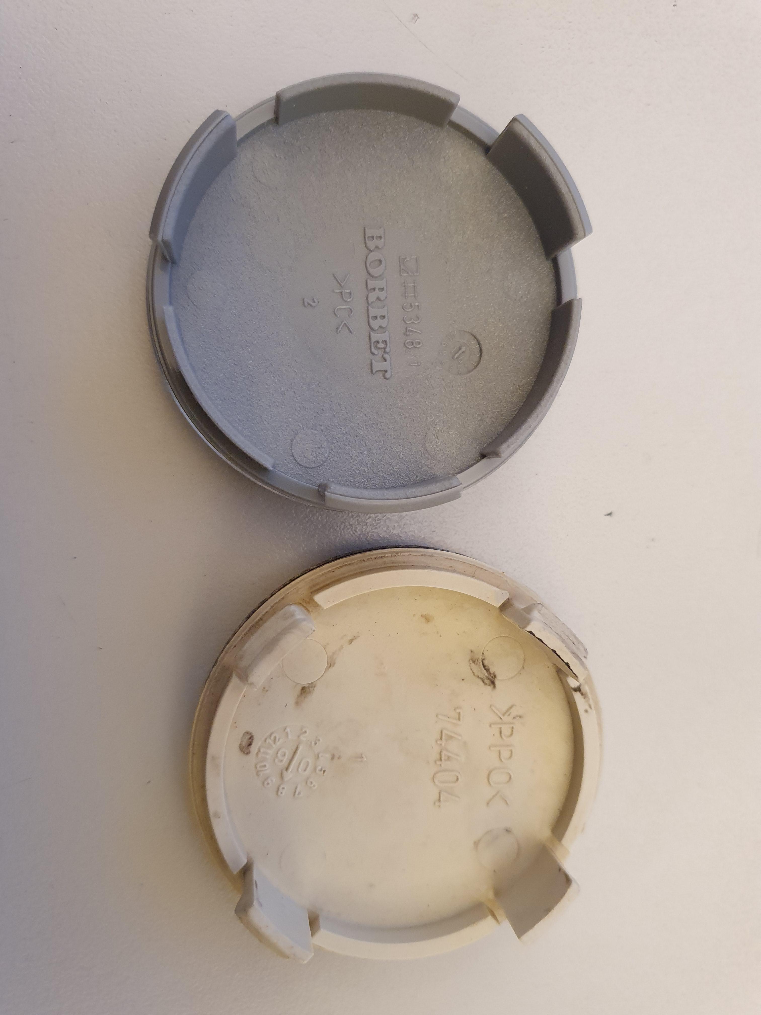

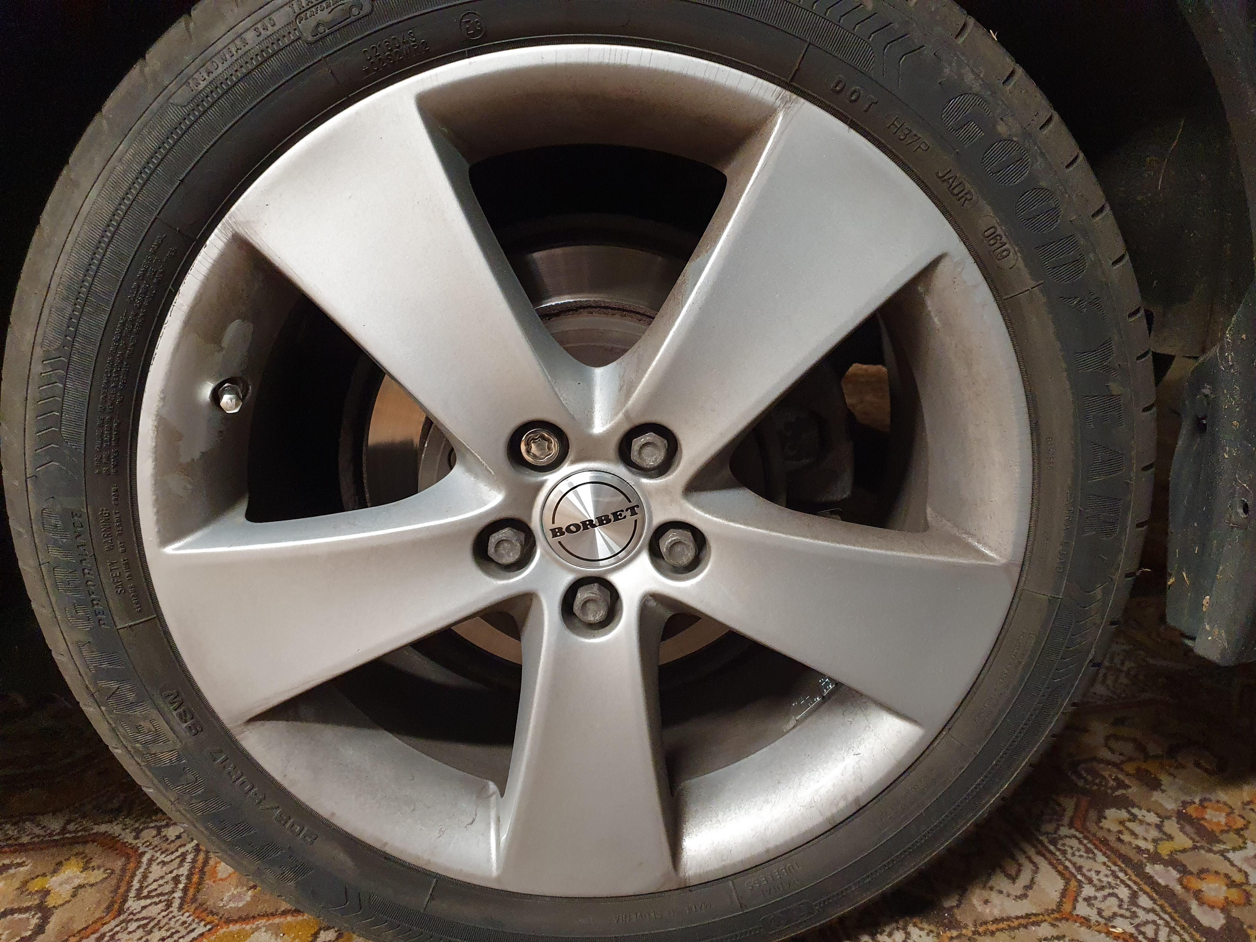

Jay762 Posted October 28, 2020 Author Report Share Posted October 28, 2020 Finally managed to source some replacement centre caps - both options from Subaru did not fit - Quite pleased at that as the one option were £22 each for a piece of plastic. The wheels are Borbet alloys supplied as dealer options so I pinged Borbet directly - German company and will only ship to a German address, fortunately I am working over there and had the opportunity to get them shipped to the hotel. €6 each so a lot less than Subaru options and a proper fit. Only compromise no Subaru logo but I can live with that Quote Link to comment Share on other sites More sharing options...
