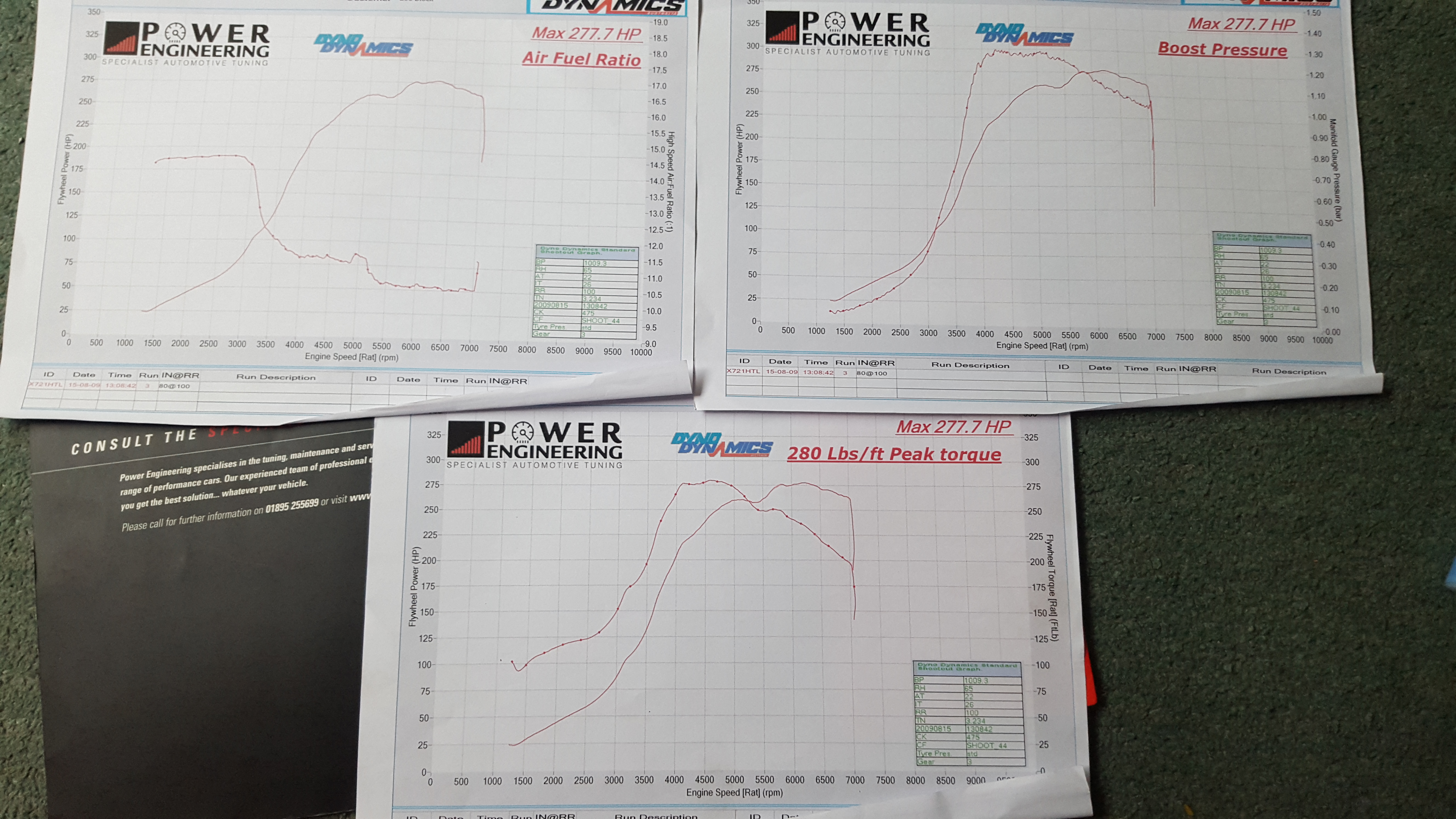

Here's the other printouts I have hope you can zoom in enough.. Idle issue has calmed down but still has the hesitancy when under load half and full throttle..

He had a quick look and said it looked a bit laggy and was quite rich.  However as the run was quite old now a lot couldve changed, vac leak etc etc.  His best suggestion to start with is get it on for a power run to see whats what with it now and go from there.  A power run is only around £65 so worth doing in the first instance.

As for the graphs ,when you said new tdo5 in your mod list is it a genuine one ?
It's just with yellow injectors I wouldn't expect a tdo5 16g to tail off at the top of the Rev range and hit 1 bar a bit sooner
