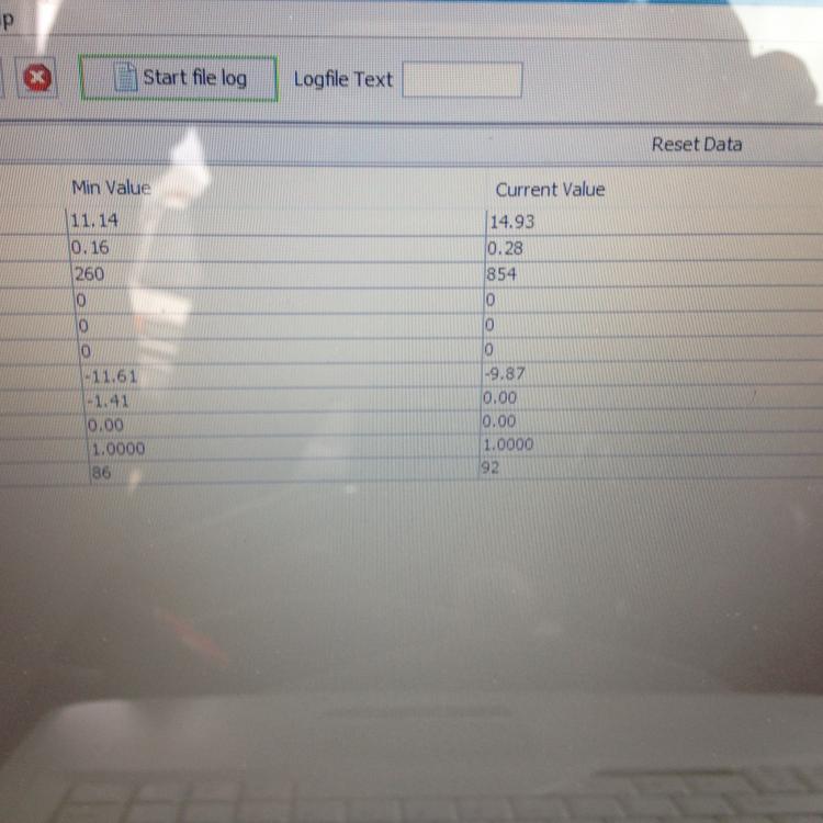

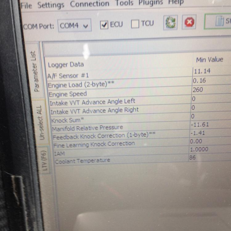

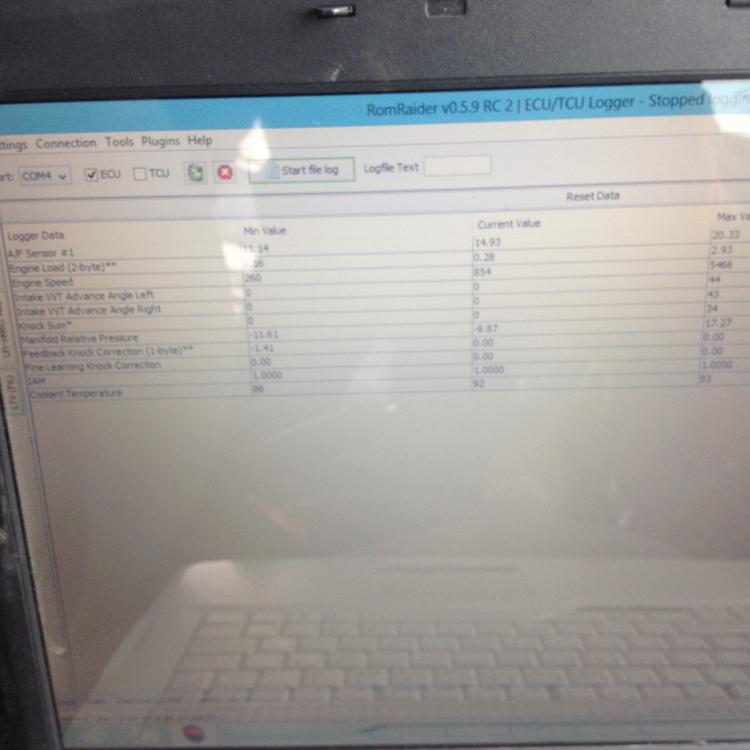

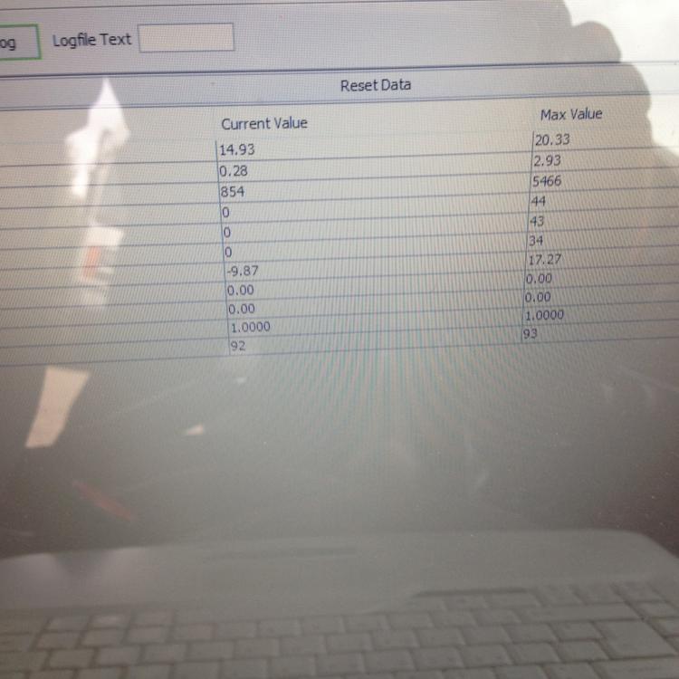

  • UPDATEEEE Got oil pump on 11mm one oil pressure now 1.2bar lowest at 100c oil temp. Hessantness has gone. Did find 1 small boost pipe half off have secured it. Timing was a nightmare to do in the

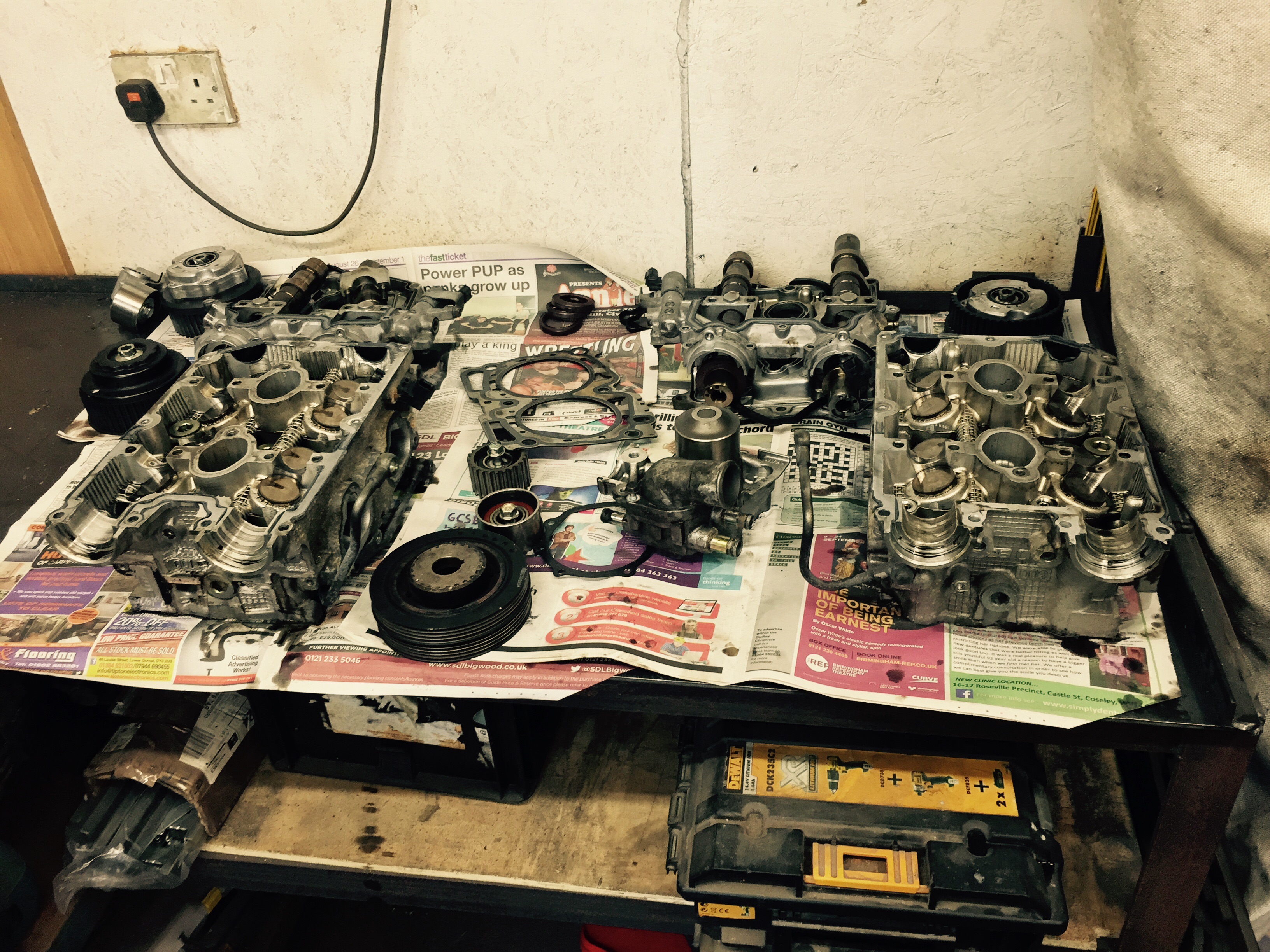

Was a private sale but totally trusted the car as is mint an all history ect. Which is why i went for a nice one not a thrashed one. Yes luckly my family are handy with the spanners so no labour costs. Got to take heads to see if there ok today after work. As the cams have started to eat at the metal. (Can see on pic) to see if i need new heads. May start a build thread but just want to boostttt [emoji22]

Welcome aboard mate, I feel your pain, what's this about the cams eating into the heads ? Has it been run low on oil do you think ? I think tidgy is right, if your thinking of keeping this once fixed it really needs a full strip and check, also, how did you remove the avcs pulleys from the cams ?

Have seen those heads will see what head place says today and maybe offer him 300 for both. Got pullys off using the bolt extractor method as it goes on outside of the bolts not !Removed! hex inside (gives more leverage) air gun would not touch them big bar and the handle off trolly jack. Whats this about the crank bearings then? Thats a engine split job? I believe the chap had the car serviced regular but who knows. Would like to track problem down as water pump and no split pipes

Heads are scrap anyone know to a set of 2.5 ej25 heads?????

are the castings ok? can they be machined?
Bin told that can not machine them as its a high performance head. Has took good chuncks out of cam lobes. So if take metal away ie clean them up. be no oil pressure around the cam as tolerance will be to big
You can do 2 things with score marks in cap & head bearing wells.
1. if not deep can be polished out .
2. if deep, head cap face is machined down a fraction making hole fraction smaller & then it line bored & polished .
Lot of machine-shops will say can't be done but it because they can't do it, not got the kit or experience.
You need a proper machine-shop do this work and fussy one too (not many PROPER ones about)
If cams scored get new .
Have done this on couple builds we done & finish & spec spot on but does need expert & fussy machinist for proper worthy end result .
Cam journal load is minimal compared to say crank so it easier rework & tolerances although important have more scope .
With cams like that I think you will need crank bearings for sure, we can normally judge by pre strip oil pressure, stethoscope check, oil condition, head gasket leak internal/external & condition of bores/head & cam journals how good bottom end going be ...
