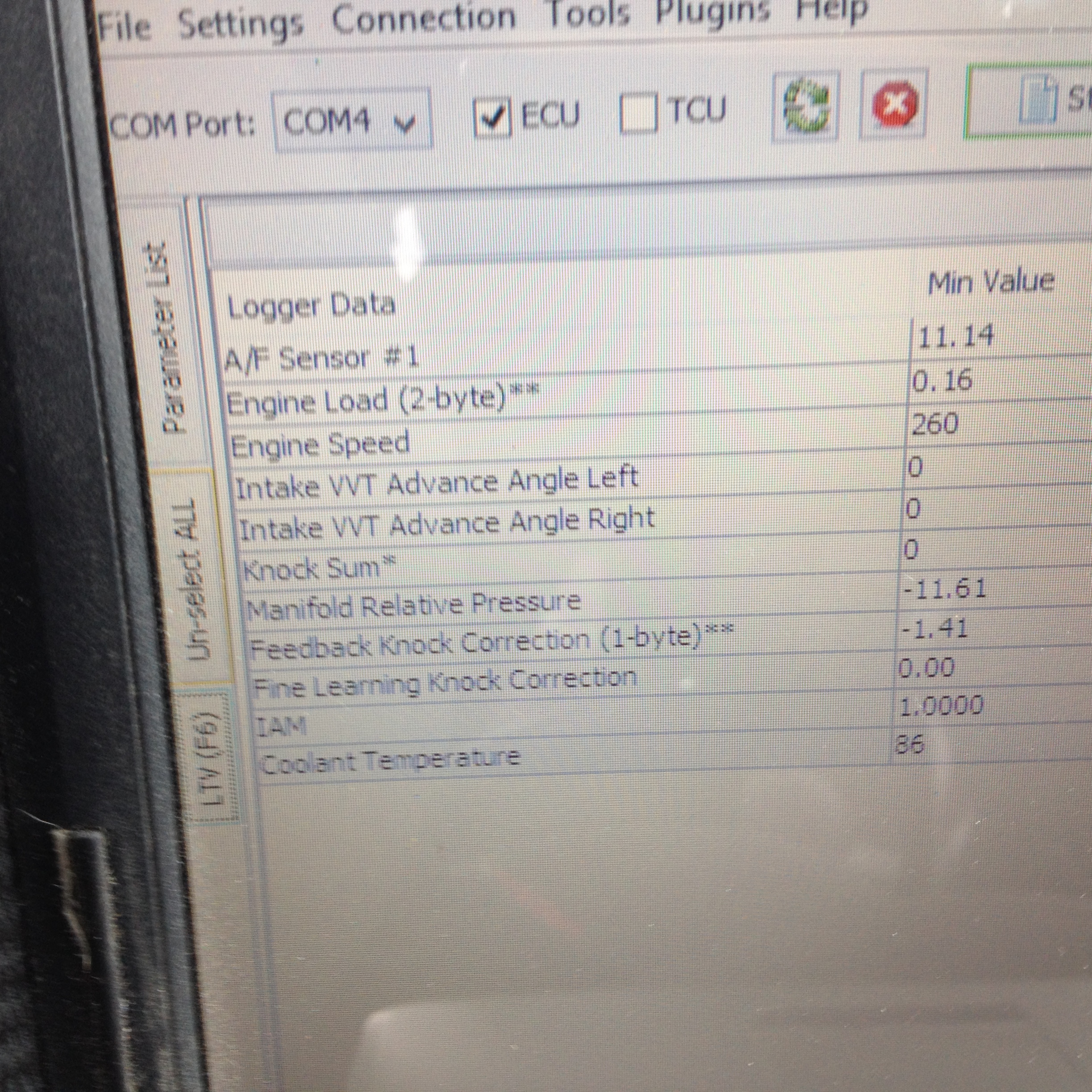

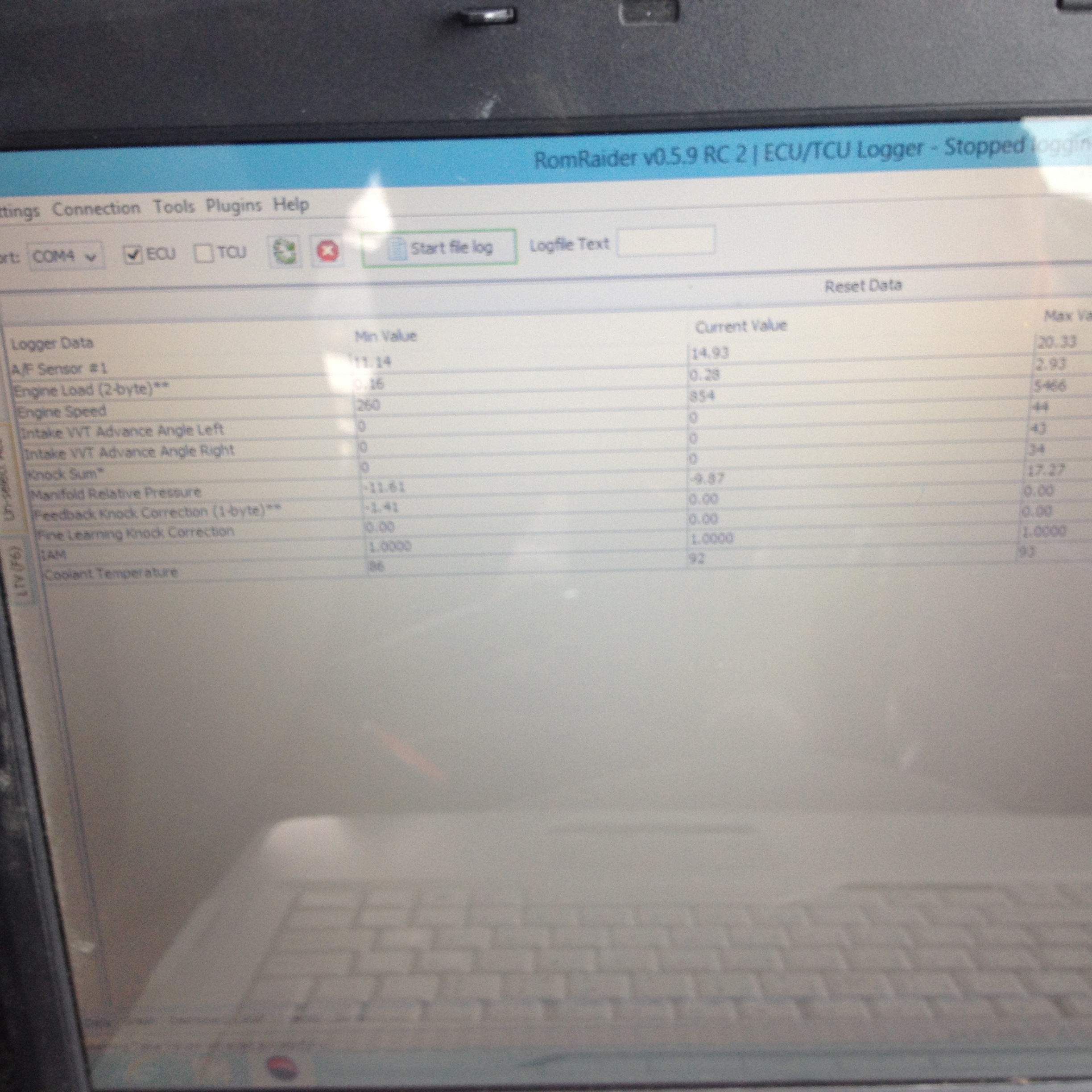

Romraider is fine mate, I use it for logging mostly, but you can also add revs and take away timing with it ect, I've not got it set up to flash the ecu or anything like that, that's a whole different thing
For logging you just need a vag com cable and the software from the romraider site and you can plug in your lappy and see exactly what the engines doing, you really will wonder how you got along without it

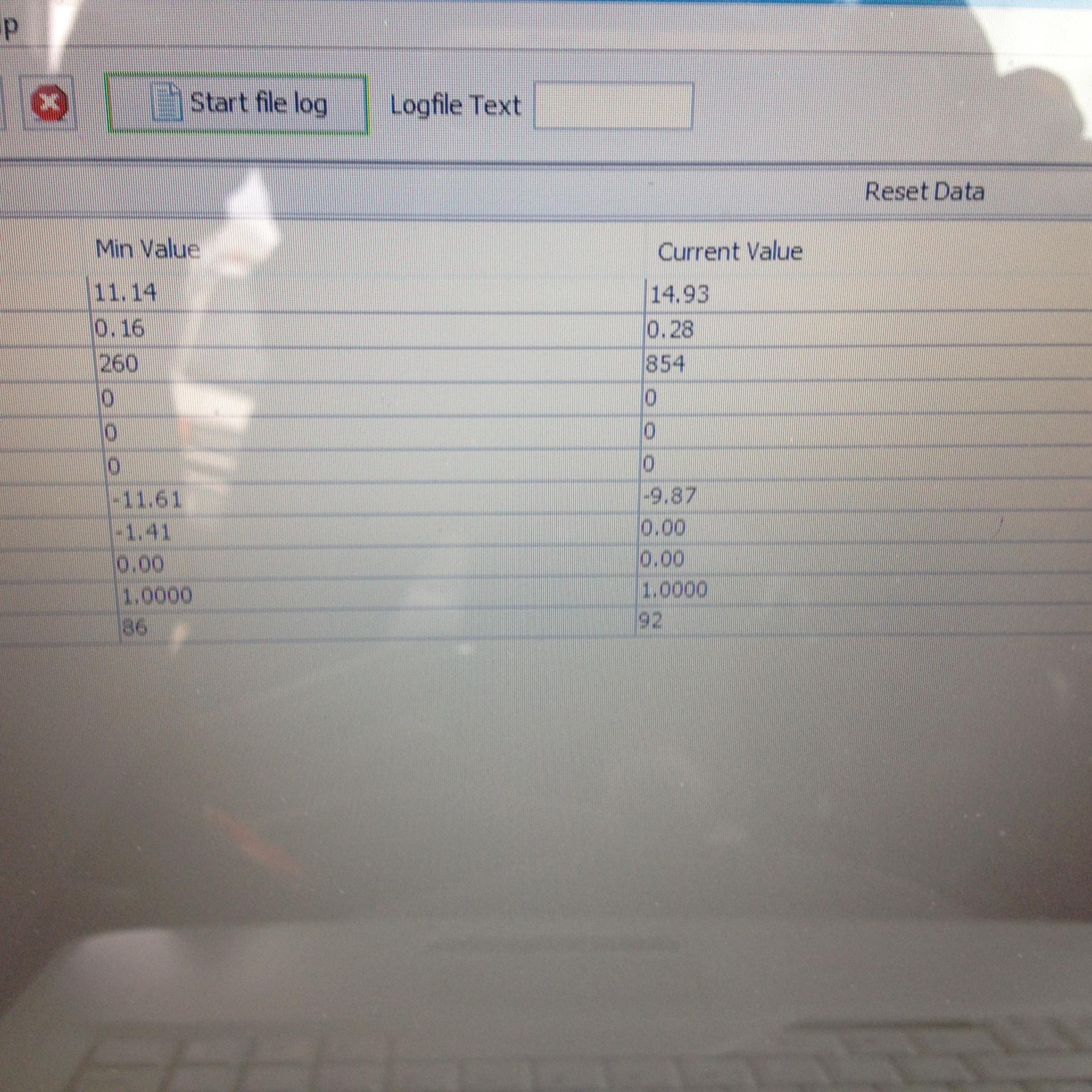

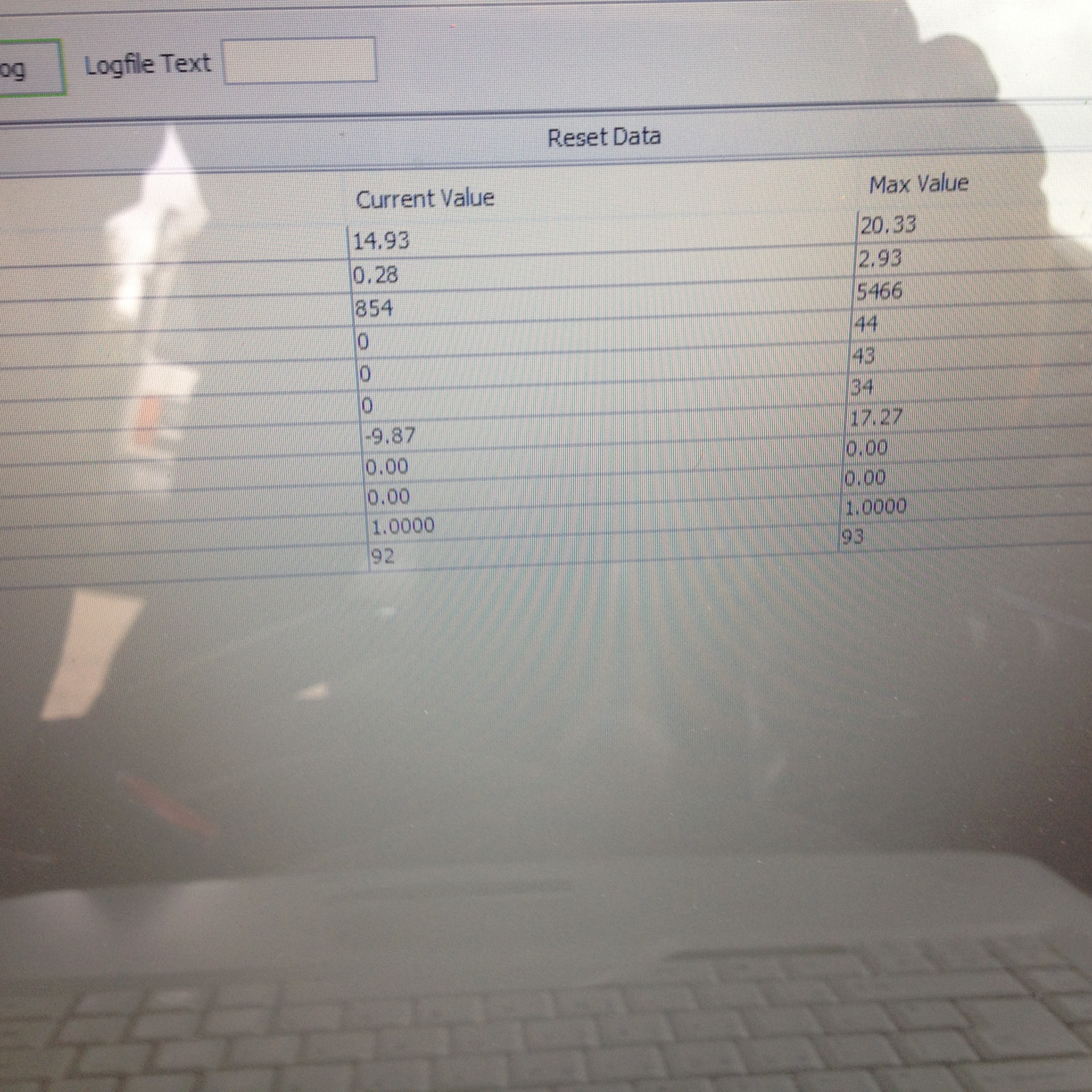

Did download it have got a lead aswell was asking me for a file for the car. Will have another bash later. Just got breakfast in car. Oil temp 70c oil pressure lowest at idle 1bar-1.2bar around 5-6 driving at low revs. Are scoobys jerky/hessant when cold ? Seems better after the blast last nite
Mines a hawk too and it's mildly jerky when cold (before and after mapping)so I just keep it out of boost for a few minutes, that's mostly if I just start it and drive pretty much straight off, not so bad if warmed up a bit before drive, sounds like you need to load ecu defs into the logger, I'm shi te with computing but I managed it after much reading 🙂👍
