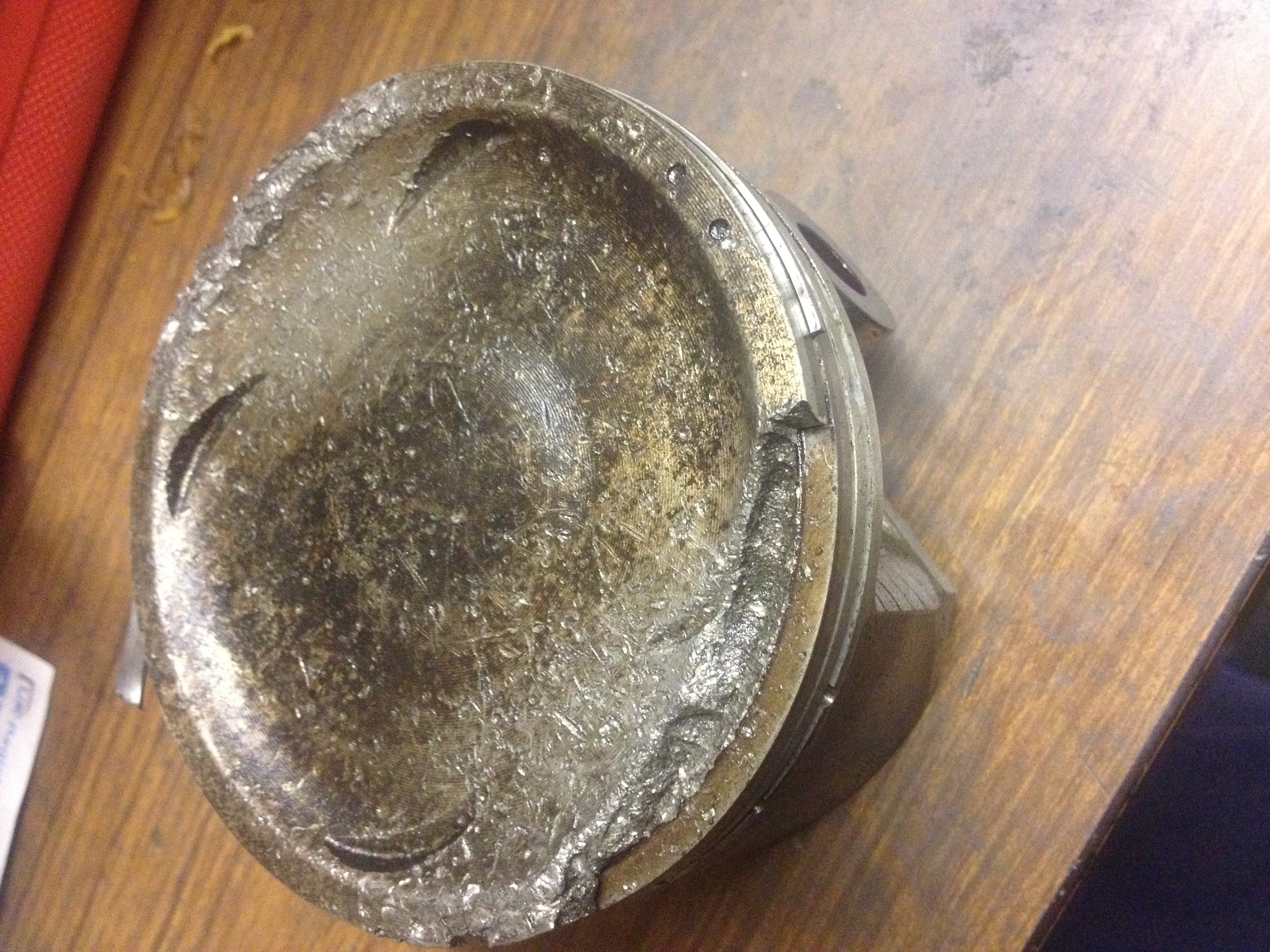

100% with you on that one mate, this is what I pulled outta my 2.5, didn't do the head many favours that's for sure !!
that looks more like it detted its **** off rather than ring land failure
Yeah think that was prolly the case tbh 😜
Wonder why it was just that particular one , cylinder 2
Seems ok now according to Duncan lol lol
most of those marks will be impact damage from debris as piston cycling, can ruin a good head too ...
Set of forged good way go & not overly costly, standards if A1 & bore A1 can be fine for budget standard build (only saving potentially£350) but good RR check & breather improvement would be a must . Lean running heat & det soon kills 1st cast piston ringland .
