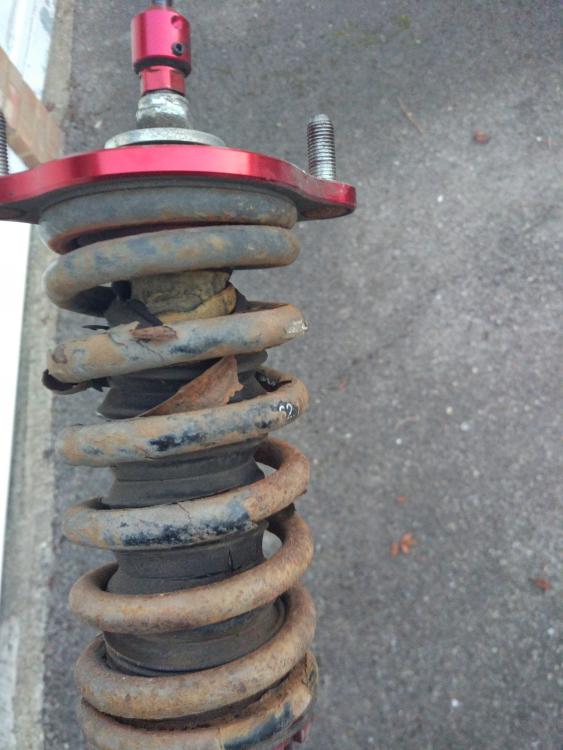

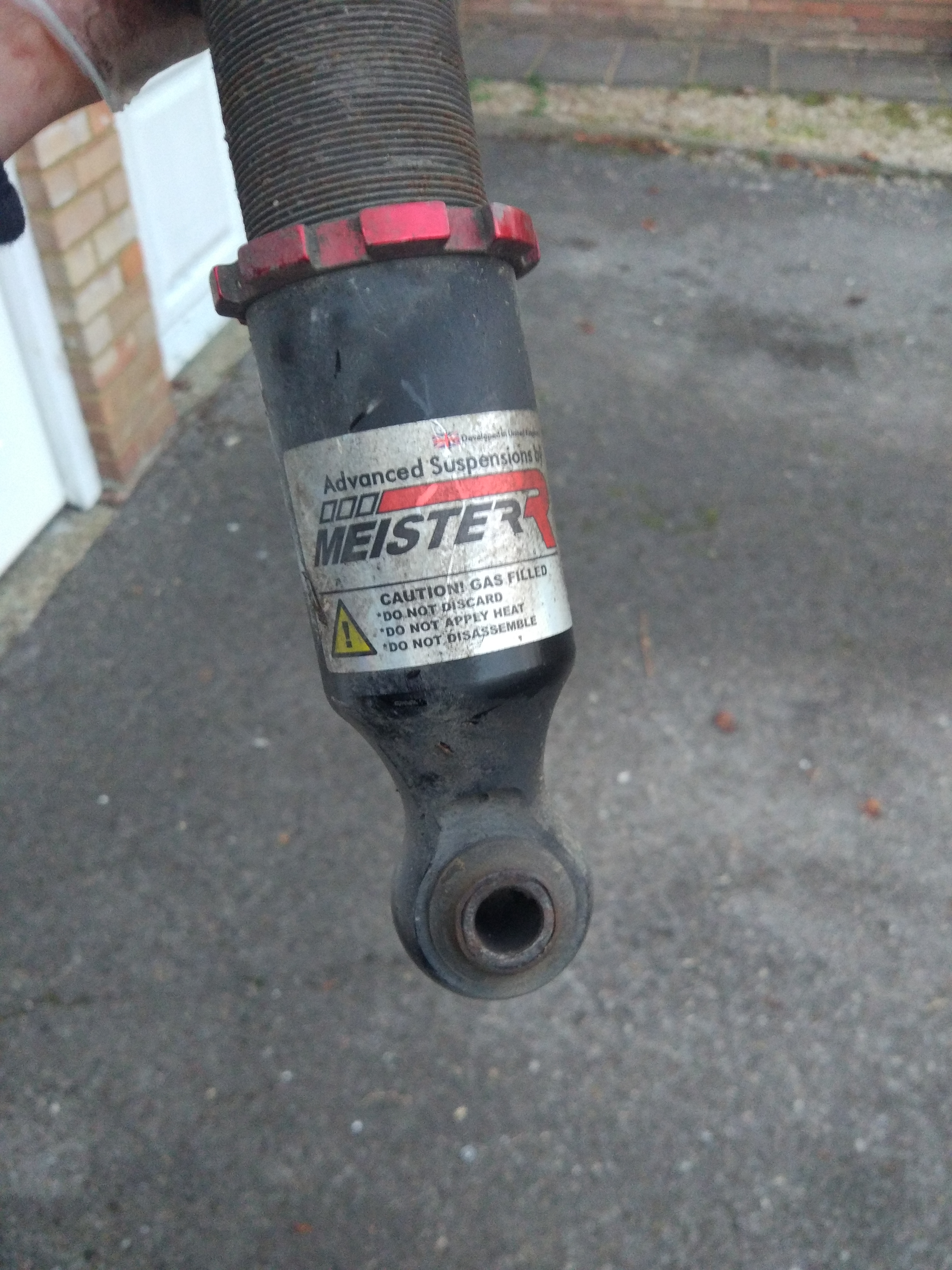

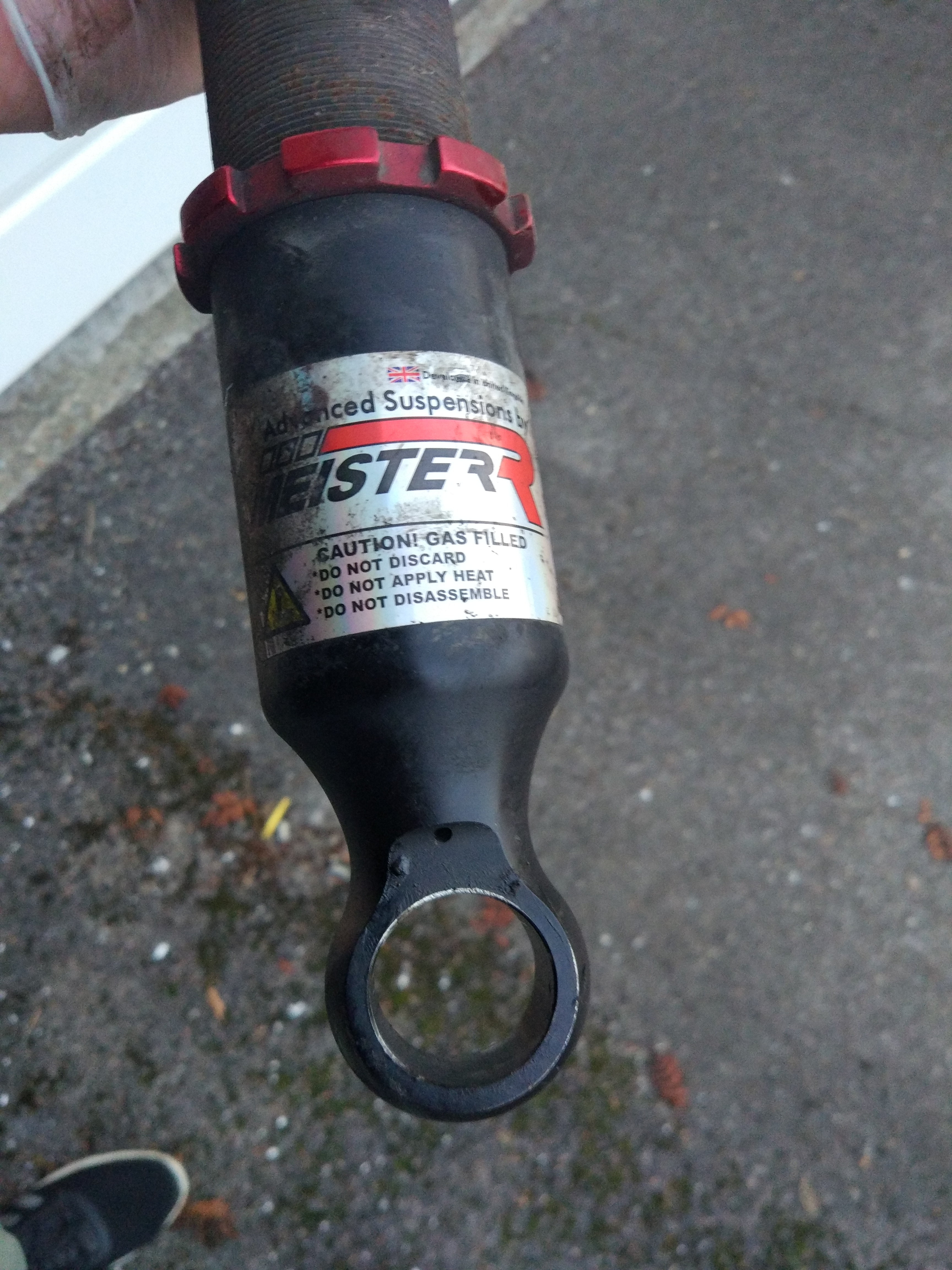

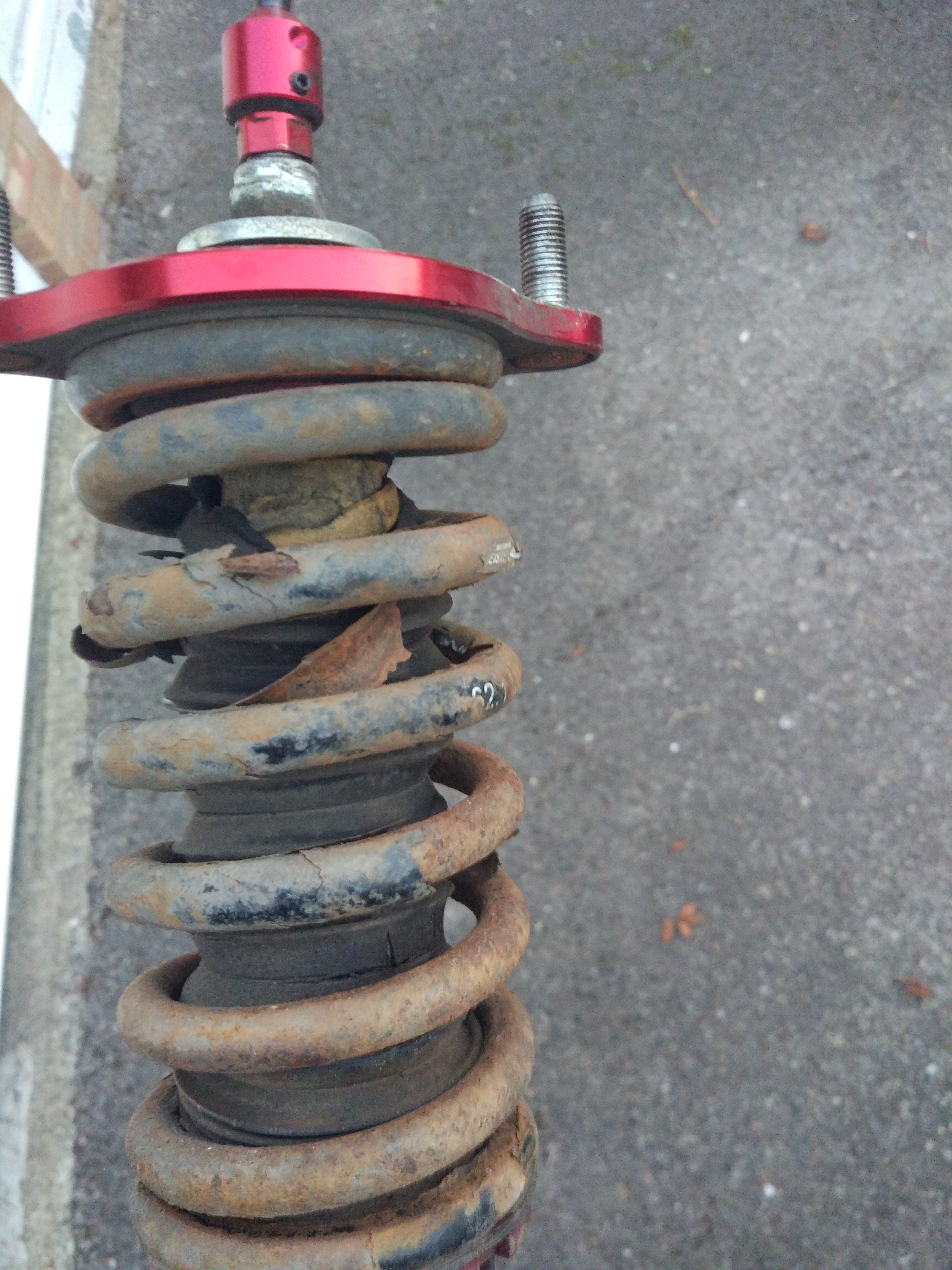

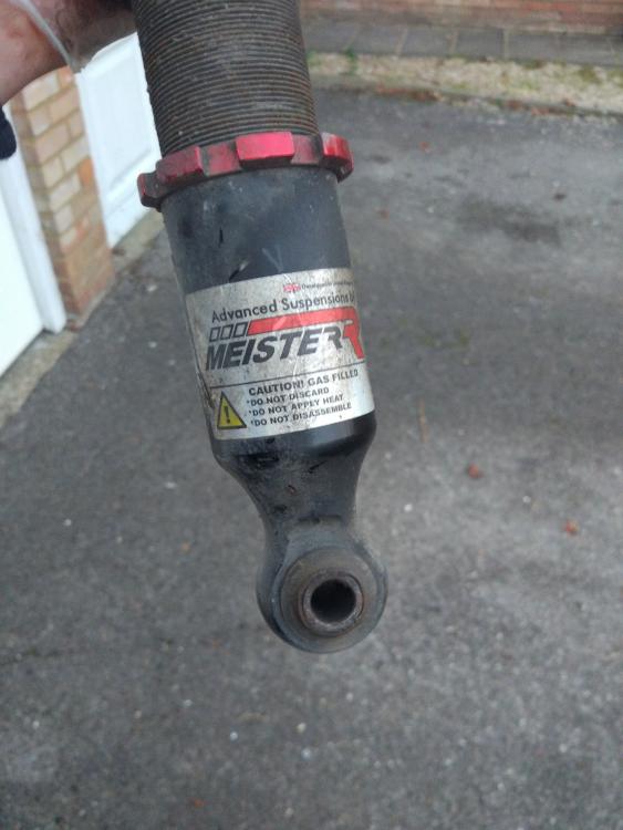

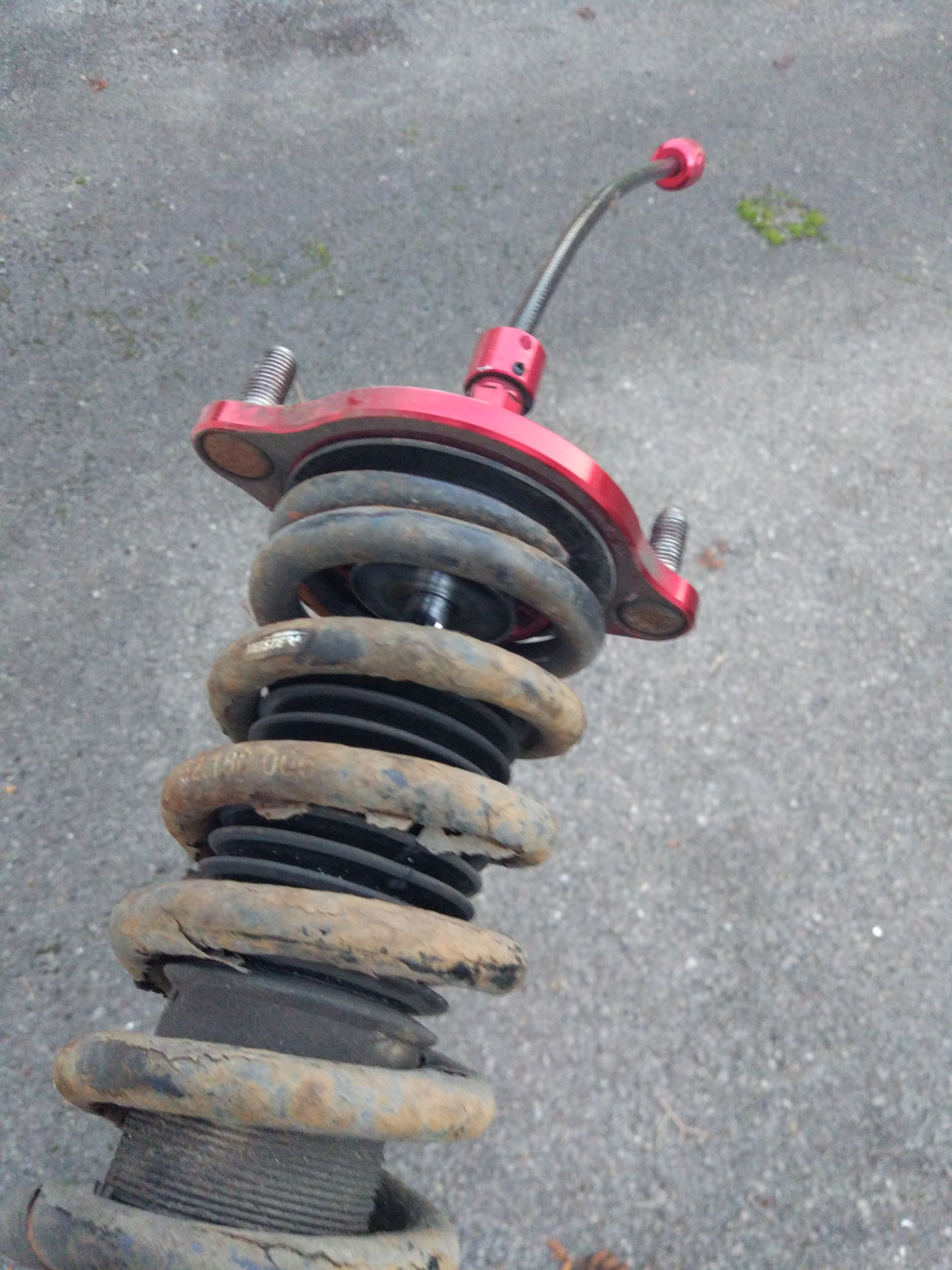

Circa 4 years.  Inner rubber which I assume is a bump stop has broken up on one for sure.  Springs are OK.
I'm waiting on a reply from Meister but looks like new one. I'm not using them so don't care too much. Was just thinking about getting a few £ for them.
Yeah that's him mate, he said new damper was £125 but I'd guess you'd want a new matching pair really. So worse case is someone has to spend £250.  If so I don't think I can ask more than £200 for the set as they are (cleaned up obviously)?

They not very good, all taiwan ones much same . BC potentially better on price and parts/rebuild but none are proper good on b road use, main reason bumps and bushes gone is rod stroke too short and bottom out all time .
easy enough get new bumps and expect could find or make polly bushes for eyelet, springs could do with blasting and epoxy  powder coating.
someone probably buy them .
