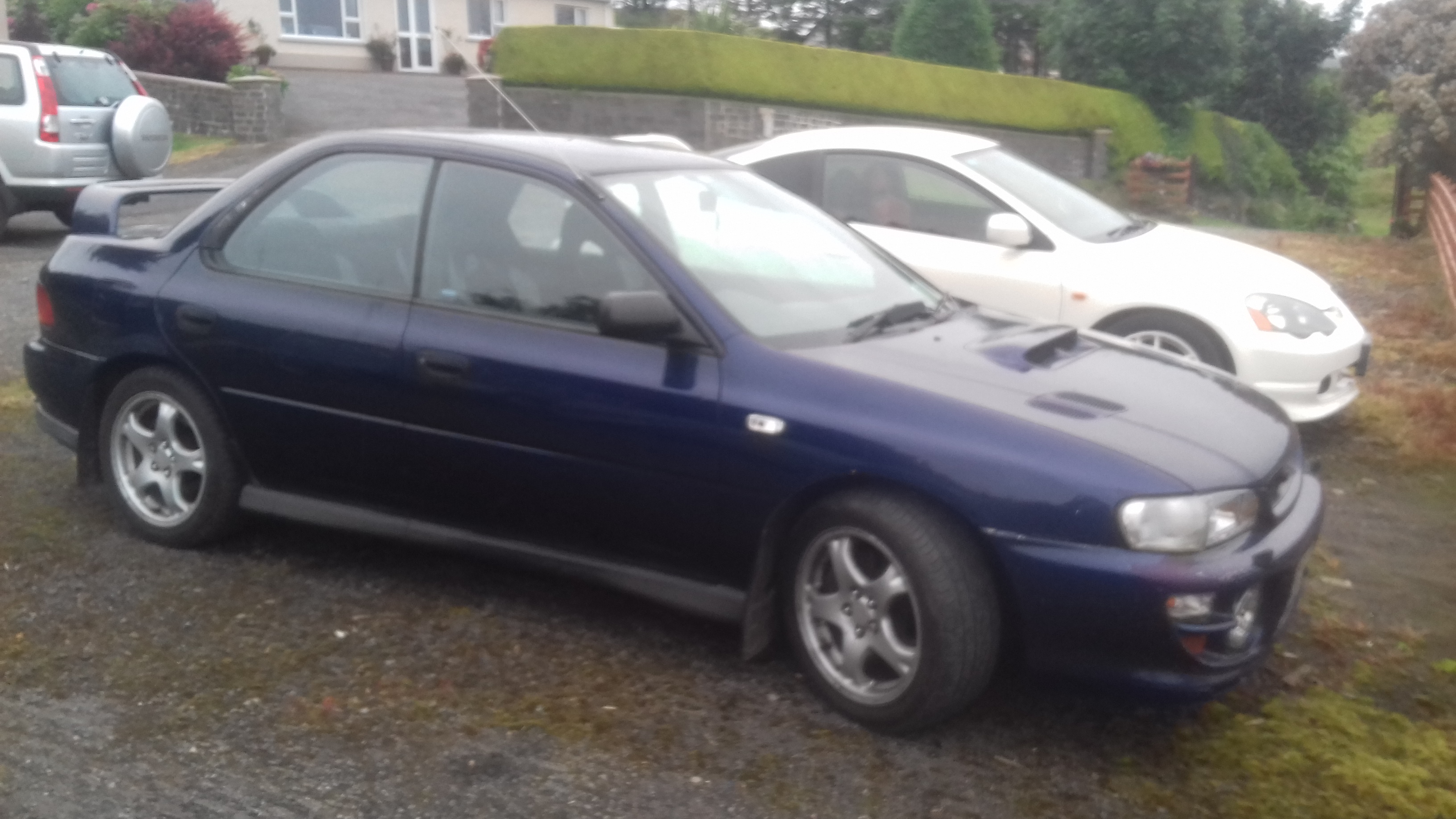

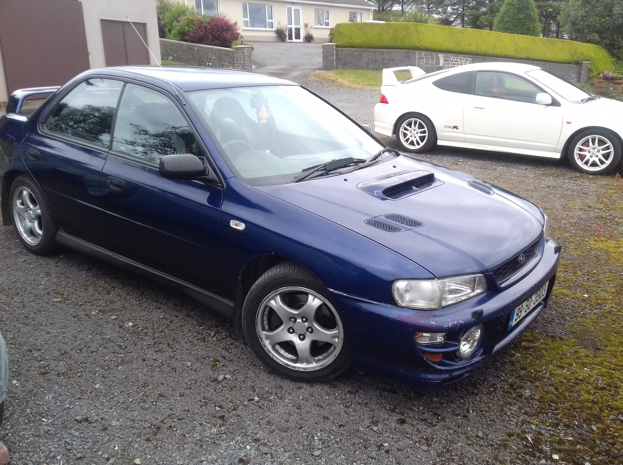

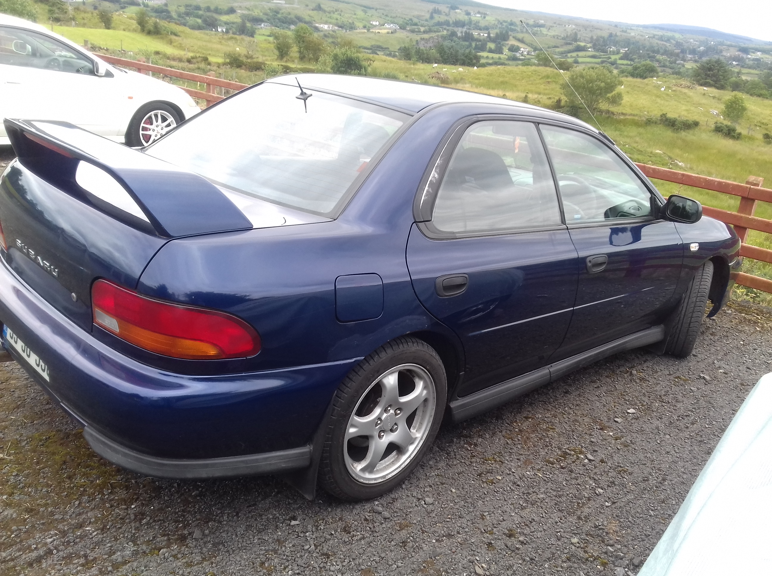

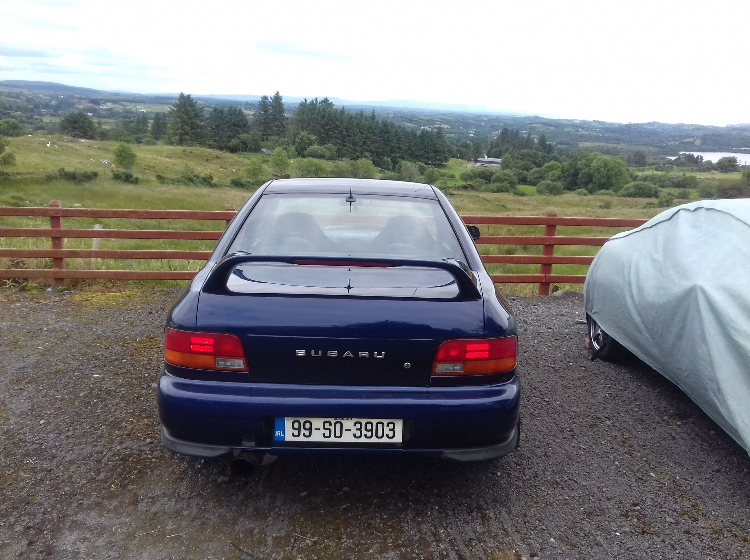

@savage bulldogs @stants thanks lads. This sounds like it could turn out much more expensive than I had initially thought. Here's some pics of the car anyway. Your thoughts on the colour?
Looks like a clean unabused example [emoji41]
Didn't want to scare you off with robs £8k price tag, as you could probably get it done for less than a 1/4 of that price [emoji6]
Pending how bad the inner arches are, whether you get the whole car sprayed or just the rear 1/4's and who you use to get the work done .
Yeah I decided to go for this one (knowing about the rot) as the previous owner had it for 12 years. Totally standard car apart from the back box. The car is getting treated to a full respray as the paintwork is worse than the pictures show.
