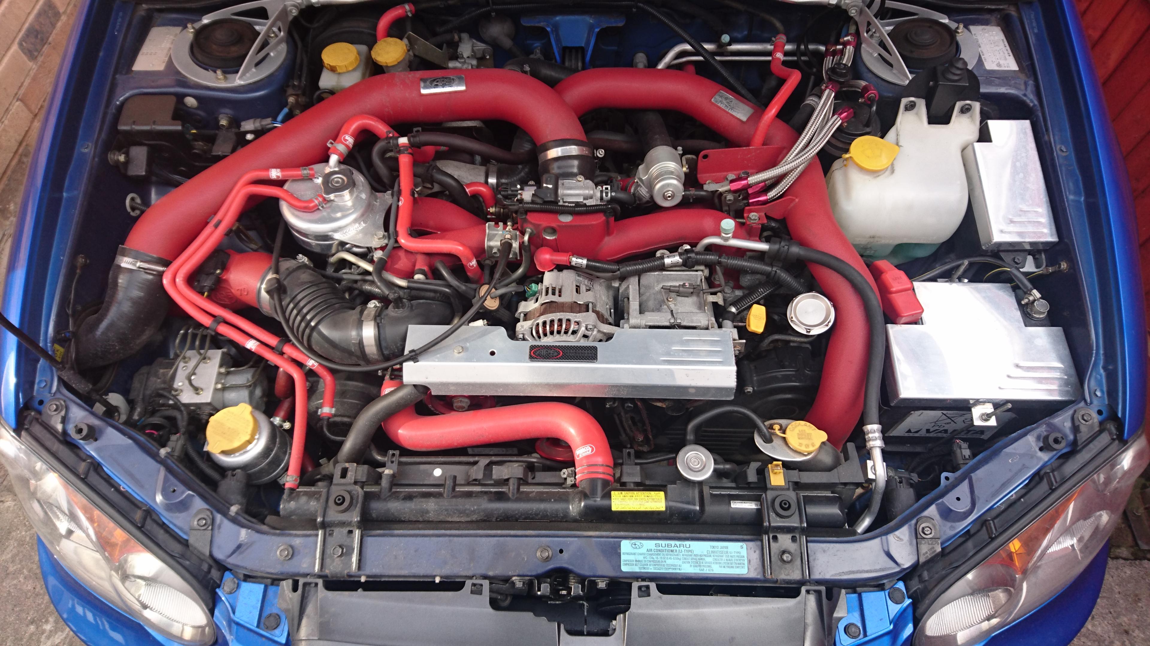

So the problem. From cold start, she runs fine and dandy. When warmed up and i stop somewhere, restart and the revs fluctuate and then finally it stalls. Leave it 10 mins and she starts fine and you can drive away. Seems to be worse in this warmer weather. I've replaced the MAF and tried unplugging the lambda sensor when warm to no avail. Had it on 2 diagnostic machines both of which pulled up no codes. Even cleaned all plugs and sockets in engine bay and visually checked pretty much every wire.
So here i am hoping and wishing that someone may have some ideas. Pretty calm when it cars but this one is really testing me wall.gif  Which is a shame as it's a great car otherwise. It's no doubt a small niggly thing which makes it worse.
