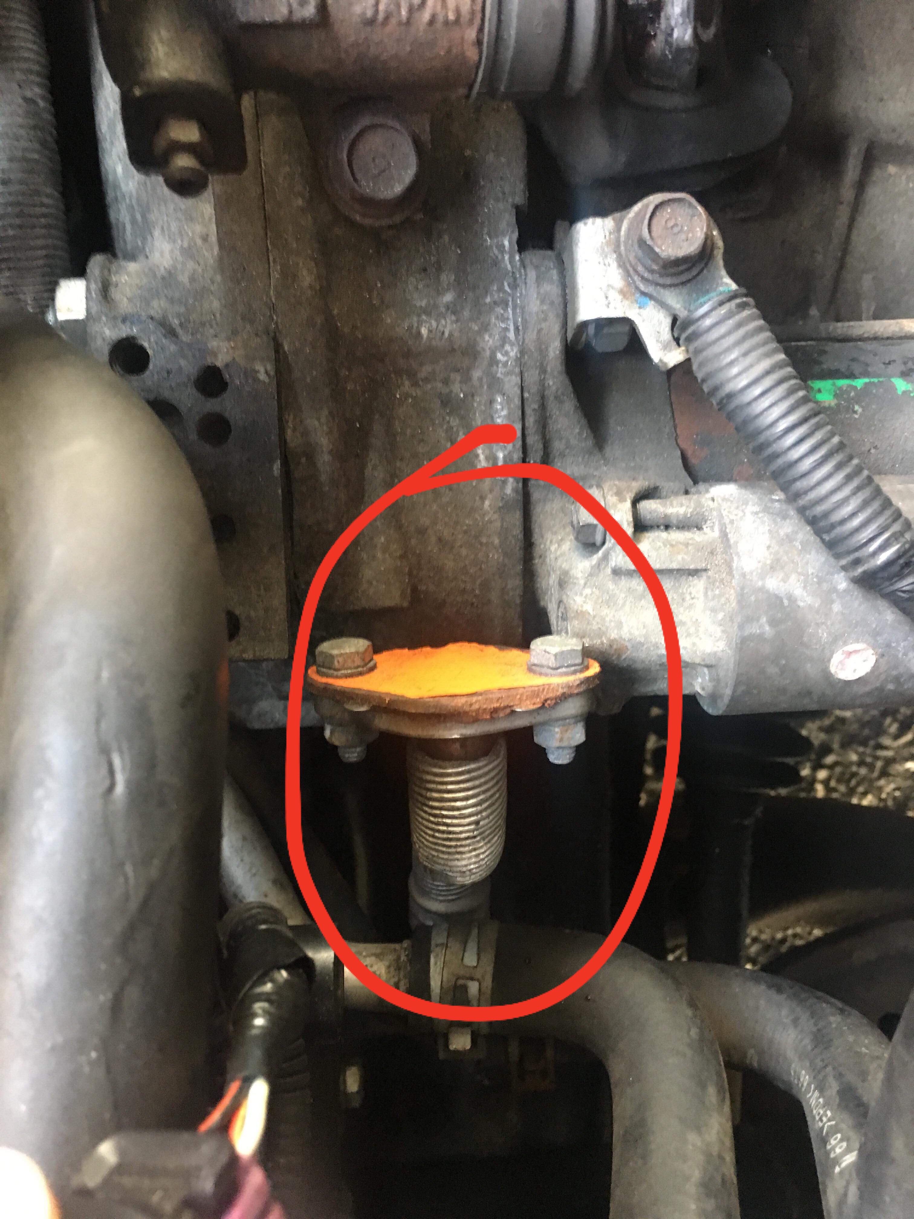

14 hours ago, Dovo1 said:
I've bought a Subaru Impreza wrx 2007 and I took the intercooler off to clean it and found a pipe that has been blanked off can anyone tell me what it's for??
Where abouts in the engine is this blanked off? Is it to the right (passenger side) of the engine/alternator?
It's used for about 30 second during cold start to do with emission. full description here,
http://www.subaru4you.co.uk/how/how6.shtml
It's pretty crap as it gets water in it which causes rust and such making the system fail. At that point most folks remove it, but it has to be done correctly so the butterfly's in valves are removed so they don't fail in the wrong position or you risk cocking up your afr's down the line. So it's ot as simple as just mapping it out.

Thank you everyone for the quick replys I've had a slight power loss problem and was wondering if this might have been the fault would it be worth connecting it back up or just leave it the car hasn't had a map as far as im aware and it's on the passenger side next to the Sartrer motor if that helps

Secondary air system,
AirPumpAssembly.jpg?format=1500w
Not sure why they just didnt remove the whole system and blank t at the block, which is the normal way to do it.
I thought it looked like where the secondary air pump went. That is why I asked which side it was on. Usually its either left in place with no power going to it or removed as you said and blanked off at the back.
If it is blanked off correctly it shouldn't be the cause of any power loss. When does the power loss happen?
