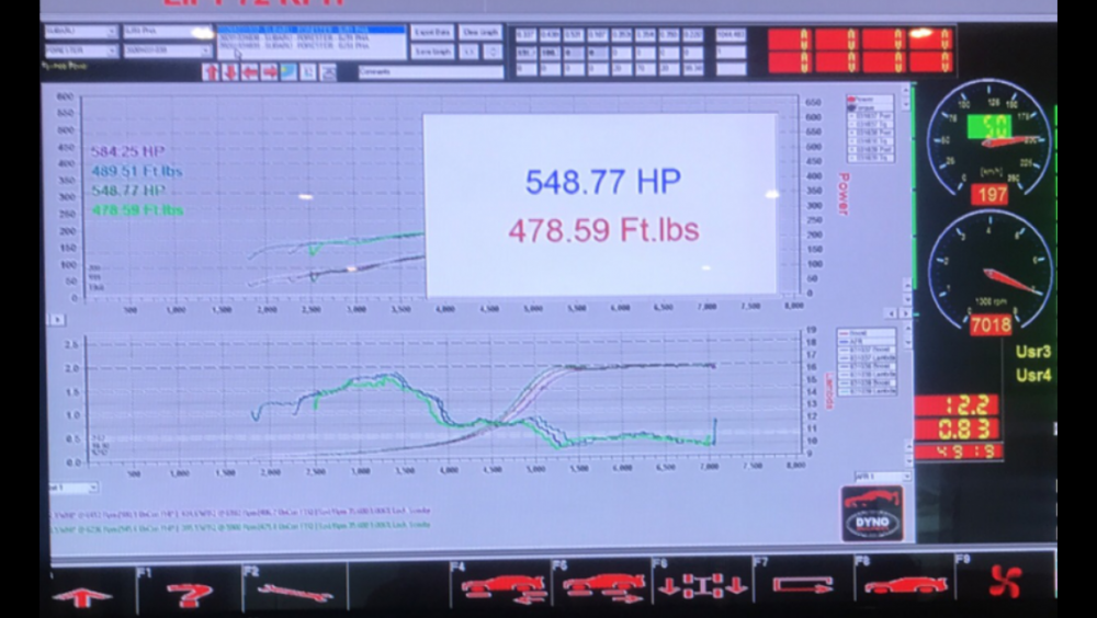

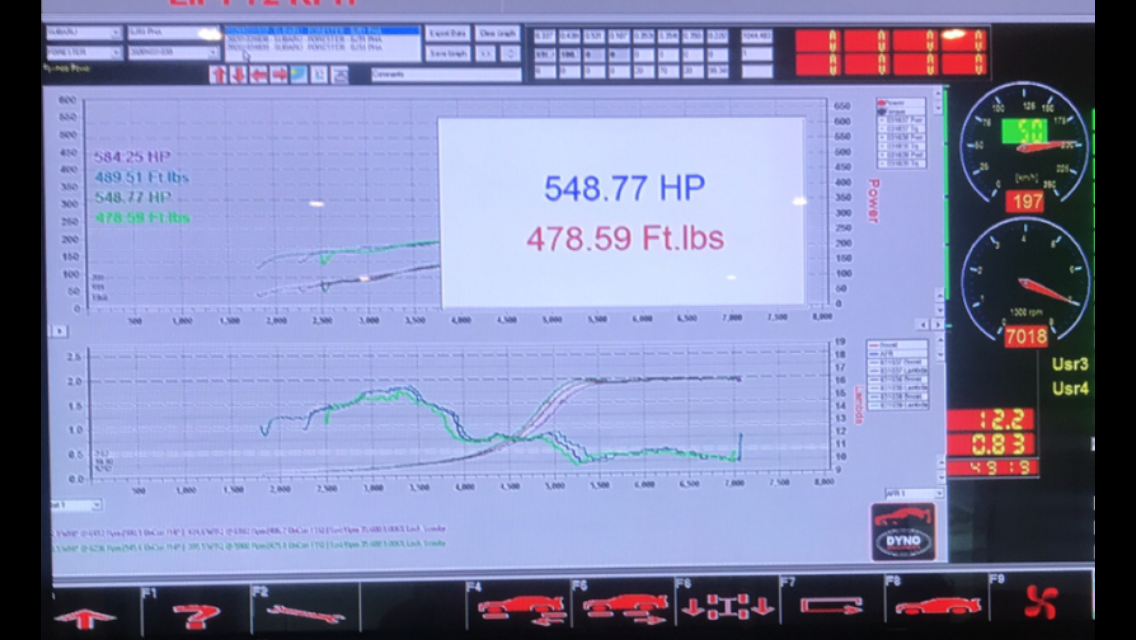

Just got mine to 548hp on vpower.
What's the highest out there in the U.K ?,anyone know?
Oh yes.  It even surprises me.
It frighteningly hit 615hp at 2.2bar,🔥. to much. Happy at 548.
But I would really like to know what else is out there ??

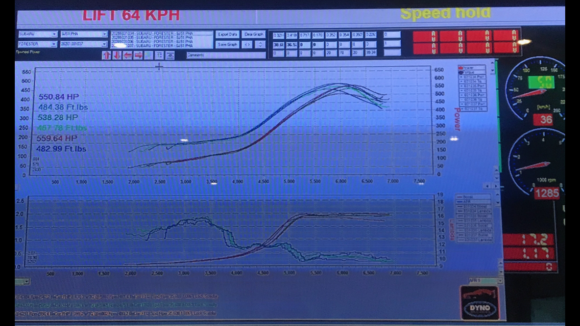

What do ya think of the curve it makes ?

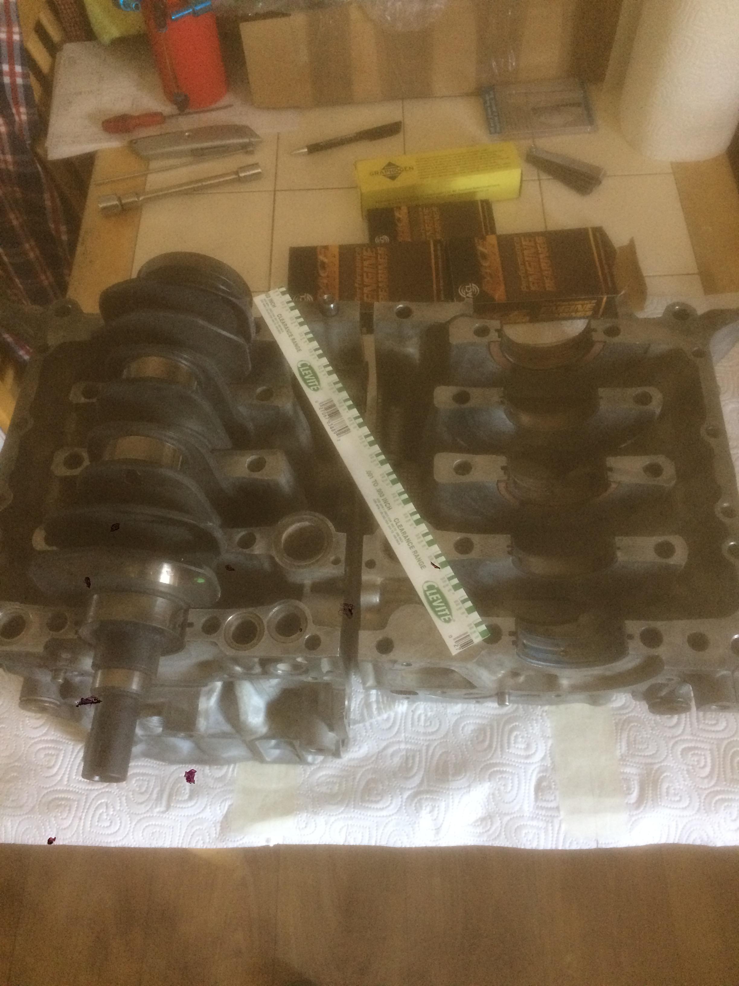

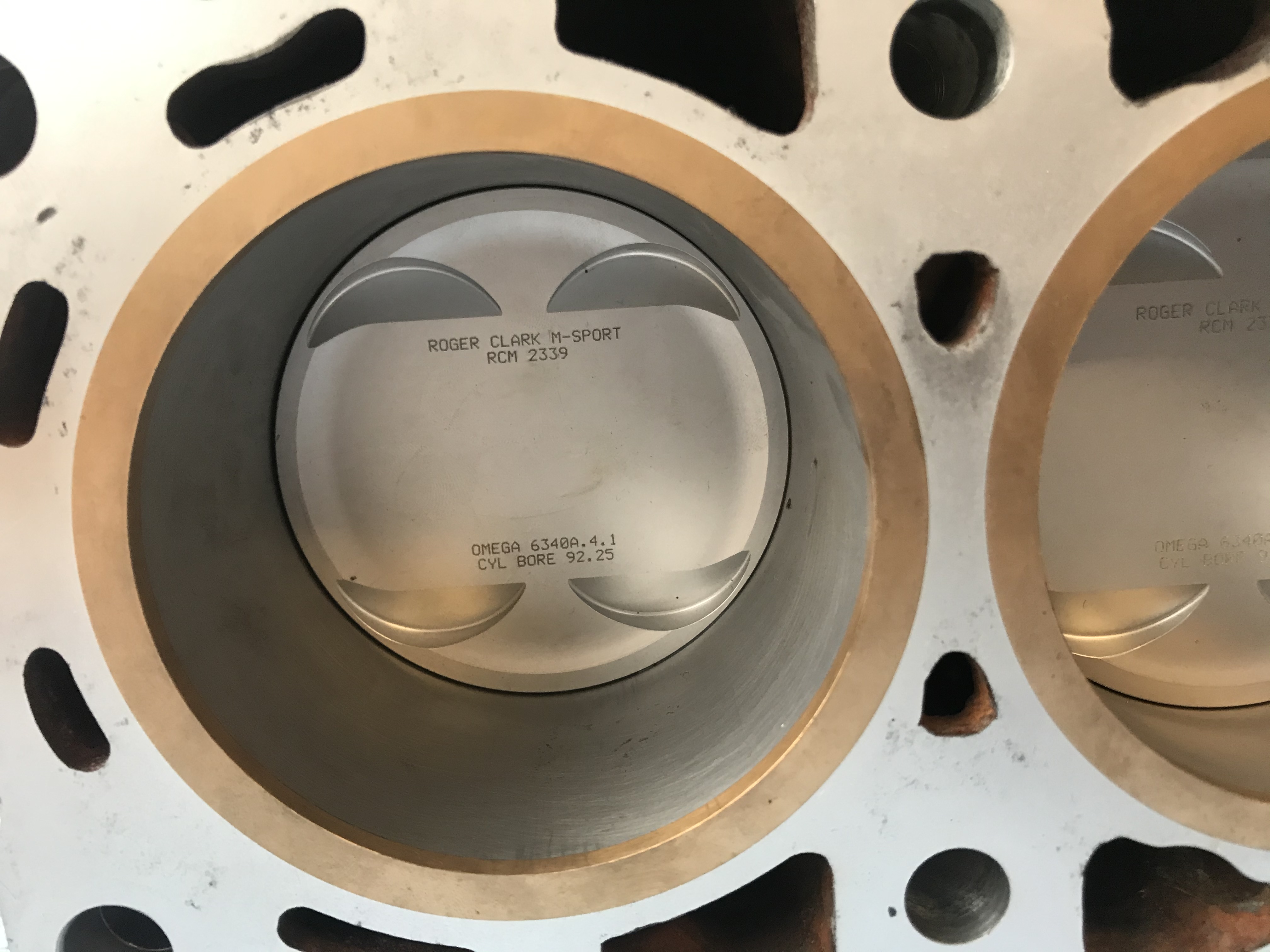

Yeah.  I did not manage to snap a picture of the 615 run though. But this is a better view of the top half without the white info window in the way...

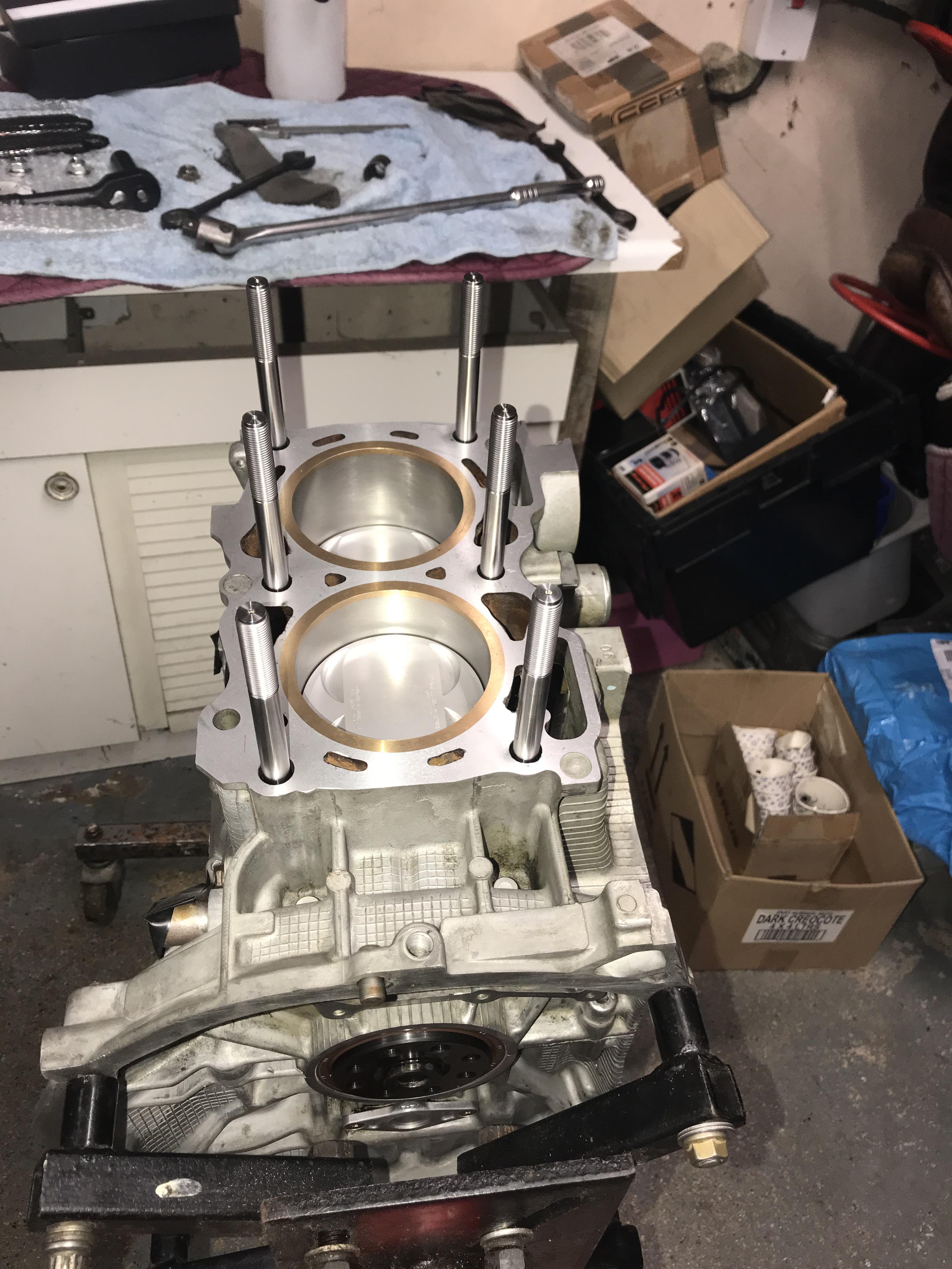

It a cdb 2.1 stroker bc272's with a GTX3076R gen2.
Yeah. Not finished yet though. Ran out of dyno time.
Its going back for its final 'fine tuning' soon.
