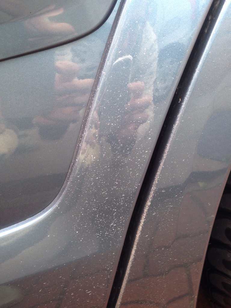

Currently waxing after washing the old girl....anyone tell me how to cure this?
I'm guessing it's some kind of oxidation and waxing hides it to a degree. I just want it corrected full stop, if anyone knows how to?
Megs ultimate compound has worked on previous cars, but tried it when I got her and didn't make much difference.

Not to easy to see what that is from the photo, you could try a coloured tcut these tend to hide it a bit. Other than that of its just in the lacquer coat than a polishing compound should clear it, just don't go mad and take the lacquer cost off

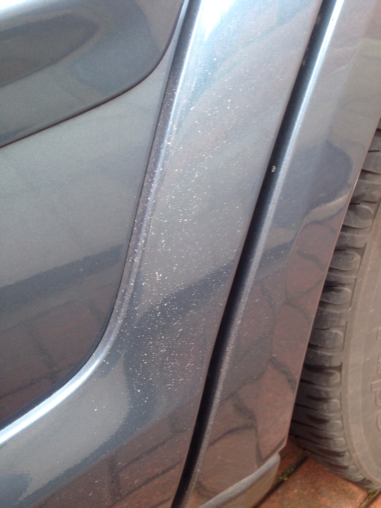

Left side is pre wax; right side with wax applied
Looks like it's just lacquer coat. Good scrub clean and dry, use a fairly coarse polishing paste, and then a finer compound. A think wax like a carnauba and if you want to finish off a lighter wax to put the shine on. That's what I'd try first. Just don't go crackers with the coarse paste.
Dave, that`s on mine as well, and possibly was on my others. It appears to be from not having mudflaps fitted, the spray from the rear wheels has pitted the paintwork, You`ll have to get the mop out to deal with it. I`ve the exact same and I borrowed my mates mop for when my 3 months recoup is over :D

Thanks both....will try to correct it in the spring, pre-NBO [emoji6]
