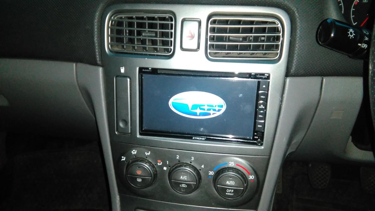

Firstly I have fitted a double din stereo and sat nav unit, as I always get hopelessly lost.

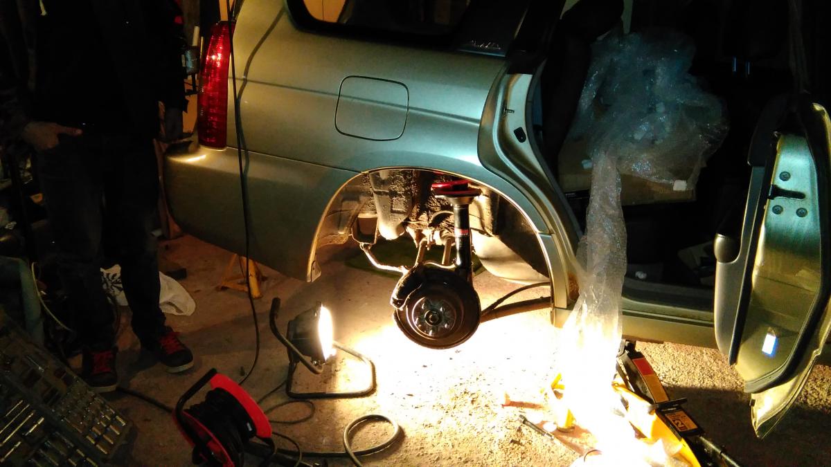

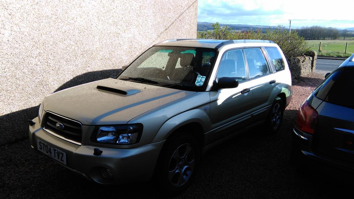

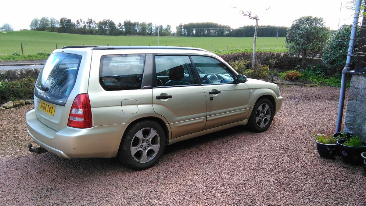

Then off with the old springs and on with a set of Pedders "Lowering springs" I say lowering as we descovered that the front had a snapped spring on one side and the rear SLS had failed on one side, so the car only sits very slightly lower than before. However ride comfort and control have been greatly increased.
Before

After

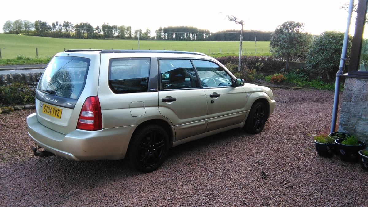

And Finaly, today these arrived from Saj/Jas at Jap Performance Parts so I can take the winter Studded tyres off!
post-4236-0-26032200-1432068222_thumb.jp
Fitted
post-4236-0-40471200-1432068243_thumb.jp

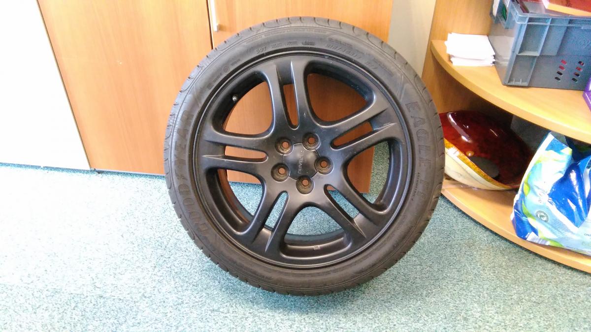

Did you have to fit spacers with those alloys?
No Spacers installed, the offset on the original wheels was +45 the offset on these alloys was +55, so a 10mm movement inwards, I had a good check and everything seems to clear on full lock both directions, I might get a 5mm spacer just to be sure, but dont want to mess up the wheel bearings or cause undue stress anywhere.
http://www.subaruforester.org/vbulletin/f72/subaru-oem-wheels-fit-forester-19106/
The link above seems to show some +55s working without issues.
Going to get everything aligned tomorrow to make sure I've not made a total pig out of it :D
Only thing you'll have to watch out for is the rear struts rubbing on the tyre with a load in the back

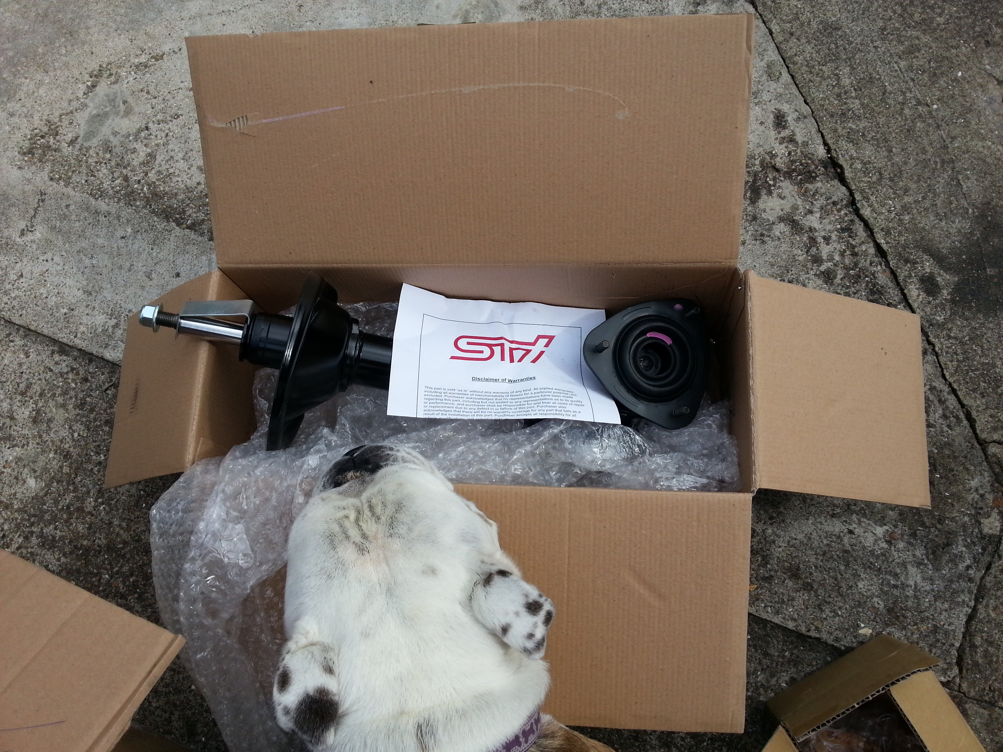

Ordered my new rear shocks and group n top mounts yesterday morning and they arrived today , gotta love importcarparts for oe stuff [emoji106]
Apparently sti make their mounts with the same rubber as bulldog toys .
As liz wouldn't leave em alone so I've gotta keep a eye on her when I fitt them tomorrow [emoji5]

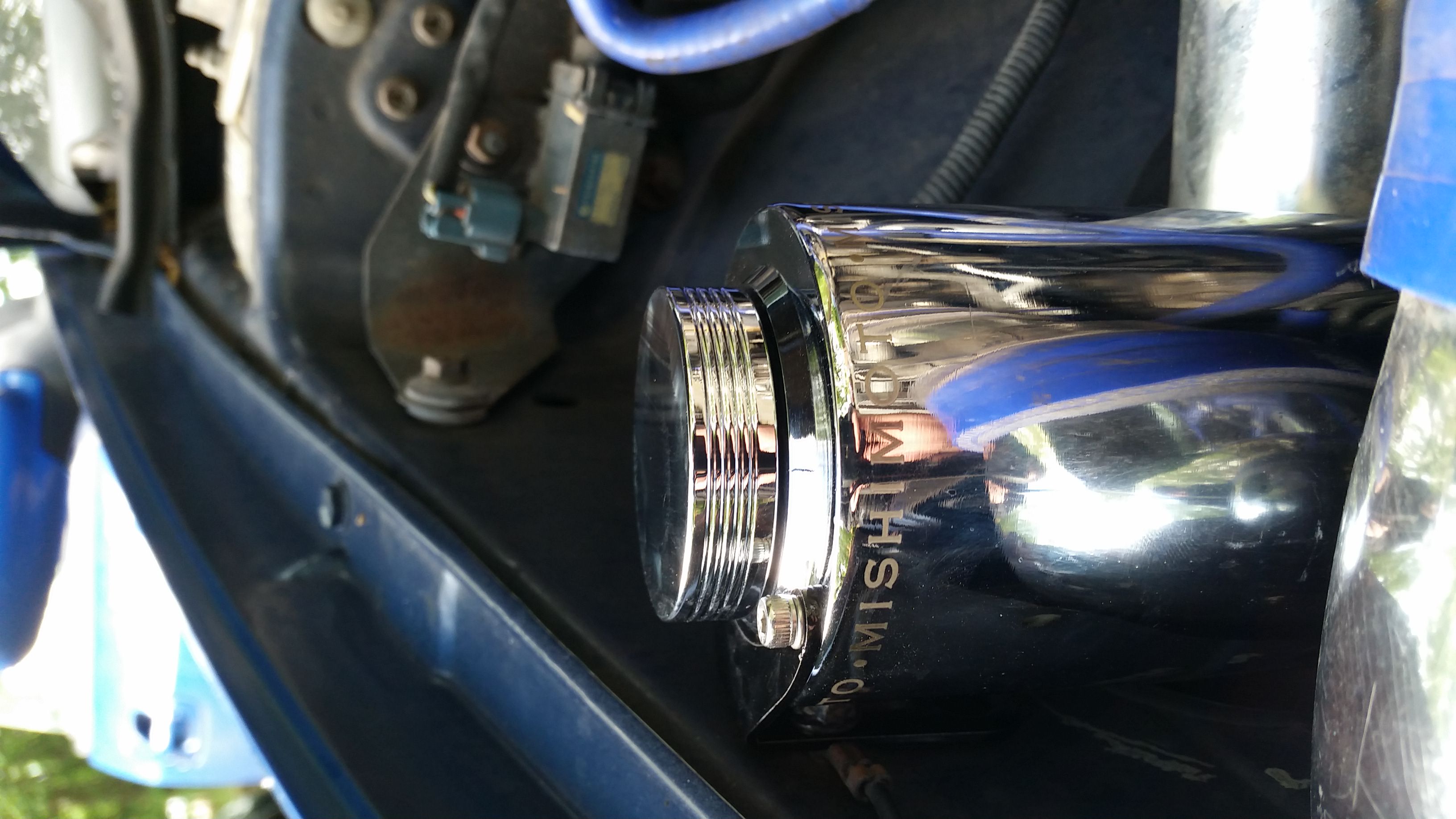

Mishimoto expansion tank [emoji4]
