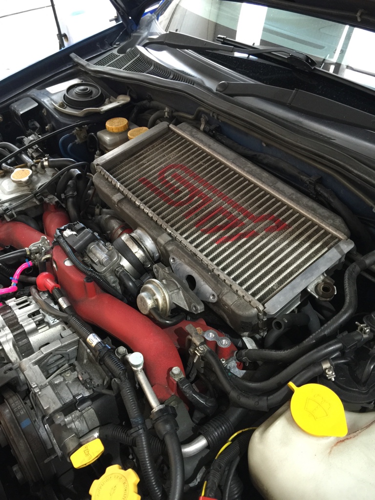

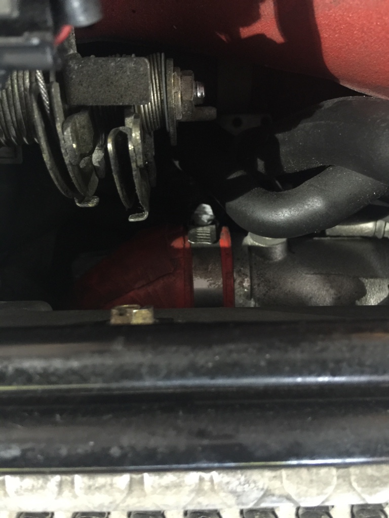

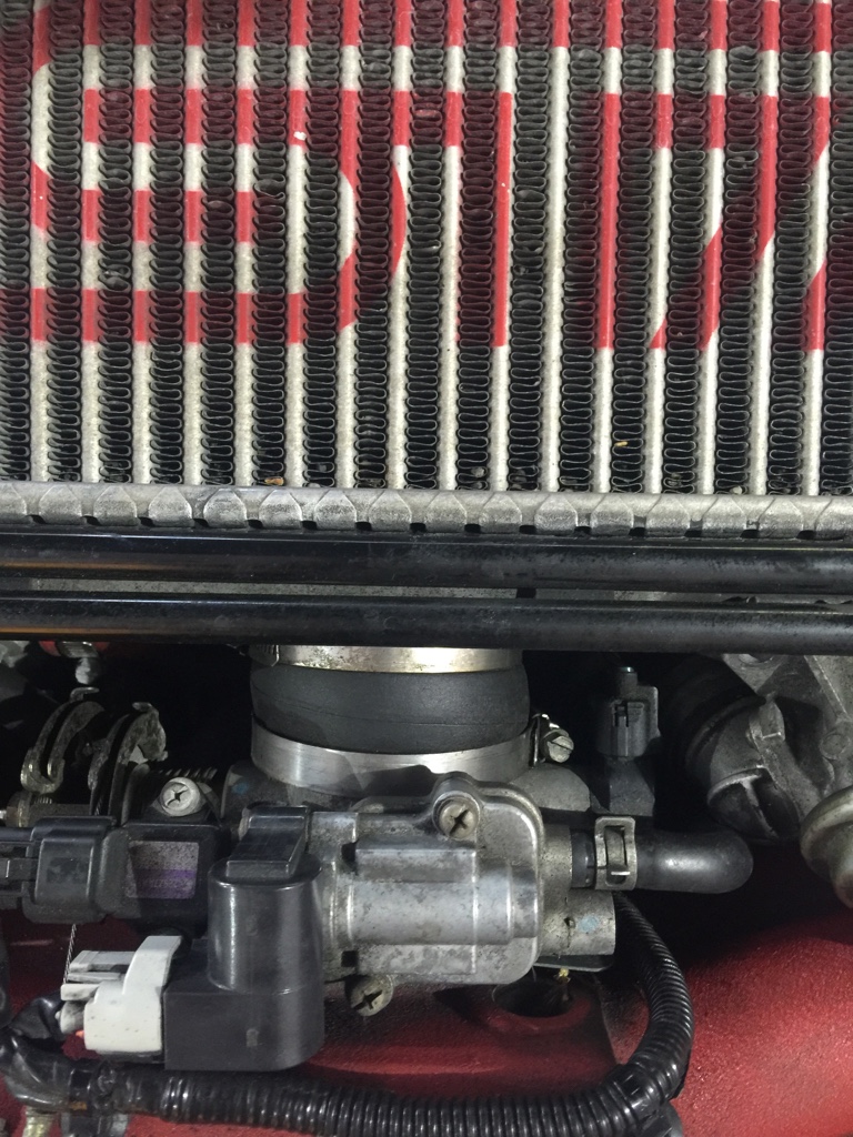

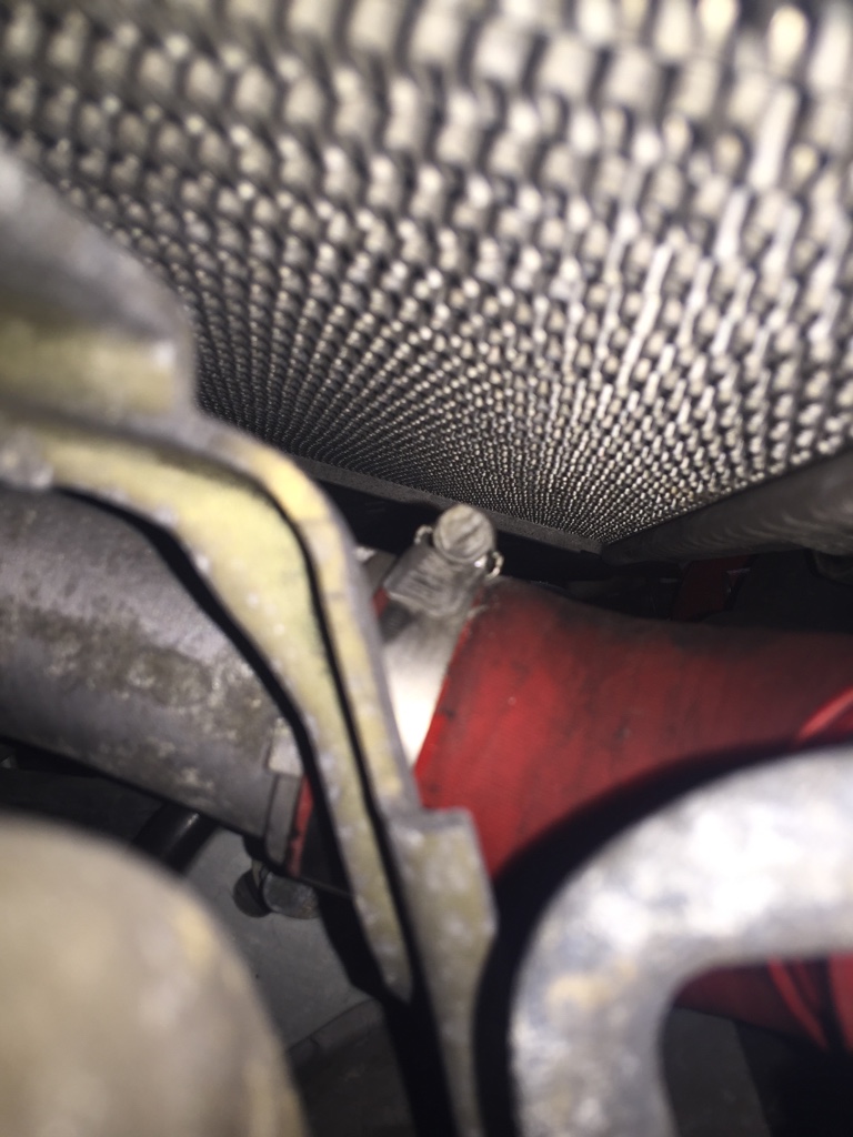

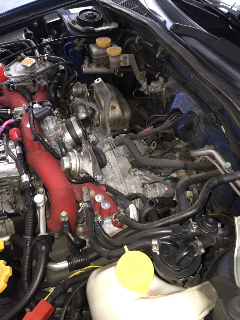

That's a scary thing for someone who's not in any way a mechanic... Intercooler about to come out [emoji33]
Well she came out with no problems... Replaced a couple of vacuum pipes ...
Now the !Removed! hard part... How does it go back
Oh and managed to stick a new panel filter in too
Prepare yourself for a bit of wrestling If you've not got silicone hoses.
Get the larger collar on then wiggle turbo hose on a bit, I found a breaker bar or long screwdriver between the cooler pipe and throttle body and just ease in on to the turbo outlet helped
Thanks for the advise... I'm currently struggling with this [emoji22]
They are a bit fiddly just make sure the jubilee clip is nice and loose on the turbo outlet to y pipe and that you get the under side on first so you can see it's on properly.
Sometimes holding the tmic almost vertical, getting the y pipe on and then twisting it into position works too .
You could try loosening the tmic to block bracket bolts but only if you can get to them once the tmic is back on .
I'm sure you'll suss it bud don't panic
Got it, got them all done up tight too found the trick is to undo the y pipe end of the hose as then they all fit together when you pull it onto the throttle housing ... Just need an 8mm socket and an extension bar to nip it all up!! [emoji41]

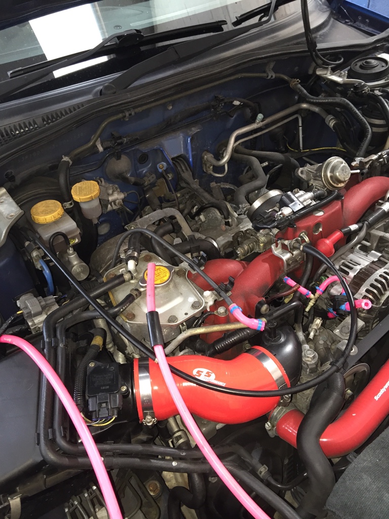

Well that was almost fun ... post-3889-143361810505_thumb.jpg just starting...
Panicking halfway thru...
The fight to put humpty back together again
She's aliiiive [emoji4]

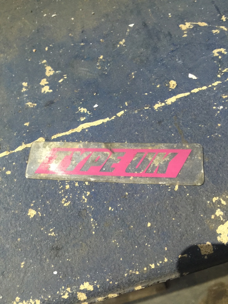

Lol look what I found buried under the intercooler... Shame I didn't find the socket I dropped a few weeks back
