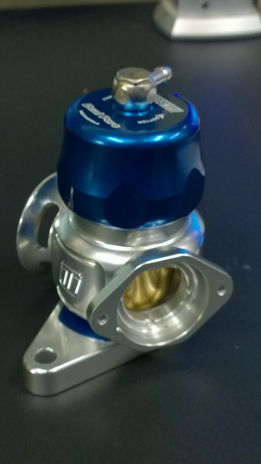

Got my turbosmart BOV today, well chuffed with it. Should do the job just fine :). However I'm foxed about connecting the return pipe... they provided a hose (which is already in my car anyway but may swap it for this new one) but it isn't possible to connect it to the BOV.

Any idea how I could get this connected? Am I missing a part from my subaru? I looked on google pictures at a couple them fitted and I can see some sort of "elbow" but can't for the life of me find one!
What hose mate ? I know one fits on the nipple at the top of the bov ?
The return hose to the inlet pipe, it has a bigger bore to the vacuum pipe at the top.

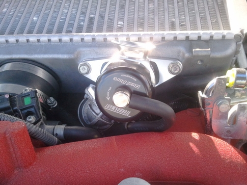

The elbow can be seen in this picture, bottom left of the Blow off valve. I need that...
post-2084-0-44145500-1438689344_thumb.jp
Have you tried having a look at their website/fitting guide ?

This helped figure out what the pipe was for and T-Piece ;). It also confirms the part I need...
"3. Remove the plumb back fitting on the back of the standard BOV and install it onto the Turbosmart BOV using the standard screws"
Can't that that part anywhere :(
Do you have a different i/c to what it's supposed to fit?
I've seen the elbow on sti coolers I'd that helps
It's all to do with the stock recirculating valve, the elbow is used to connect the return pipe to the valve. When people install aftermarket valves on they just get rid of the elbow :(.
I take it you can't blank it off ?
I can but that's not what I want, so I can fit the valve for now and have it vent to atmosphere until I find the elbow so it recircs some of the air. My car has behaved weird all the time i've had it, slow spool and popping. I reckon it's to do with the dump valve so go this one as a work around, if it doesn't help then I can enjoy the sound. It also holds higher boost pressure for future upgrades :).
Ah hairy muff, I don't really know that much about them I only have standard recirc in elbow & if I was to replace i'd get a forge like for like, not much use really haha
