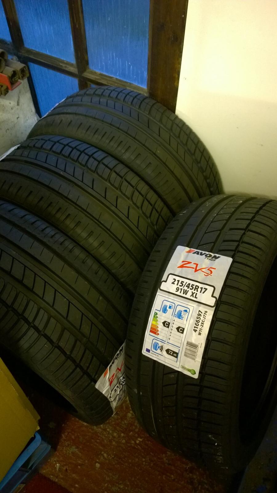

I've had tyres that are different tread since I got the car. Thankfully I'm getting my new ones put on tonight, a full set of Avon ZV5's! Will post a pic of the tyres that come off the car... from what I can tell there isn't much left of the inside tread.
post-2084-0-86874200-1406191266_thumb.jp
