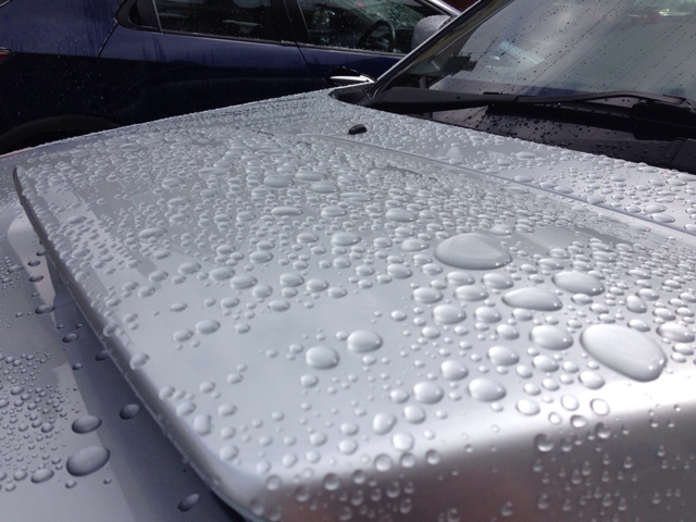

Had a bit of rain today, makes me smile when i see all the water beading on the paintwork :)
