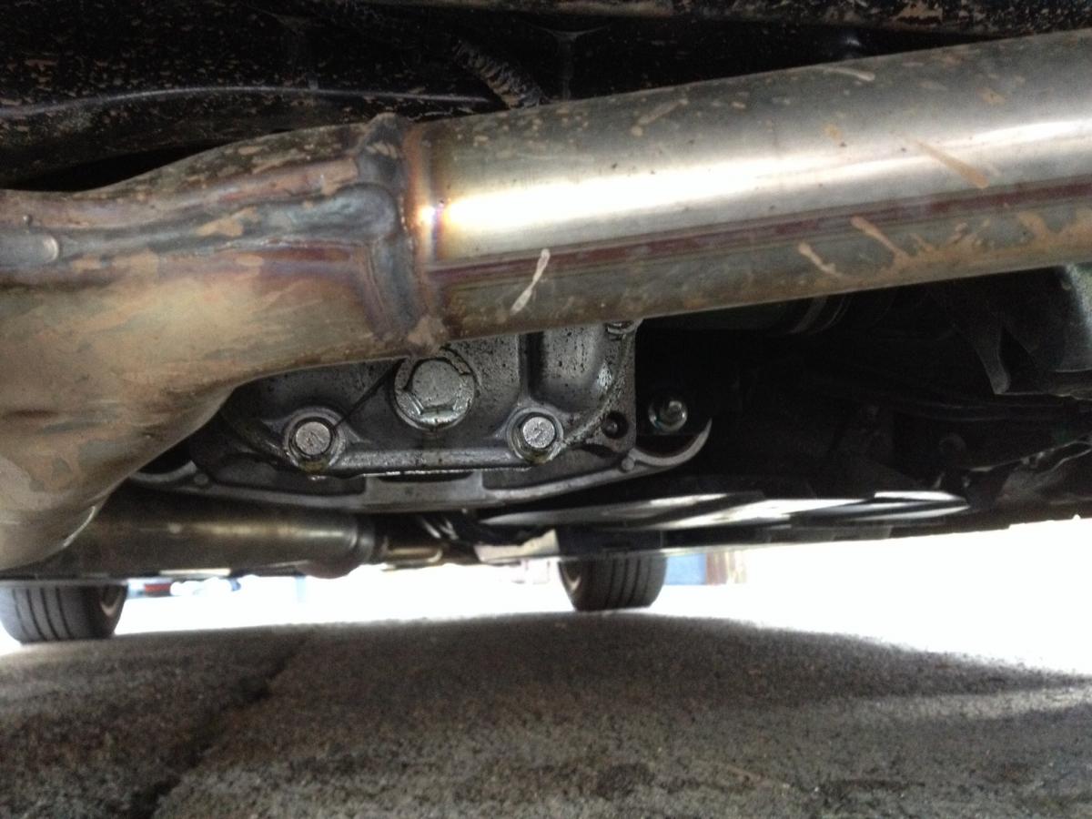

Hi guys,
Why would this silver/grey diff unit be leaking on a new car? Is it something to do with the AWD system yes? Big problem?
I'm going to call Derek Slacks in the morning.....

    Update: phoned Derek Slacks this morning, emailed my pic of the diff and they said bring it down ASAP. Got there this afternoon, and after an hour or so they have ordered some new seal. The leak is s

The upper plug on the diff is the fill plug.  Removing it and sticking your finger in is the only way of checking the level.  If theres still oil in there 30 miles shouldn't be a problem.  I'd wait for the dealers advice though
Got there this afternoon, and after an hour or so they have ordered some new seal. The leak is small, there is no risk to the diff being damaged. They will contact me when it's come in and they said they will keep my car a few hours.

Oh damn... Just looked under mine and there's what can only be described as green 'goop' on the underside of the diff... It's not visible dripping though, does that mean it's leaking? I have no idea of the consistency of the oil that's meant to be in there?
I'd wipe it and keep an eye on it mate but does maybe sound like like it could be possible. :( clearly a little more than a one of it seems :(

From what you describe your looking at the waxy protection that's painted on the diff. You would defo know if you had a leak as it WOULD be leaving oil marks on your drive buddy.
Oh okay, that makes me feel a bit better then! Thanks! There's definitely no drips and no oil spots on the drive. I'm guessing I probably shouldn't have just put a massive finger smudge in the waxy protection then!! :( I'll just ask them to take a look over it when I drop it in next week I think!

For what it's worth, I had the garage give it a good check over when I took it in... There was no evidence of a leak, what I was seeing was just the waxy protection that's applied to the underside of the car. So it doesn't appear to be happening to all of them. I'm at just over 2k miles now.
I'm taking mine into Derek Slacks on the 31st to get the leak sorted. Some seal has been ordered for it.
