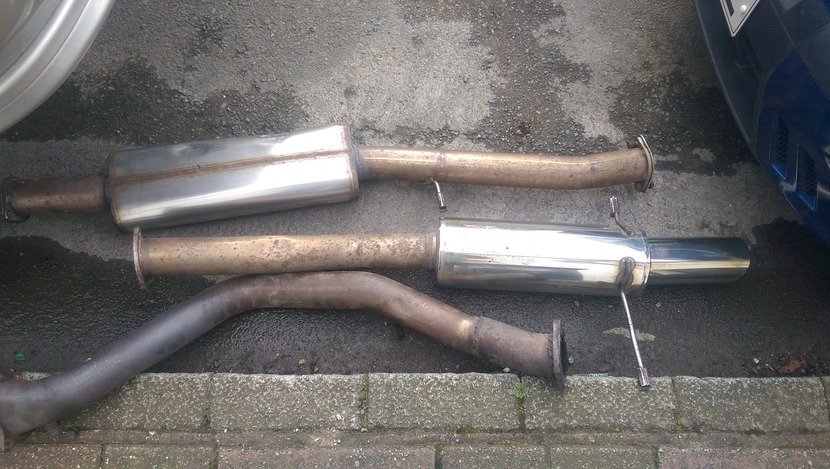

This is my exhaust not on yet. The centre and back are going on Sat 7th March. Decat will be on day of map. post-3548-142504291611_thumb.jpg
