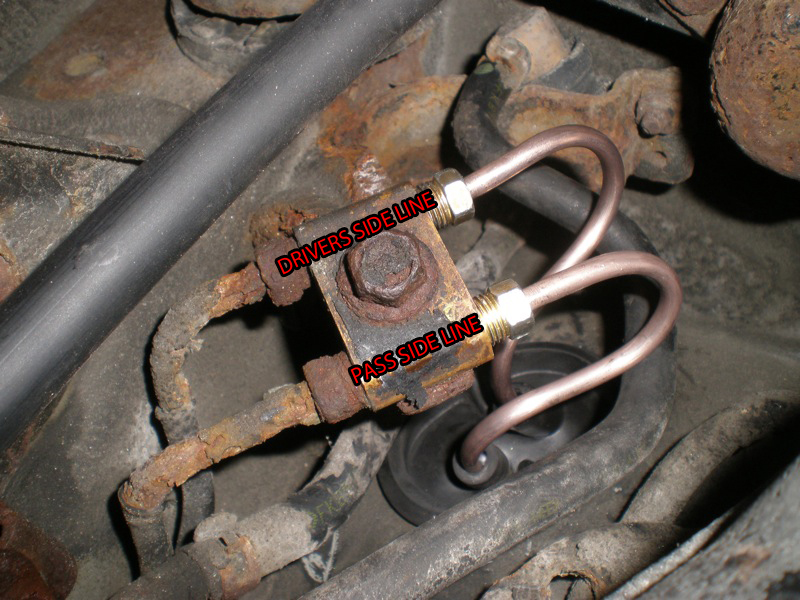

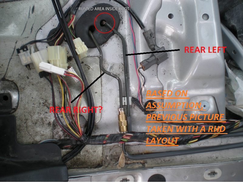

think my alternator is gone, when the engine is running and i take the negative off the car stalls. after around 10ish mins of running and use of accessories (heater, headlights, windows) causes my cluster to switch off and thus my revs go to 0 even though the car is still running, shortly after the car tries to switch off, if i give it some beans (2-3k ish revs, it runs fine again, but the dash still dosent come back to life).
Not sure if this picture was taken in a place that has the driver side on the left.//
Do i have this correct?
and finally a video
VIDEO
am i on the right track?

anyone got any pointers for which one could be the rear right brake line?

Good news is the 50/50 chance paid off and I cut the right one.
Bad news is the nipple I have that goes into the plastic flexible brake hose dosent fix so I have to wait for smaller ones which I ordered today morning.

No problem, no I didn't drop the tank, I pulled the back seats and threaded the shortest, straight route to the callipers while feed the line behind the lip of the fuel tank, I'll take some pictures.
