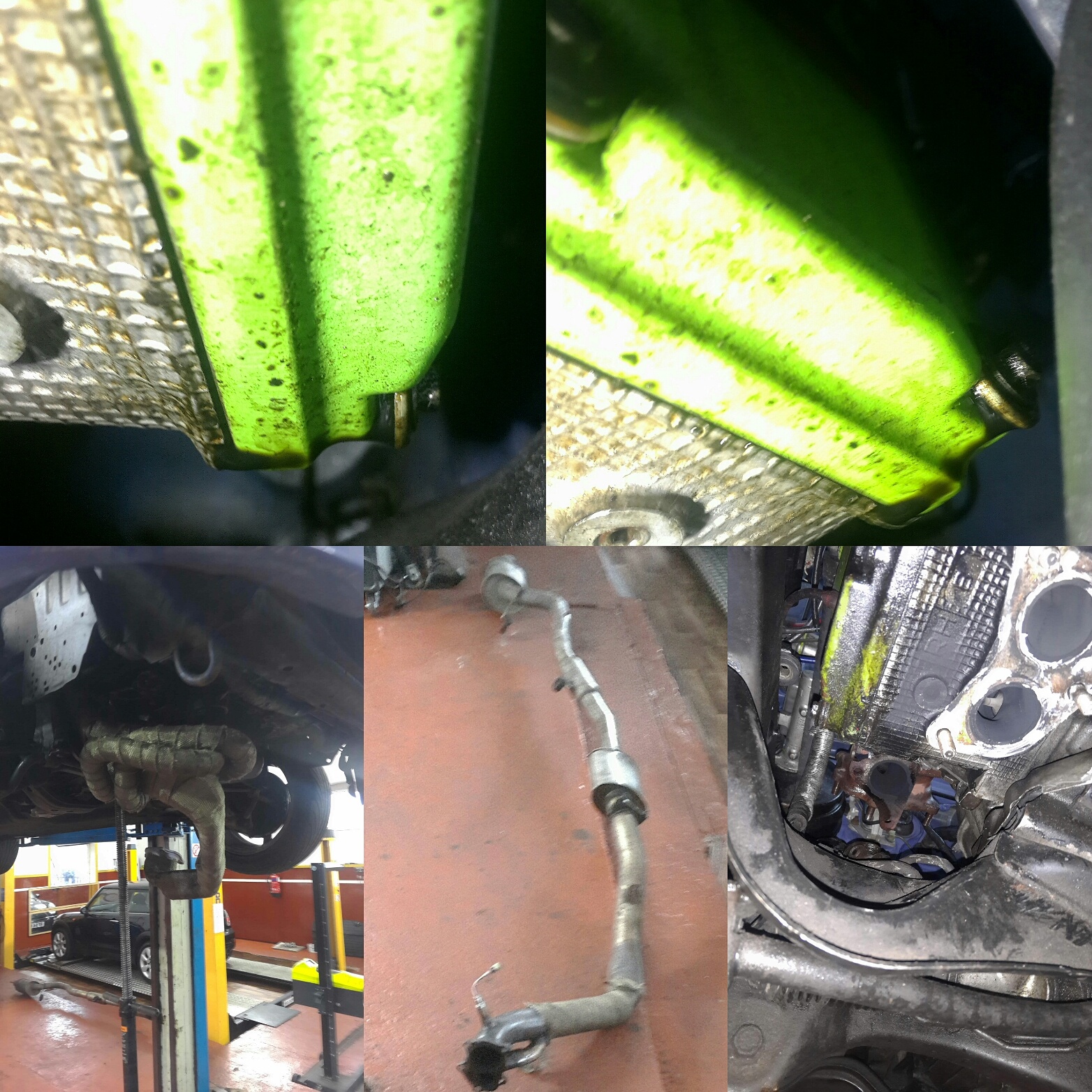

Well guess what! its overheated twice, with a puddle of coolant near the water crossover pipe!
i think my water crossover seals are leaking or one of the pipes which are holding coolant!!

Worst case it's the headgasket BUT the car has cometic gasket and was a fresh redone head according to the previous owner.

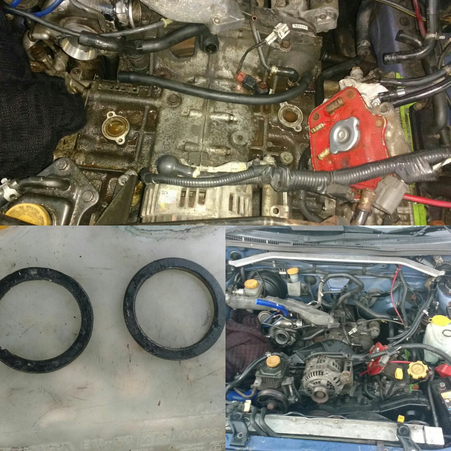

Looks like the crossover seals where never changed and they were brittle and covered in like algae.
Gonna do my service aswell, so ordered helix 5-40, some Fuchs coolant, new inlet manifold gasket, crossover seals and rocker cover seal.
After I fix this,  I'm going to check for hydro carbons in the cooling system via MOST man.
I mean the last time it happened was months ago, I've driven roughly 1k miles since then.
Only happened recently again! May likely be a slow headgasket leak, but then again, my coolant is all clean from oil and so is my oil of water.

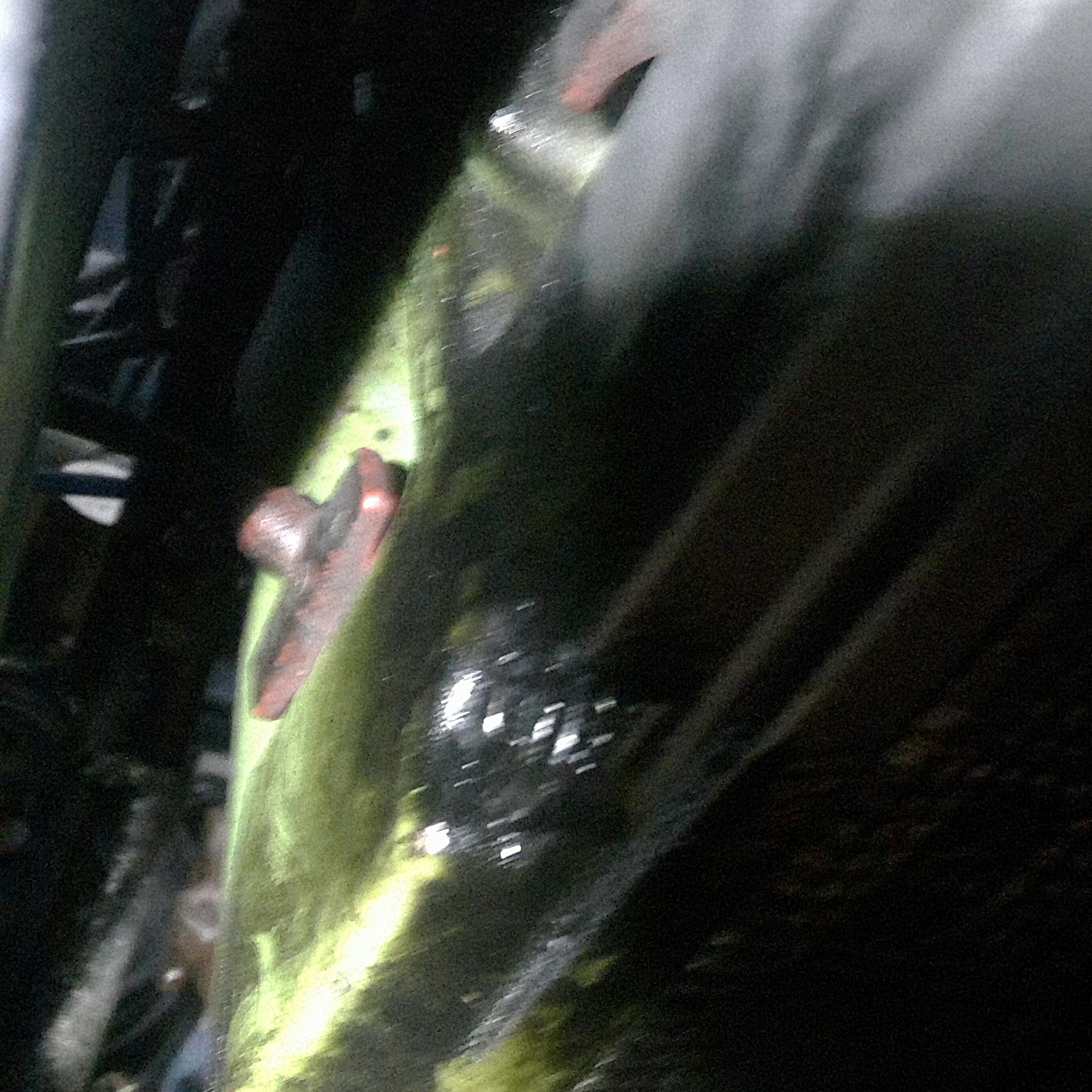

The crossover seals where hard as plastic! I think the previous owner didn't change the seals as the block was a v6 one، so it had the 1 sensor coolant crossover and the loom is the two sensor crossover so he had to change it and he probably didn't change the seals!
The good news is that i pinpointed the leak and it was infact the crossover seals that where gone.

well, a little update, me being without the boost and that, i went to assess the cooling system on the car, the pipe to the overflow was blocked out with sludge, so i unblocked it and well, i bled the car filled her up again and went for a boost and that and wolla, no overheating.
no bubbles in the overflow unless i squeeze the top radioator hose O.O.

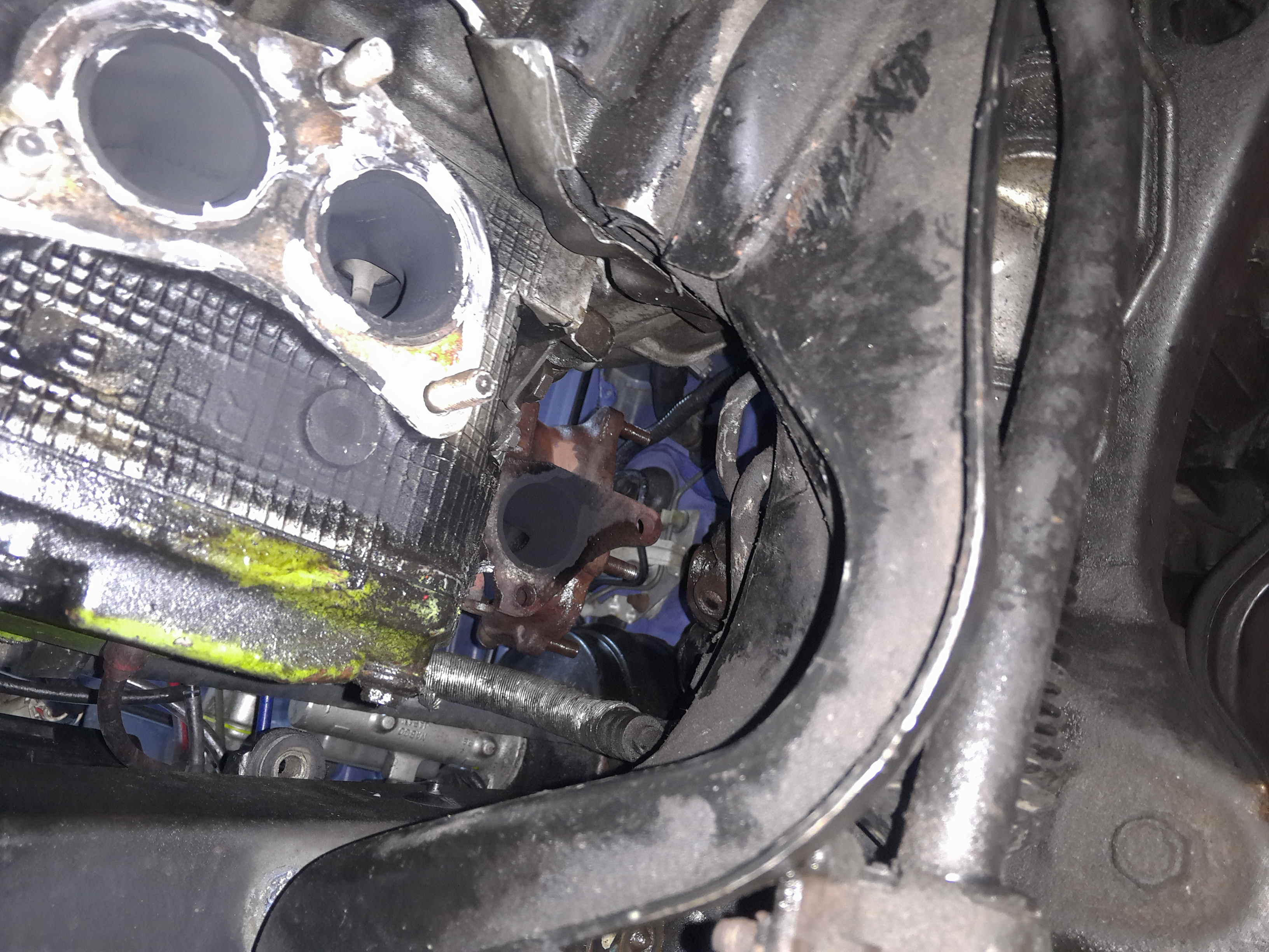

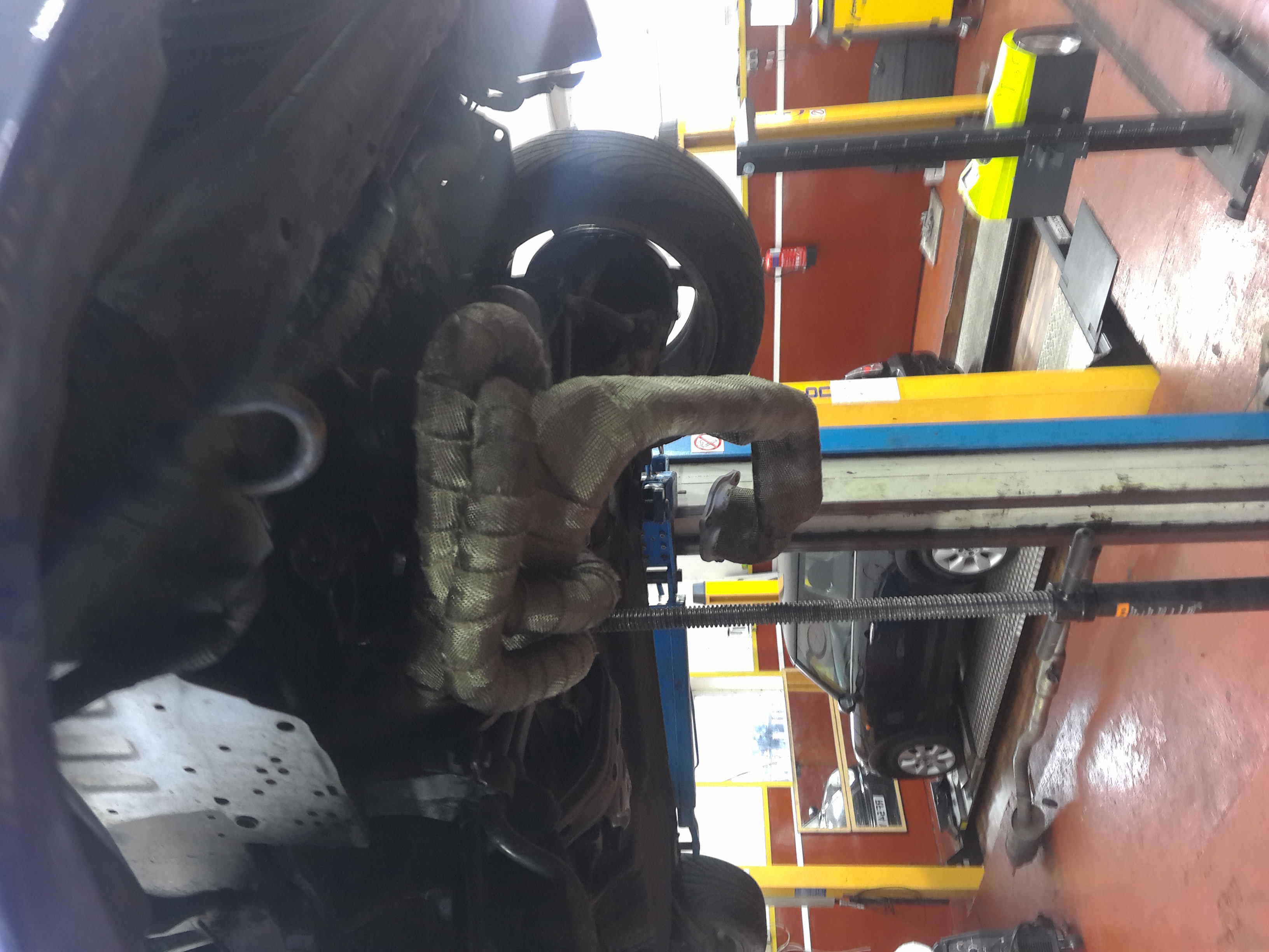

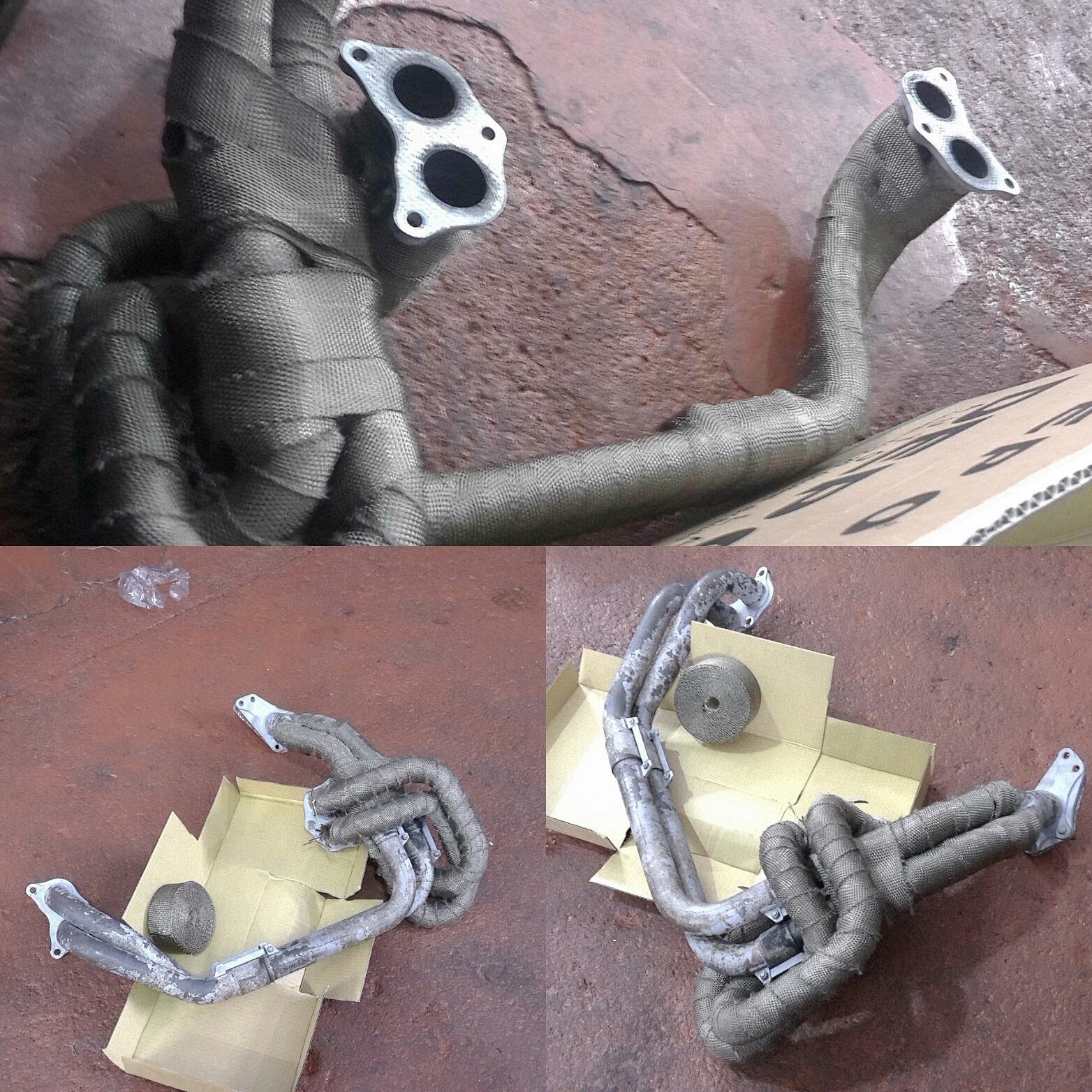

oh right, the ebay headers where really doing my head in on the up-pipe joint and the gasket just kept breaking so then i thought may aswell put the syms 4-2-1 manfiold on.
these manifolds required me to jack the engine up from the tranny to clear the motor mounts and drop the subframe from the bolts and pry the subframe down slightly.
i also helicoiled some weak manfiold studs with some help!
i noticed the oil leak wasnt from the rocker covers but from the rocker washers, so i swapped them out!
since i hit the downpipe from underneath during my very safe countryside runs O.O, i got the welder to cut the dented peice out and hammer it back out and weld it together, got him some 3" piping and we fitted the exhaust properly so that it wasnt hanging no more, also did a resonator delete :D
these headers...they sound...amazing..............like legit WRC:D
