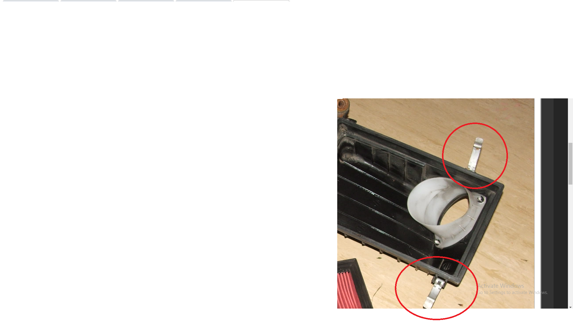

so i decided i made a retarded move to order a second hand pipercross kit, so i went and reinstalled the stock airbox back just now and ordered a kn panel filter from eurocarparts which i will pick up at 3pm today, i also gave the maf another good clean with some electrical contact cleaner.
however my airbox is missing 2 of these clamps:
anyone know where i can get some or can someone sell me some ?
euro car parts should stock spring clamps or a decent motor factor should
the redneck in me would..... Drill 2 small holes and whip a cable tie thro!
no place to drill hole as its such a tight fit!!! i cable tied two massive one and then strapped the airbox in, i really need to source some of them clamps :/.
