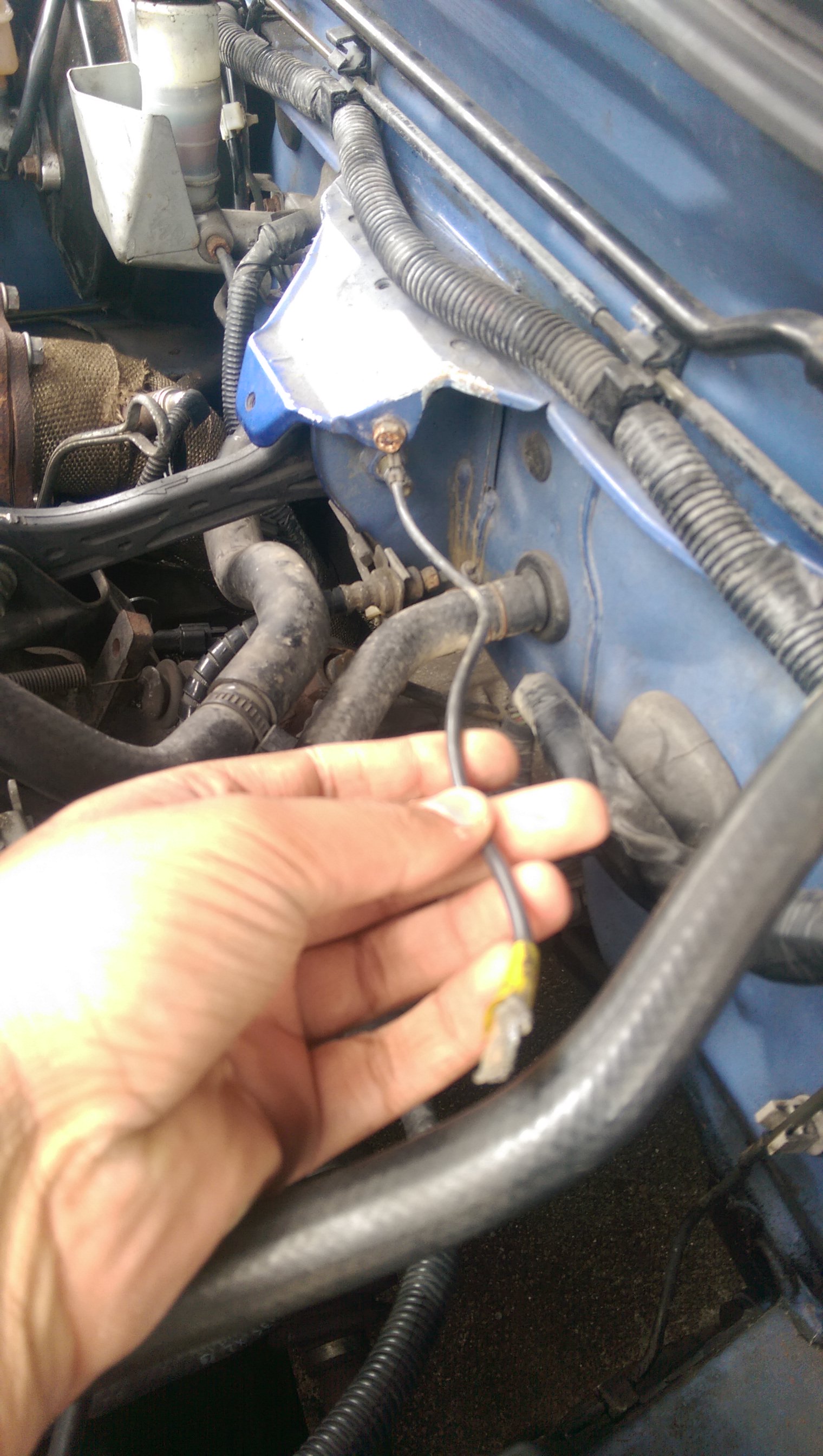

oh right i also found this random earthing cable ??

As for that earth I dunno where that's supposed to go as both of my scoobs have had that earth but neither of them had anything connected to the other end either lol
