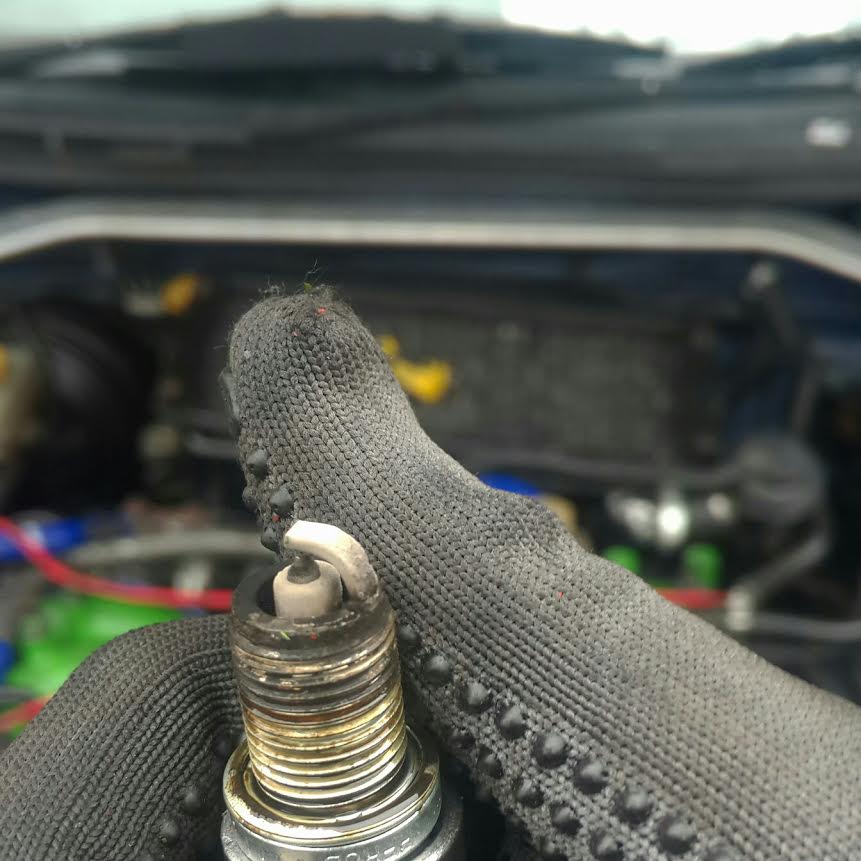

SO, yesterday i had the greatest urge to check my spark plugs (Last time i checked they were covered in fuel!!) this time no wetness, but this is how they look ;
i think that white crud is due to remains of injector cleaner in my fuel tank or am i mistaken ? is this a bad looking sprak plug or is it perfectly fine for out engines?
cant tell with the white stuff but I like my plugs to be more of a dark brown shade, its not oily so that is good, do you have an air oil separator fitted?
My guess is the plugs running too hot, maybe leaning off under boost ? What plugs are they ?
NGK PFR6B'S
Well, I think it may be time.to up the heat range with the syms manifold installed!
Time for PFR7B's
No! Just bog standard In that respect
the colour around the ring is not consistent and what is there is a bit black indicating could be running rich but nothing too serious probably errs on the side of engine protection / safety...
Spark plug colour guide
http://www.wallaceracing.com/plug-reading-lm.html
the white tip could be an indication of over heating plug - included a thread for info
http://www.audizine.com/forum/showthread.php/557952-possible-spark-plug-overheating

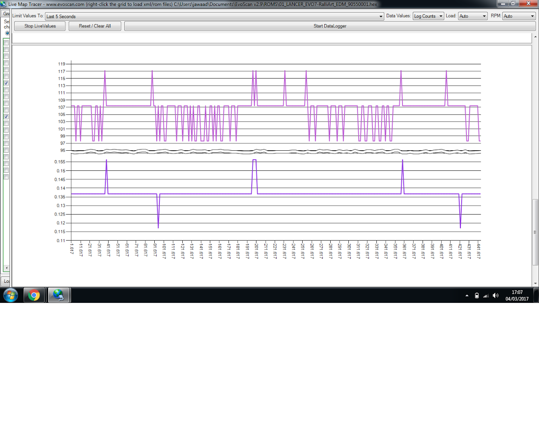

ok so i got a tactrix cable and evoscan software, finally geting some data from my ECU :D.
So im trying to figure out why my idle is slightly rough time to time.
on a warm engine, at idle, this is the behaviour from my MAF sensor VS O2 Sensor.
is this normal behaviour? what else can i log which can help me with this slightly rough engine behaviour, i mean ever so slightly.

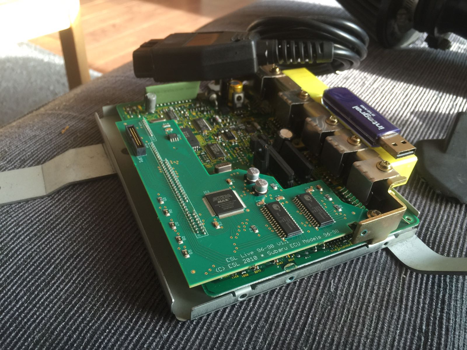

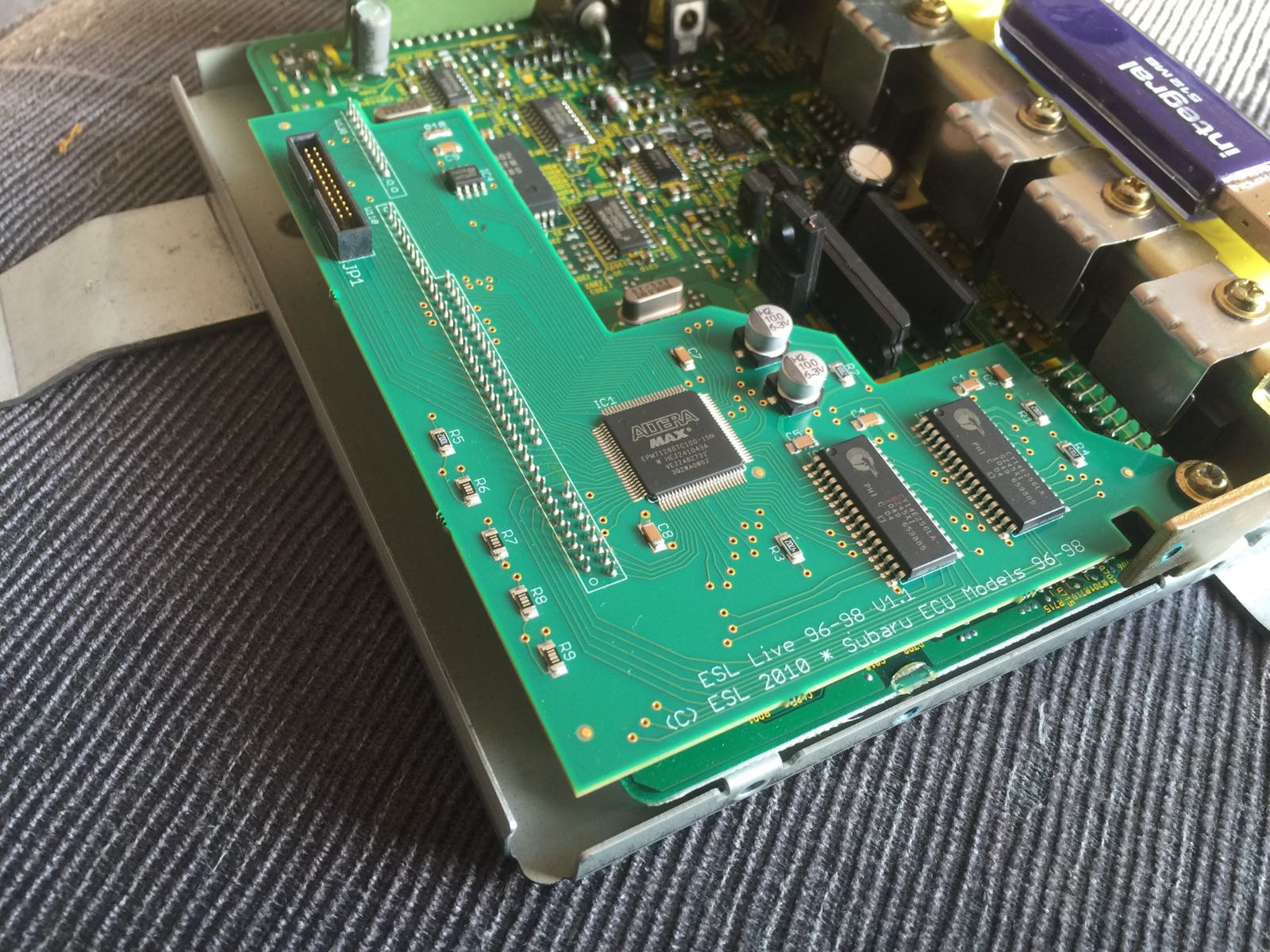

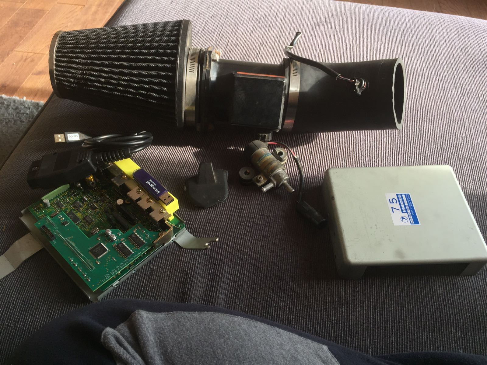

IMG-20170405-WA0018.thumb.jpg.f06e94eb00f062b740a0b0deb4755ba4.jpgIMG-20170405-WA0019.thumb.jpg.e069f8a39758f157bd9baf706654d96f.jpgIMG-20170405-WA0020.thumb.jpg.08f952ddce21162097641c22194b189b.jpg
caught this all howbowdah ;) @savage bulldogs
esl 75 with software and cable, orange maf, kn cone, intake air temp, 3 port boost solenoid and flywheel hole cover
