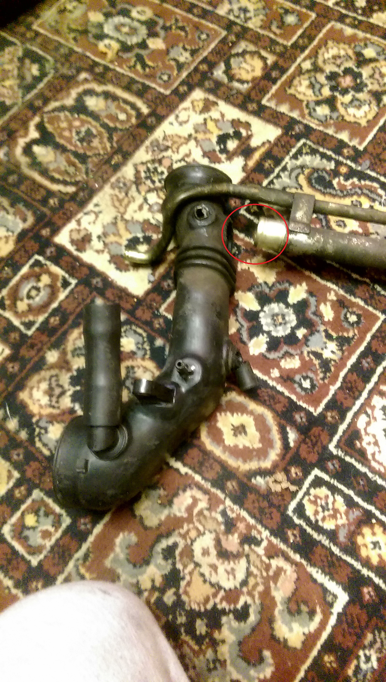

Long story short this happened.
My plumber friend filled it in with solder, will it hold or is it wiser to replace
Help!
Sent from my HTC One_M8 using Tapatalk
Is it a fuel or vacuum line that's been repaired ?
If it's fuel I personally wouldn't take the chance that it won't leak again and spray fuel all over the bay
I believe its a fuel line, and the pressurized one!
Can't seem to find one on eBay otherwise I'd buy one.
To be honest my friend did a good job and you can hardly tell!
The issue here is finding the replacement!
Most breakers chuck the fuel lines away (it's the first one I've ever seen fubar) try scoping face book for a second hand fuel line of the same phase .
Or spend a couple of hundred and get a parallel line set up 😉

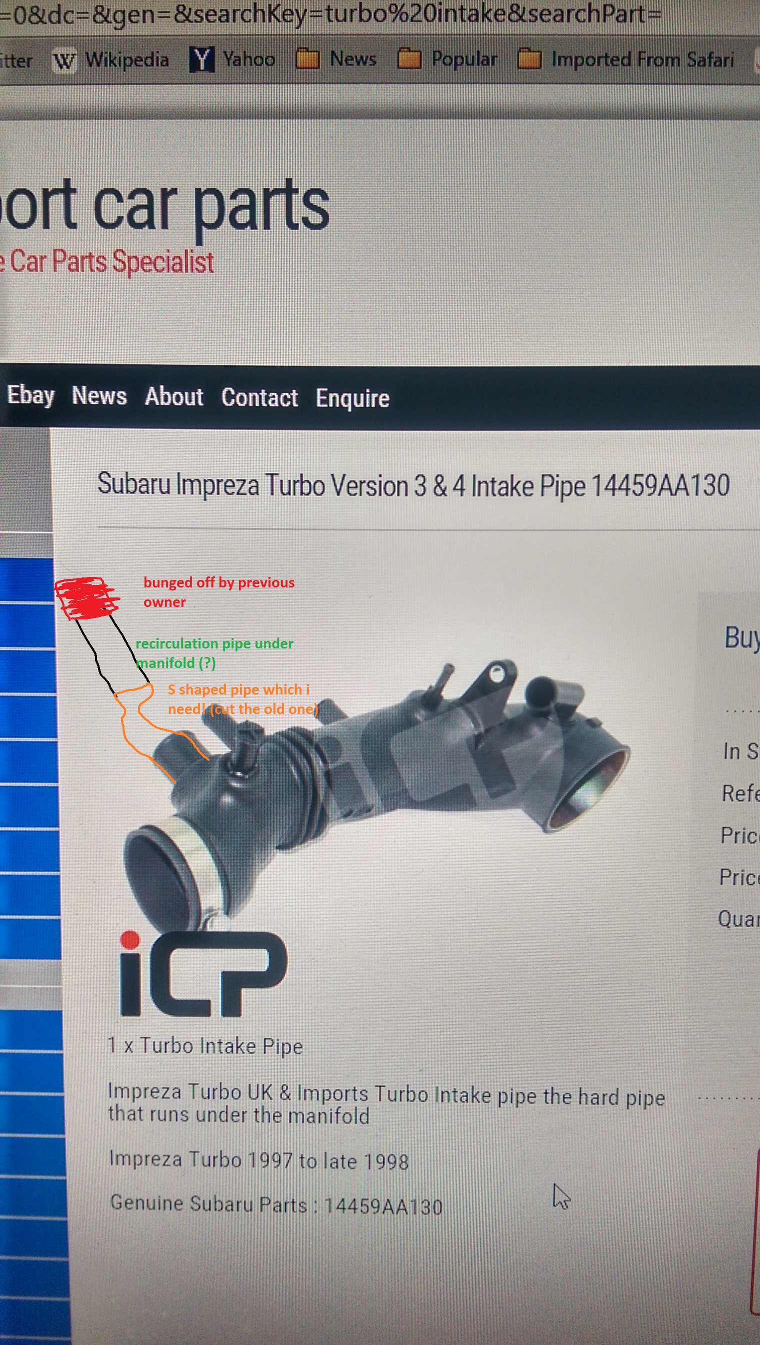

just a question @savage bulldogs
what is the name of this metal pipe!
I don't know what either pipe is called but .
It looks like either....
the hard pipe that runs on top of the inlet manifold from the icv to the intake pipe .
Or the hard pipe that runs underneath the inlet between the factory recirc valve to the intake . If it's the recirc valve one and your running a vta dump valve. you have to "bung" or remove it and "bung" the hole in the intake pipe it goes to .
If you do remove it and your still running a purge system, you will need to reroute the small bore hard pipe vac line though
yes its not the right angle pipe at the top but the one on the side;
IMG_20160303_165018.thumb.jpg.332e241bbb
@savage bulldogs does that make it any clearer?
Is it a little plastic elbow that runs off the intake pipe to the recirc hard pipe that's snapped off?
If so and your running a vta dump valve you can just bung the hole where the elbow was .then either re run the smaller vac line hard pipe in silicone or refit the hard pipe (with the elbow hole bunged)
Just had a look through a few pics and the small bore hard pipe isn't a vac line. It's either coolant or oil breather (can't remember which)
You can leave both hard pipes in situ connect up the small bore one and blank the opening off the intake that the s pipe connects to . maybe using the same bung the previous owner used to seal the end of the recirc hard pipe .
As if you've got a vta dump valve you don't need the big bore hard pipe but you must blank the hole in the intake pipe .otherwise it will suck in Un metered and Un filtered air .

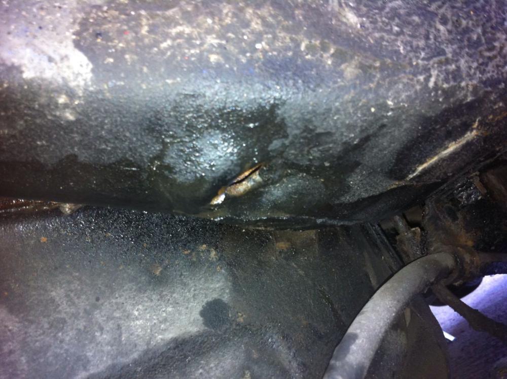

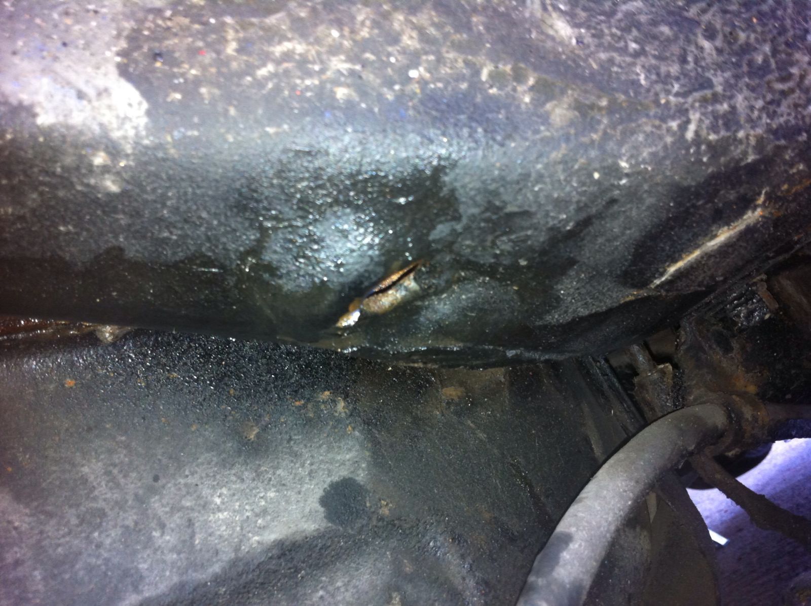

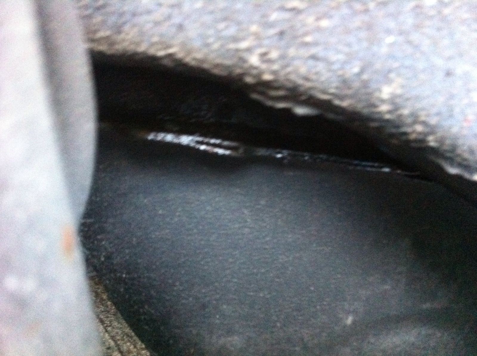

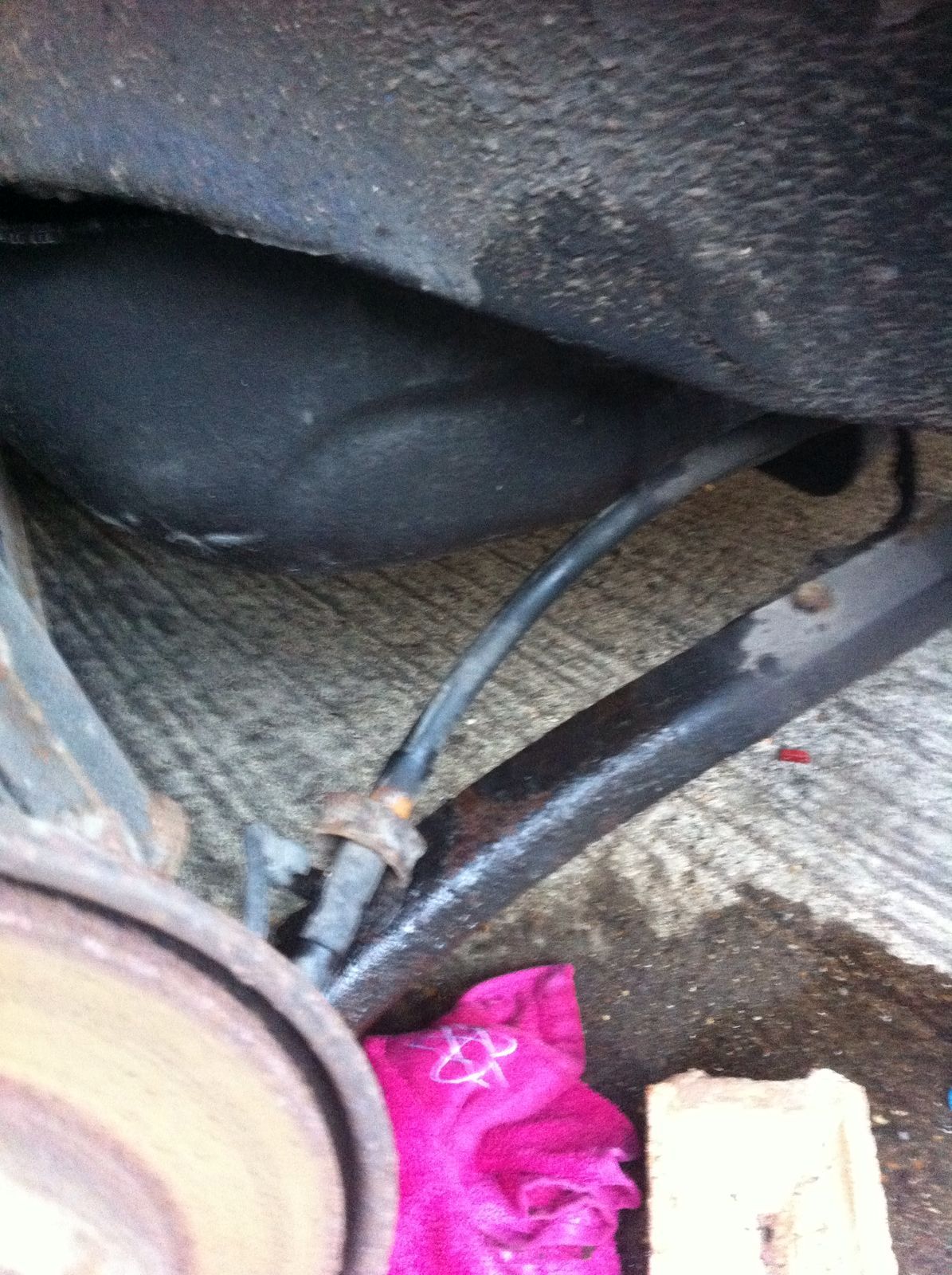

things are taking a turn for the worst :/ i decided to fill the master cylinder (never noticed it was empty) in an attempt to see if i could bleed the brakes and get them to work and this happened at the rear driver side axle :
and it was dripping from onto of the fuel tank.
and through this hole:

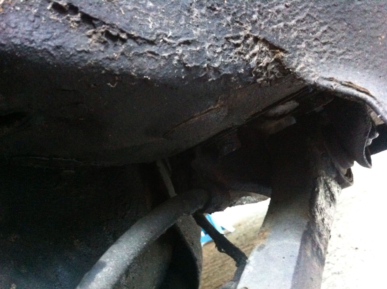

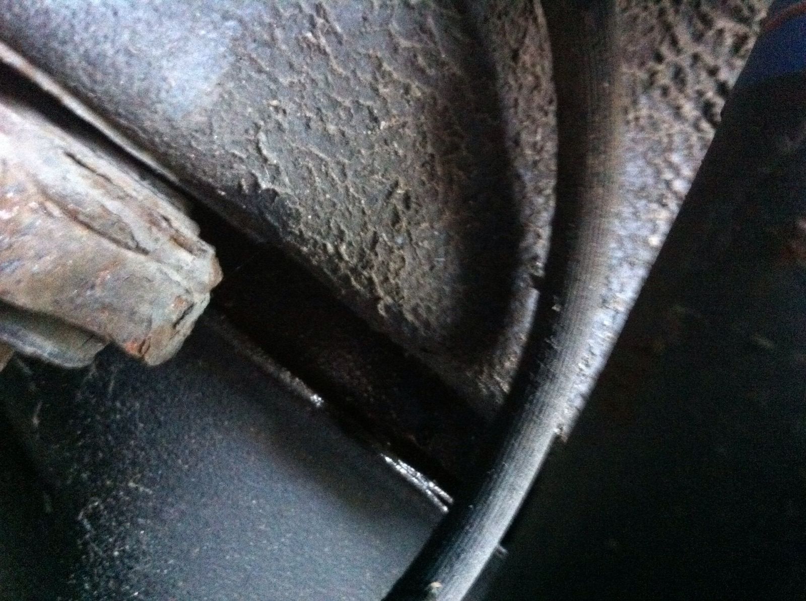

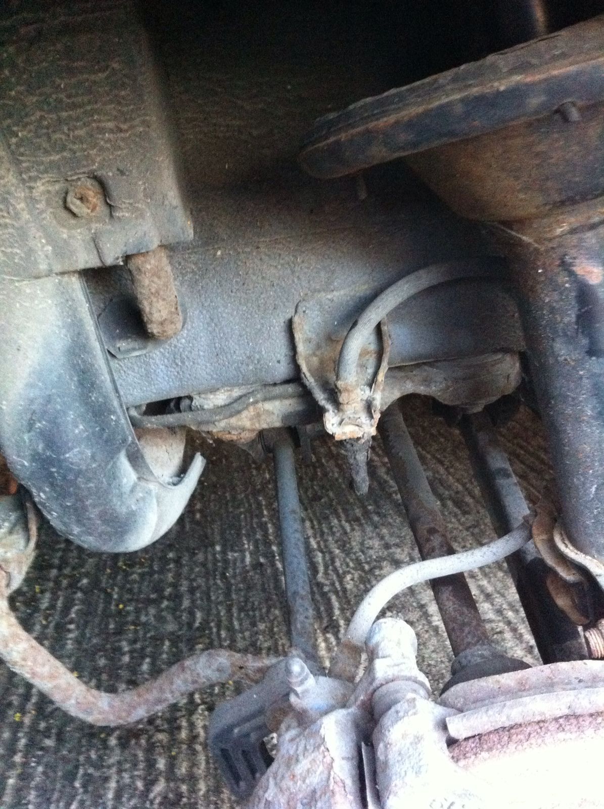

and we suspected that the issue was somewhere in this hard brake line
from my understanding (1) i need to take the whole rear differential off along with the axle to get behind the panel to the line and fix it.
I saw this fix regarding a (2) legacy; could i do the same thing ?
what do you think would be my best angle of approach and attack on this issue
Option (1) or (2)
any ideas guys, @savage bulldogs what do you think savs ?
To drop the tank the subframe has to come off,
Not entirely sure but the hardlines may go down through the floor under the passenger seat
just like in the video that i posted?
how long of a task is it to take off a subframe?; im genuinely clueless.
thanks for the heklp
Ah sorry not seen the video as was at work,
Depends how rusty it all is, savage is your man for that kind of question, but I think most of the back end needs to come apart to do it,
While your at it I'd check the fuel filler and if it's super rusty I'd change it wile the tanks out/down saves messing around at a later date ??
