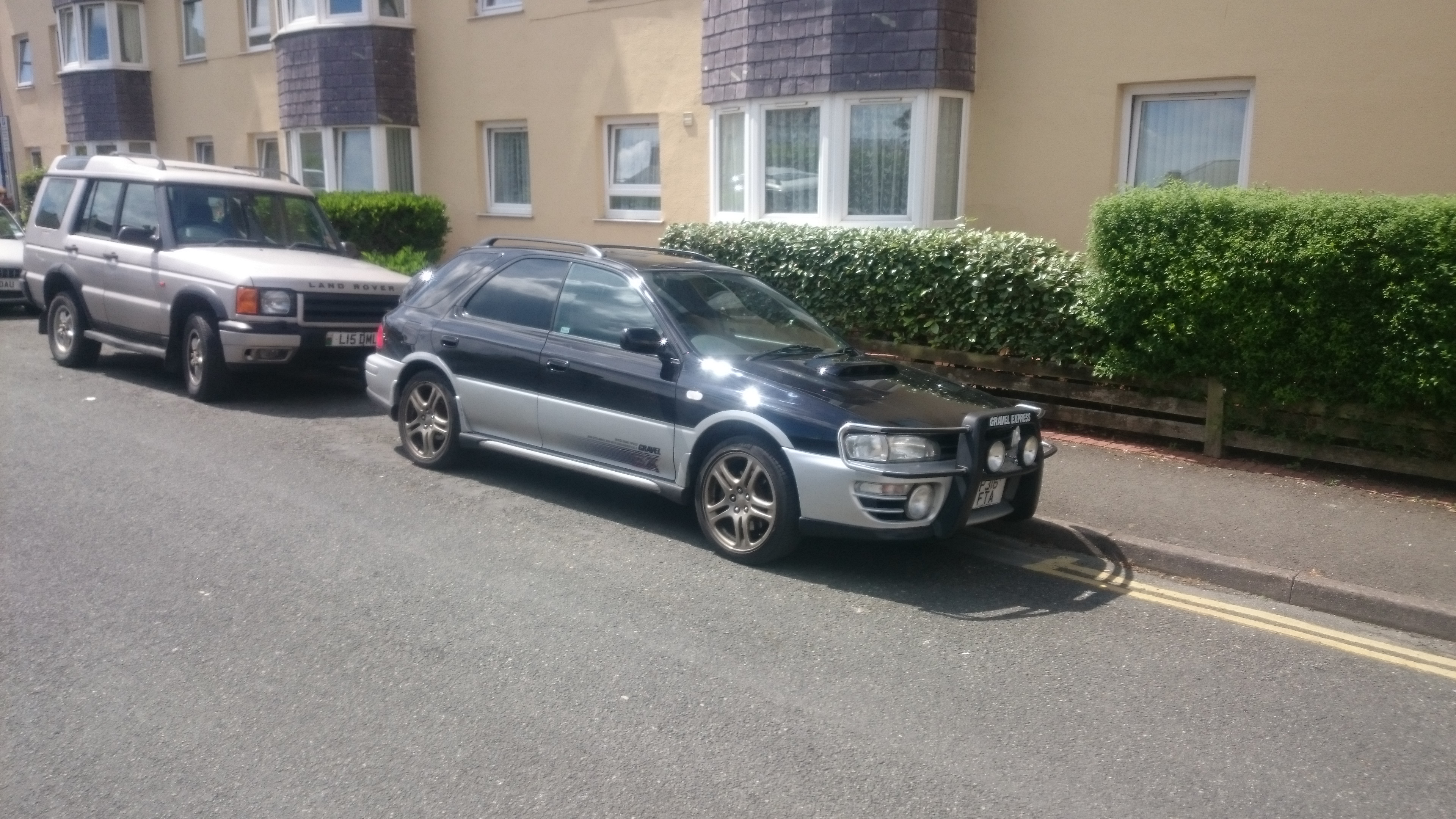

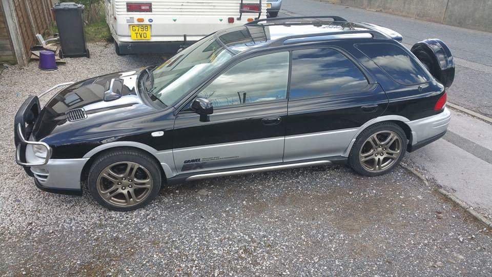

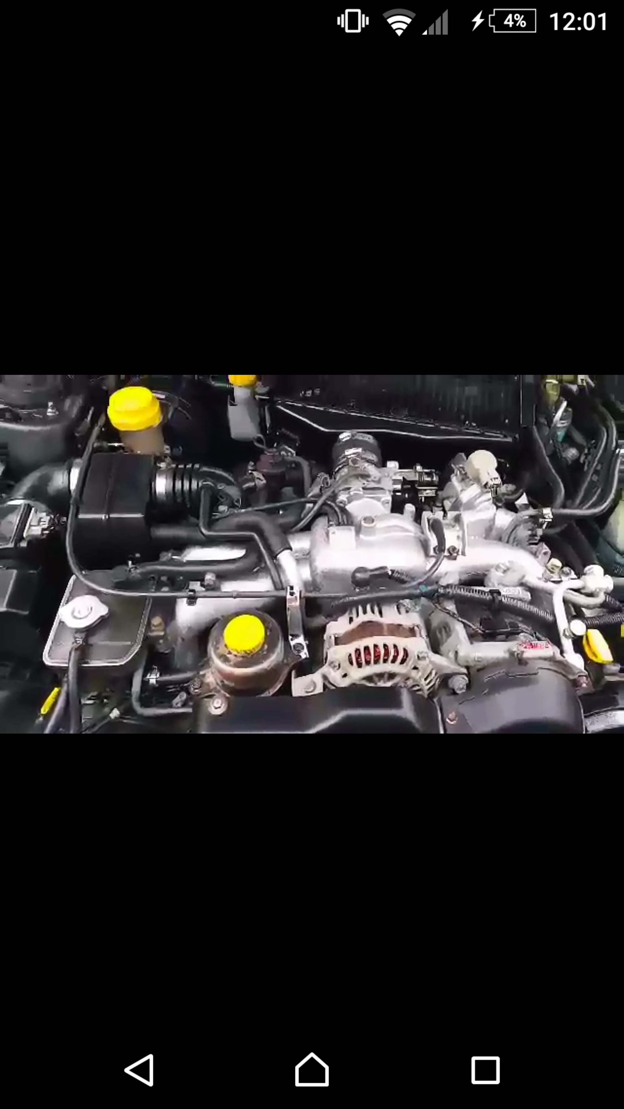

TomB Posted June 16, 2016 Author Posted June 16, 2016 Well guys, I've got it! Nice condition with a boot load of spares including doors, wings, rear lights, window glass, a clutch and more. It's got the TD05 turbo with 3 port solenoid, a Japspeed decat bellmouth downpipe attached to a Fujitsubo exhaust with the resonators removed. Braided hoses, 4 pot rear brakes with drilled and grooved discs and a few other bits. It came with the original Subaru service book and loads of documentation. I've got a stainless uppipe, an intake resonator box delete pipe and an ARC intake box to go on soon. I love it already! Here's a pic and a vid of the sound.
