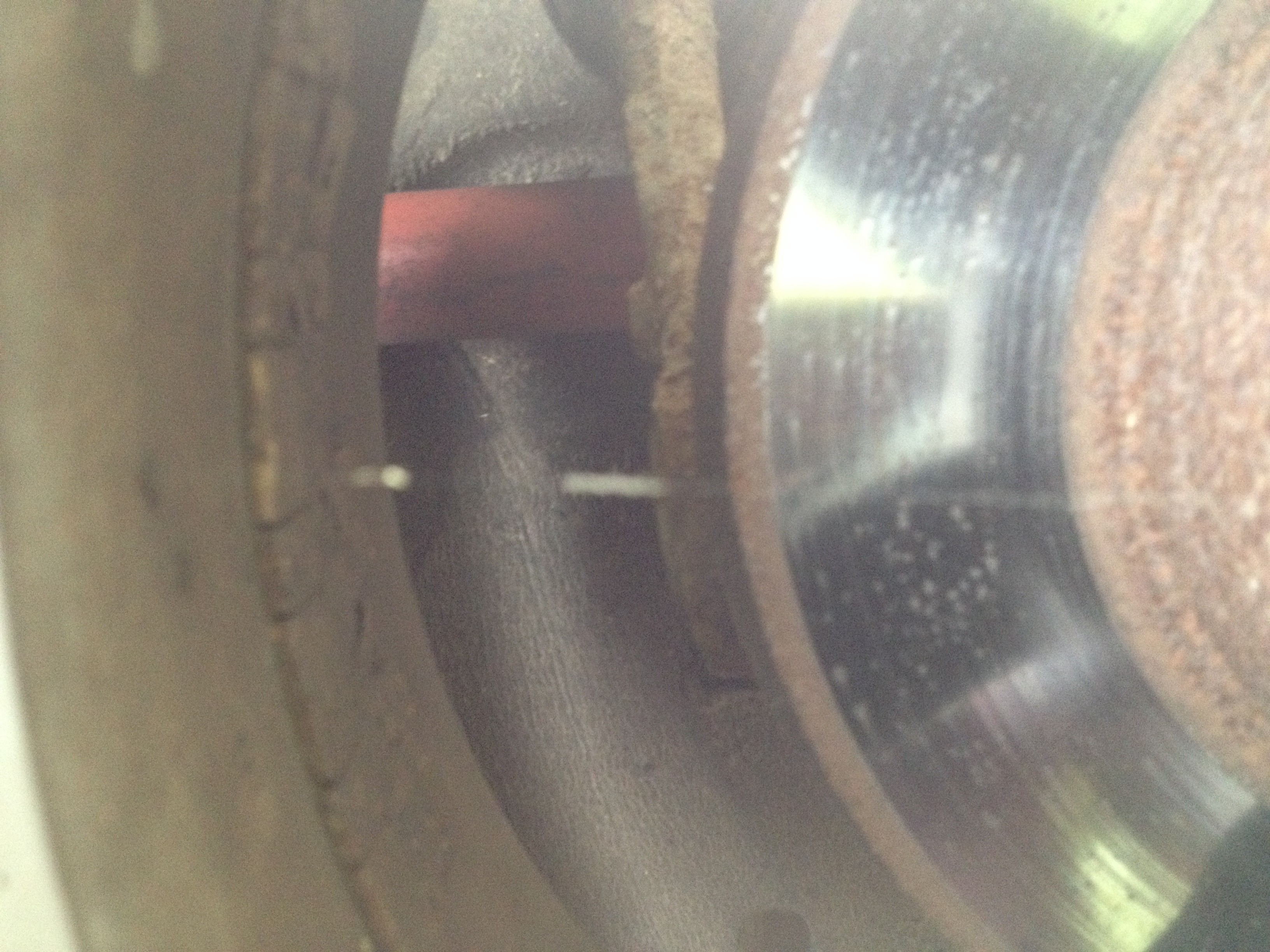

I discovered I'd got a seized brake piston. I guess this has warped the disc. Refurbished the calipers at the weekend with new seals. They all have a lovely sliding fit now. The steering wheel does feel a bit smoother when cruising but when braking especially from 80+ it's quite a bit worse! :sad:. When I checked for warpage by running the car with the front wheels off the ground, of course there were no wheels clamping the discs to the hub. So I expect the pads were holding the discs straight and giving a false impression. I think it must be discs but could it be driveshafts or CV joints?

Sounds very much like knackered discs tbh, how much meat is left on your pads
They're about half worn. I fitted new discs and pads last year. I've ordered some new discs now. If that doesn't fix it, i'll put all the wheels in for straightening. If that doesn't work I'll fit new drive shafts.
Even if the disc are recent a seized caliper will.make light work of em. If youre replacing the disc you'll be best off replacing the pads too. The old pads may have uneven wear due to the warped disc.

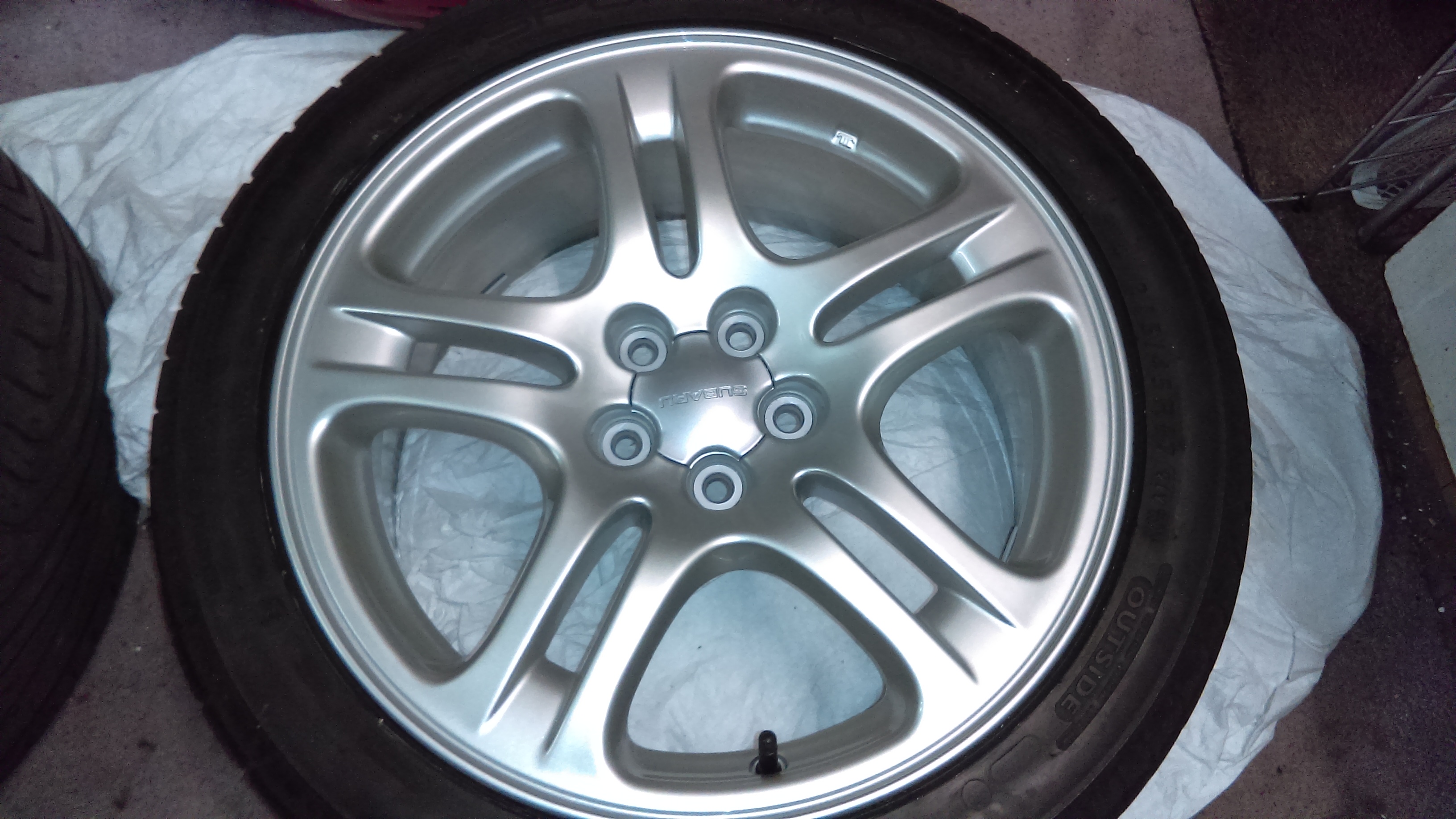

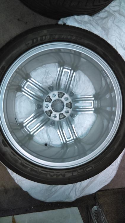

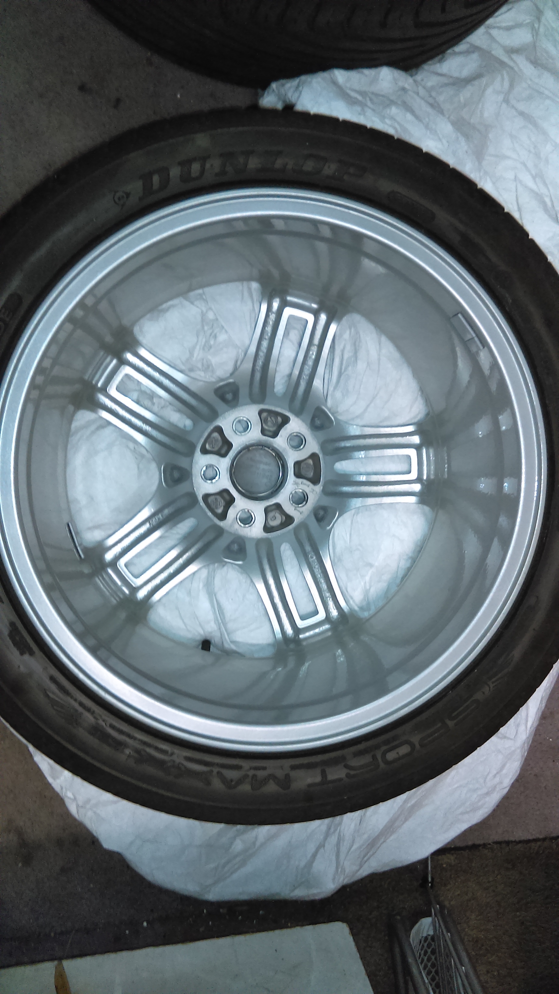

The wheels have gone into Reinventing The Wheel near Tewkesbury for a total refurb. They say all 4 are bent [emoji20] which they can fix [emoji4]!
Well the wheels are back. They look lovely, drive smooth most the time, but still a slight vibration at 80 :sad:.
