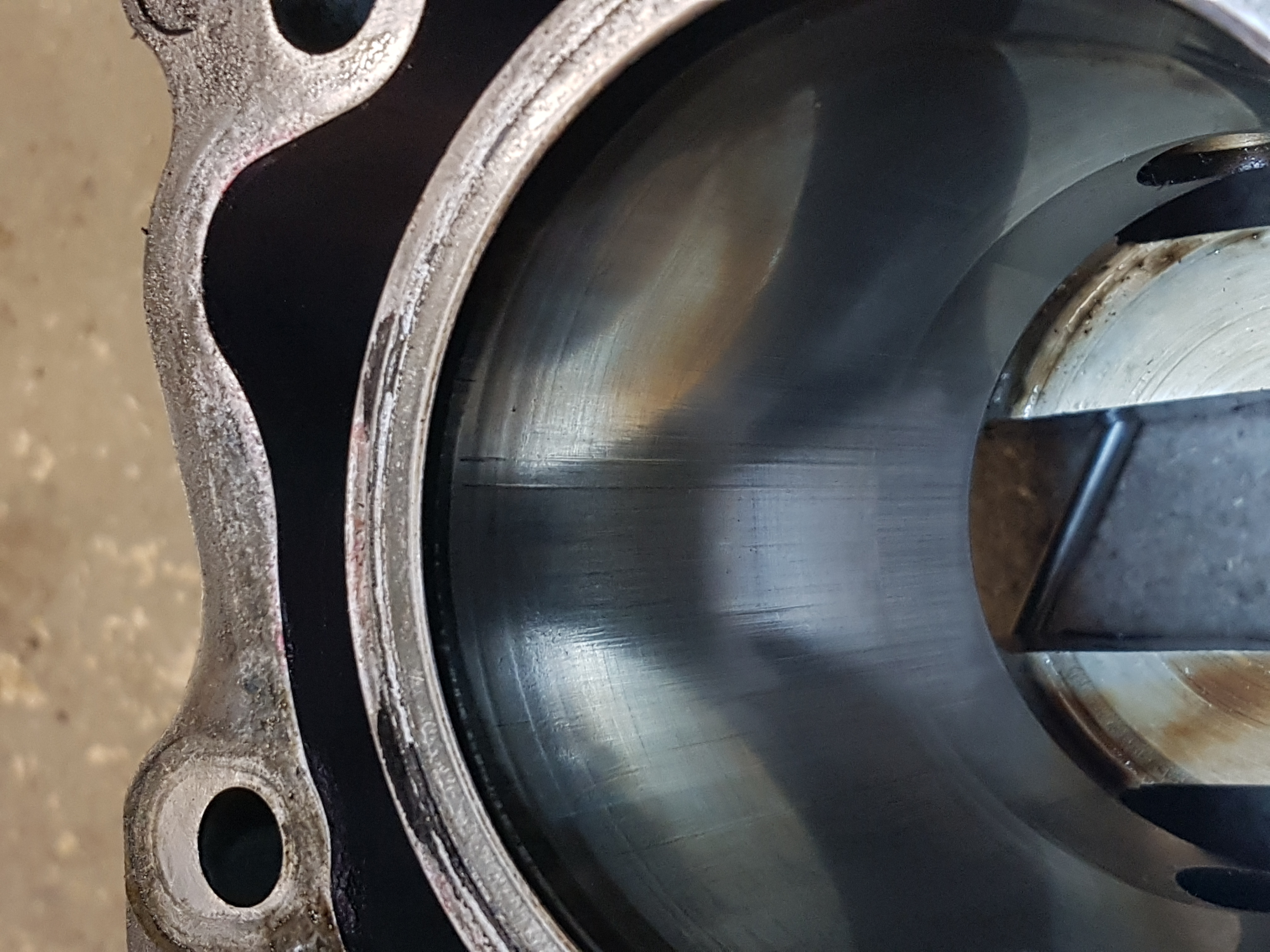

Oops that's broken, new parts time
It was running nearly ok just smoked a bit compression test said was only on 3 so got a spare engine and gearbox but change of plan, just going to put new pistons and bearings in this one and maybe a tubular manifold.
12 hours ago, Piggysniffer said:
Didn't know classics did this 😕
any car can. Failure rate on the 2.5 is just massively high by comparison. I'd want to find the cause before rebuilding. also need to check the block to see if its warped or ovaled etc
I had never seen or heard of ringland failure tidge, not in all my years of messing with cars, until I got the hawk
I've seen a few at high millage, Typicly associated with det though
