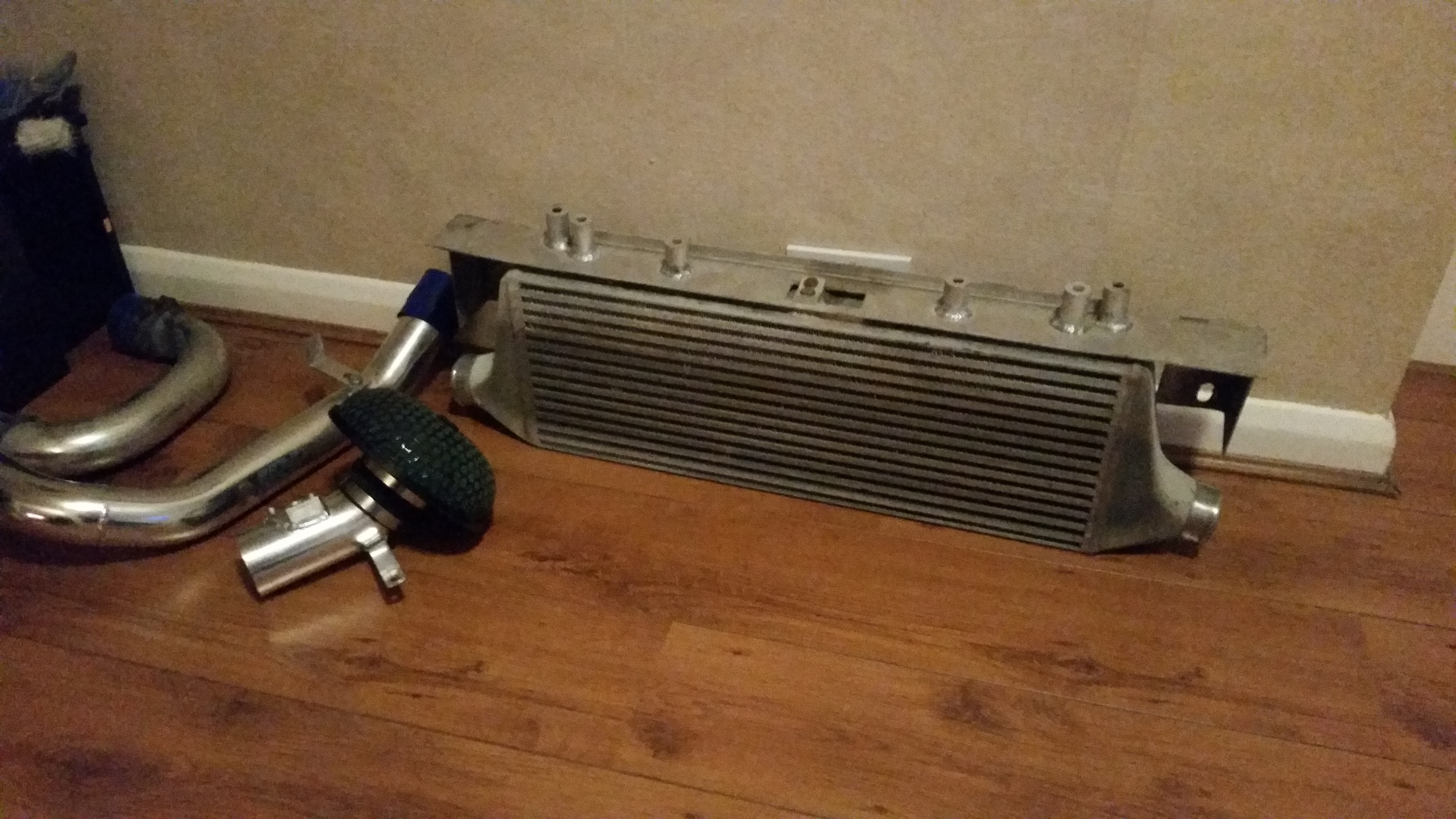

i fitted one to my bug wagon i had,a morning work its a easy job to do @RpsChesterfield taking my time it took a morning,you will loose your airbox as pipes run through a hole in wing were your airbox is so add a cone filter to your cost and a dump valve as most fmic dump valve are ones that attach to a pipe not onto a base plate like original,also have one on my hatch as well now,i will say dont buy a named over priced job unless you just want the name as the eBay ones are just as good and will do just as good a job.the black one on my wagon is a eBay one and the other is custom made for the hatch

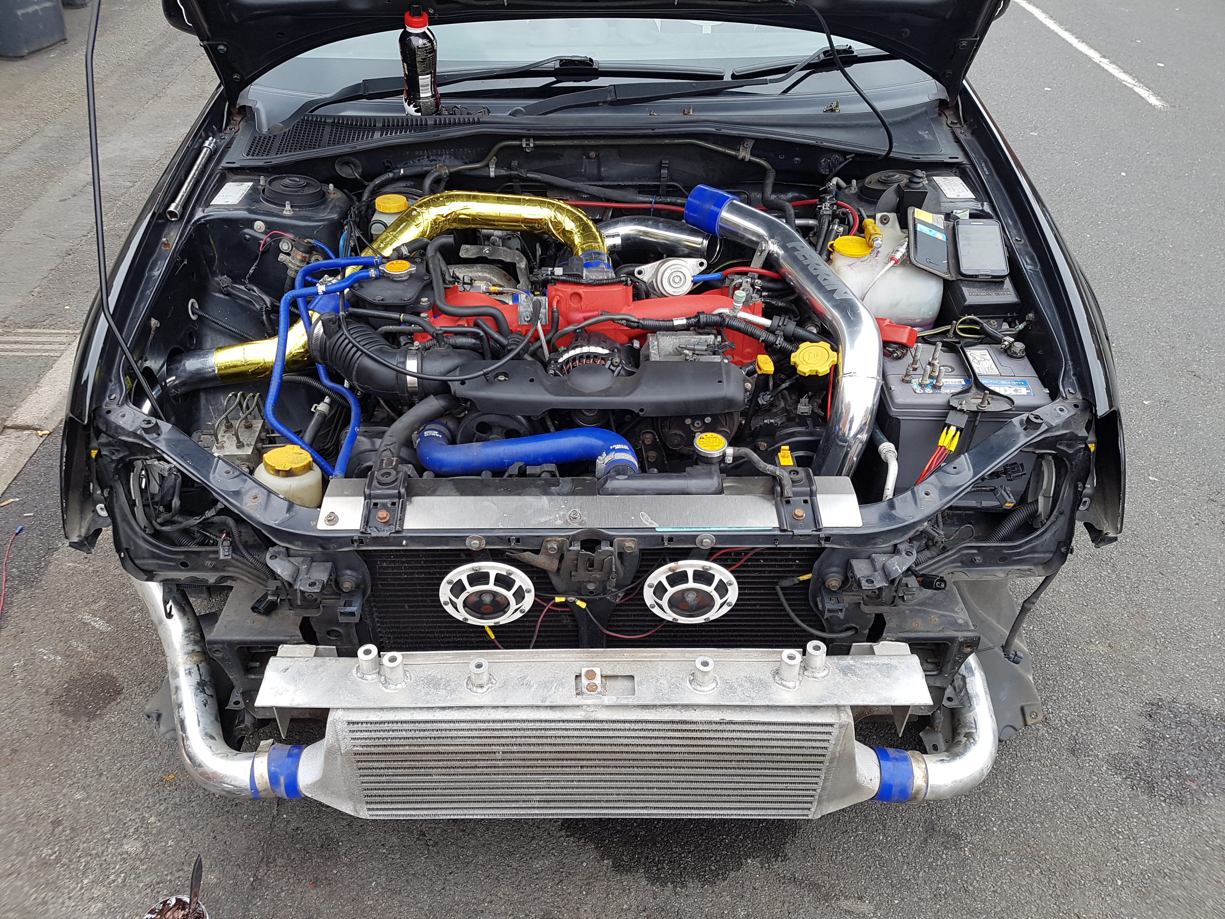

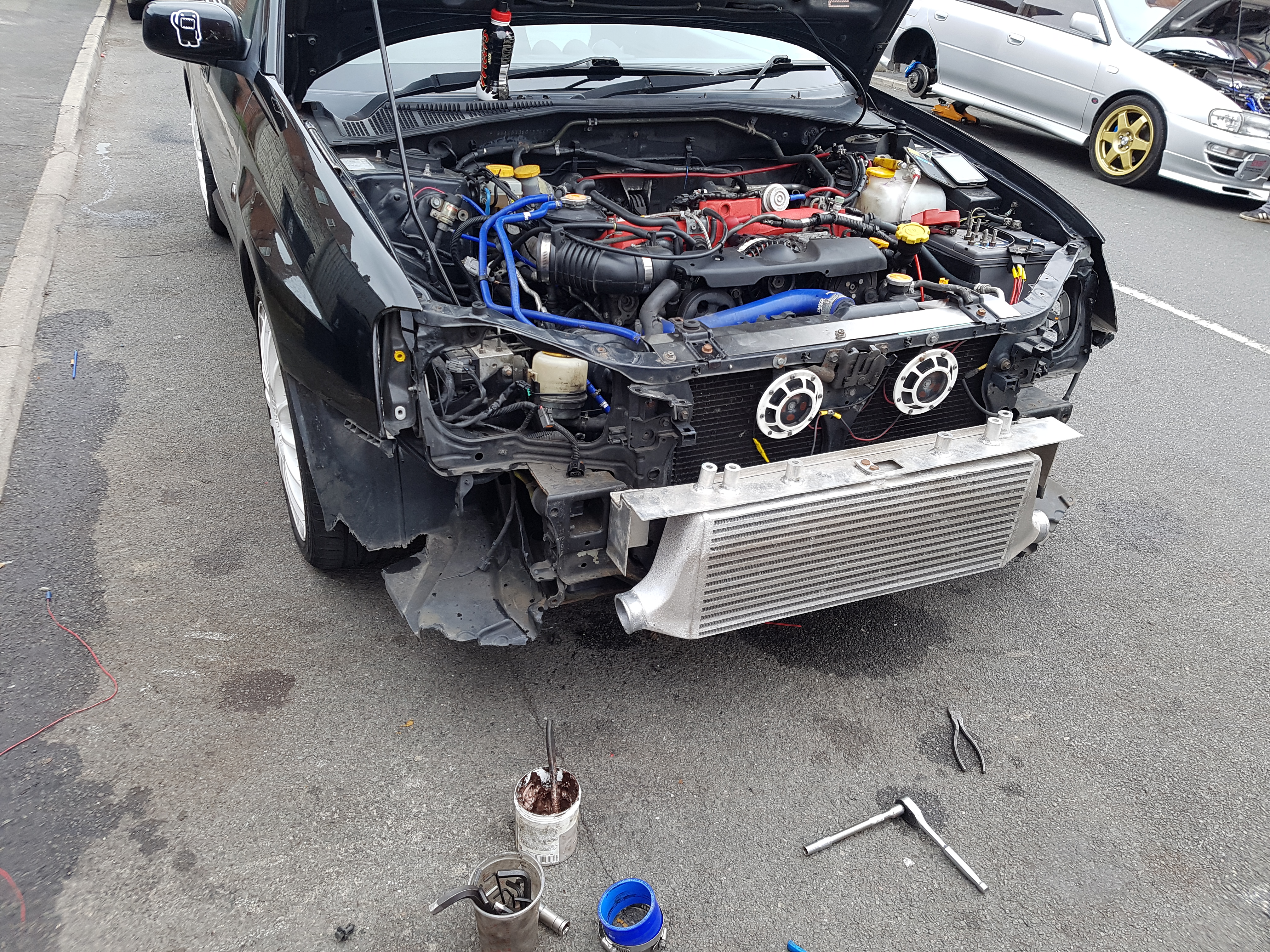

First off, lag is a myth or a trait of a crap set up, right setup it wont make any difference, or at least none that you can tell by feel (disclaimer, yes there is a slight addition if you calculate it on paper, but your talking fractions of a second). Most people who perpetuate that refer back to a calculation that Andy F did donkeys years ago that was majorly flawed, assumed zero pressure in it and that gear changes happened at 3500rpm.
My car pre front mount,
My car post front mount,

on top mount 3500rpm = 250bhp, 380ftlb, on front mount 3500rpm = 280bhp, 420ftlb, same turbo, both on syvecs with same supporting mods bar the addition of a front mount (not a small one either hahaha).
eBay coolers are hit and miss, get the right one (internal of the core is the important thing) and its fine, get the wrong one and it will be crap, airflow will be disrupted and it wont ever perform.
