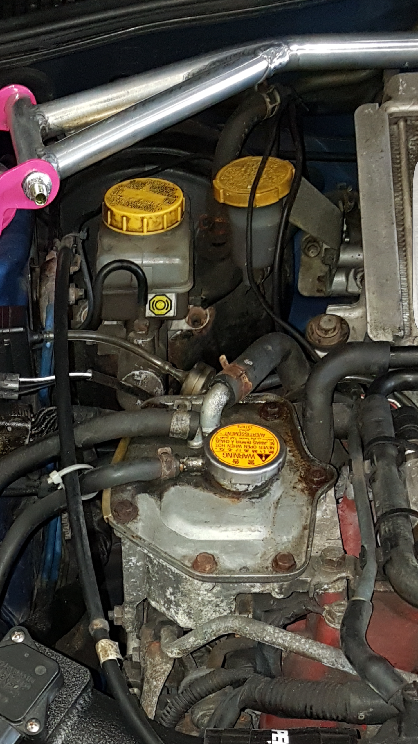

What is this ?
Rps
3 hours ago, Tidgy said:
Can always take it of and give it a clean (sand paper etc) give it a coat of old rattle can (block up the holes first) and put it back on, save yourself a fortune
Agree either remove the top plate or alternatively the whole tank and paint it. I removed the whole tank and painted it black using red lead undercoat. A word of warning if you do remove it the hose attached to the filler cap on mine was very stiff to get off been on since day of manufacture and ended up snapping the filler neck off. Flea bay replacement cost £25 for the whole tank.
