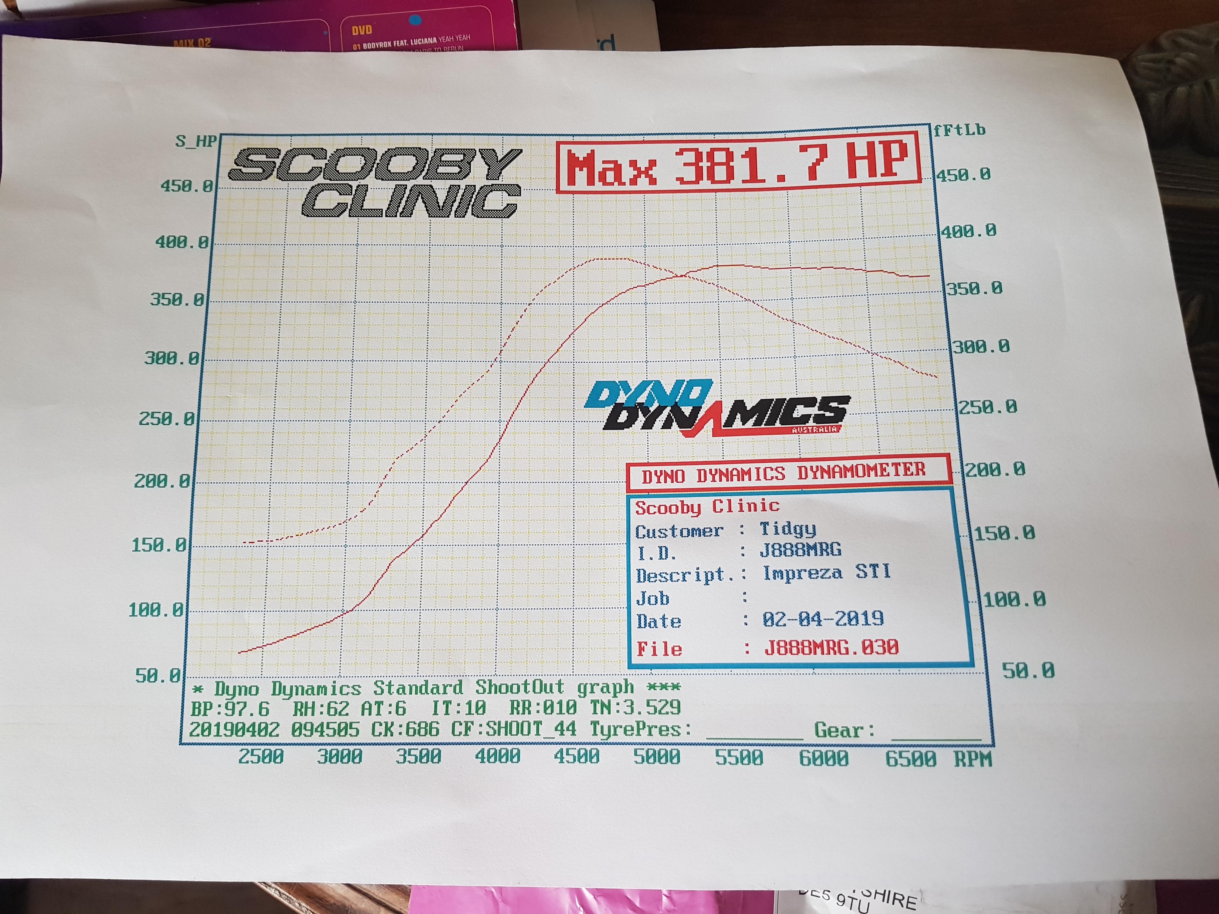

So its fitted and mapped. And bejesus does or go well.
As expected it's being held back spool and top end by a few things, tmic, headers and sports cat to name a few. But man I drives well. Low down its happy as Larry just pootling round, then when  it comes on boost all hell breaks loose and it just fecks off, and keeps fecking off right up to red line.
So in the end it made 381bhp and 390ftlb, on 1.4bar 😮
Given it's a 500+ turbo and being limited it's a pretty epic result with plenty more to come.

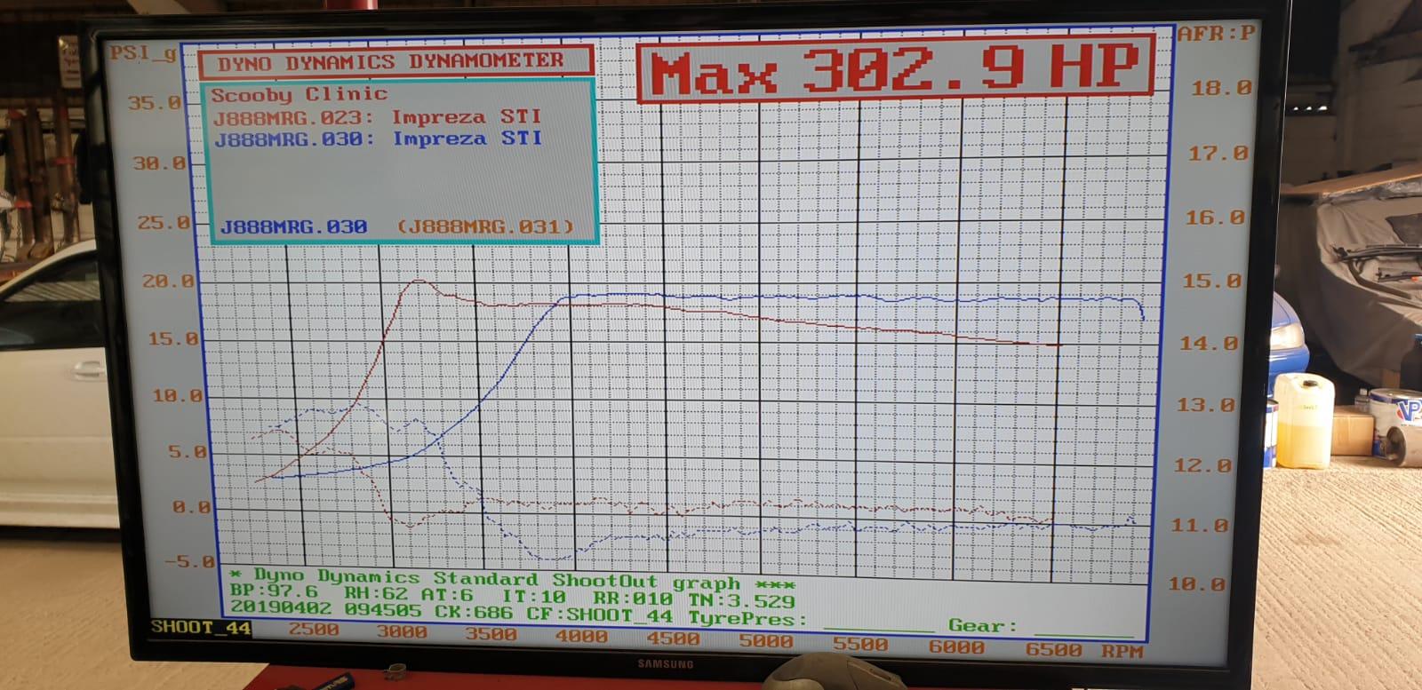

So interesting comparison, red is vf43 blue is the new sc46x.
The vf43 was maxed on my car, the sc46 is on low boost setting, 1.3 with a peak of 1.4 on the road, pretty east to tell it's not even trying as there pretty much no boost drop off haha

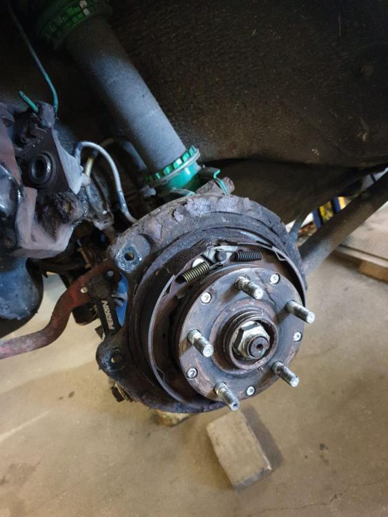

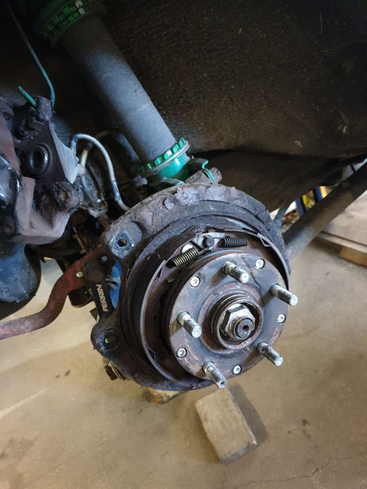

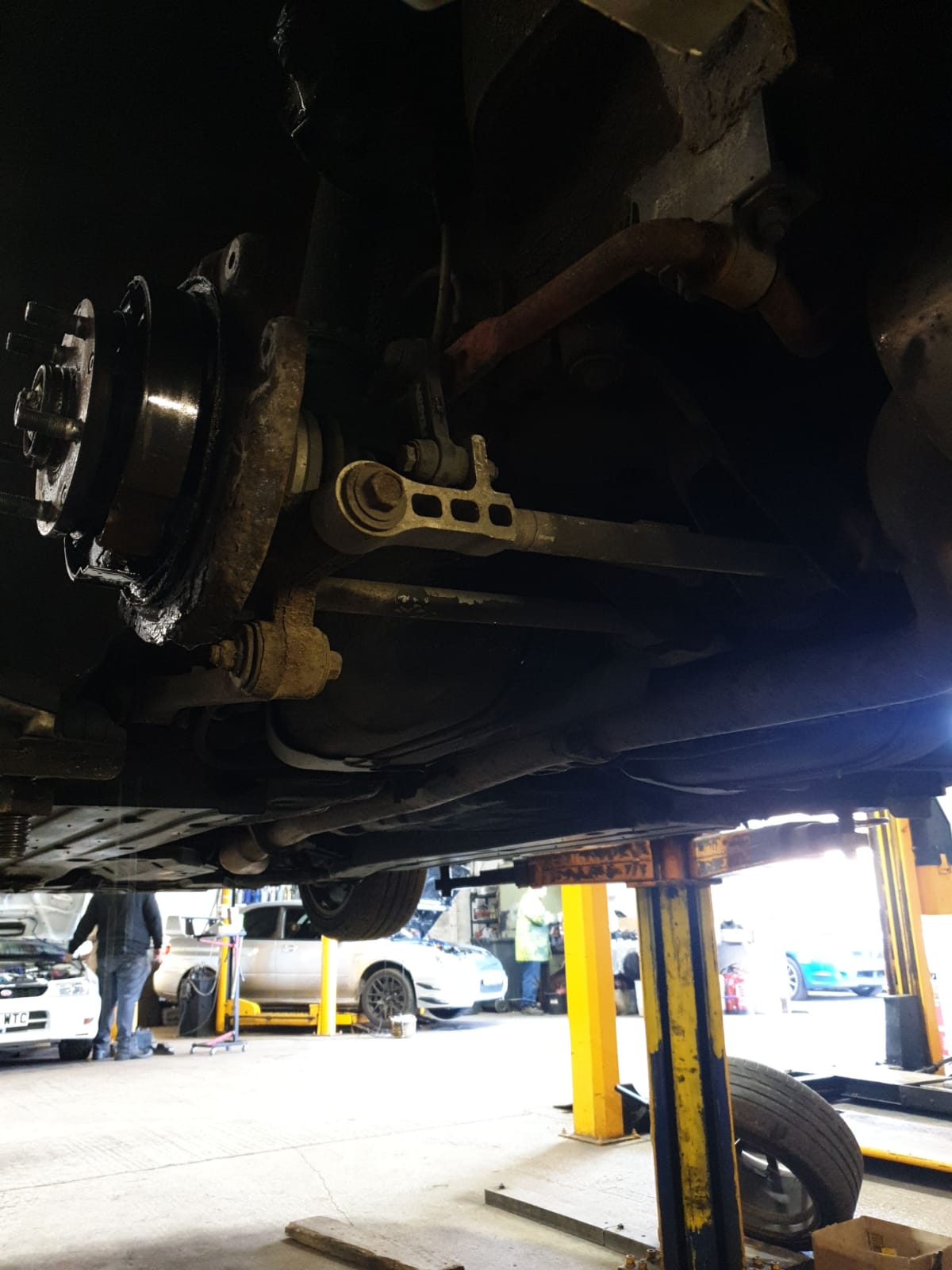

Bit of an update,
Rear end of the car has been stripped down. Given its a 13 year old car its in pretty good condition, surface rust but nothing that wasnt expected.
Replacement parts list,
Rear backing plates
Rear wheel bearings
Rear lower bolts (shall show in pic below as im not sure what the exact name for it is)
Wheel speed sensor tbc (i spoke to them sat and they hadn't tried to get them out at that point)
New handbrake assembly parts (shoes, etc)
New rear brake pads
New rear brake disks
Rest of the parts are being given a dam good clean. I was thinking about painting the hubs but water can get under the paint when it gets chipped and make the rust worse so they are just being cleaned up.
Few raw pics as they stripped it down.
Nice and crusty rear hub, just needs a good surface clean but nothing wrong. Bolt between the two bars on the other hand does need reaplacing (as mentioned in the list above).
The backing plates are delaminating in layers with rust and as expected need replacing. Rest of the parts are borderline needing to be done so make sense to do it all while its appart and just the cost of the parts.
Shall update with some mroe pics as it's put back together

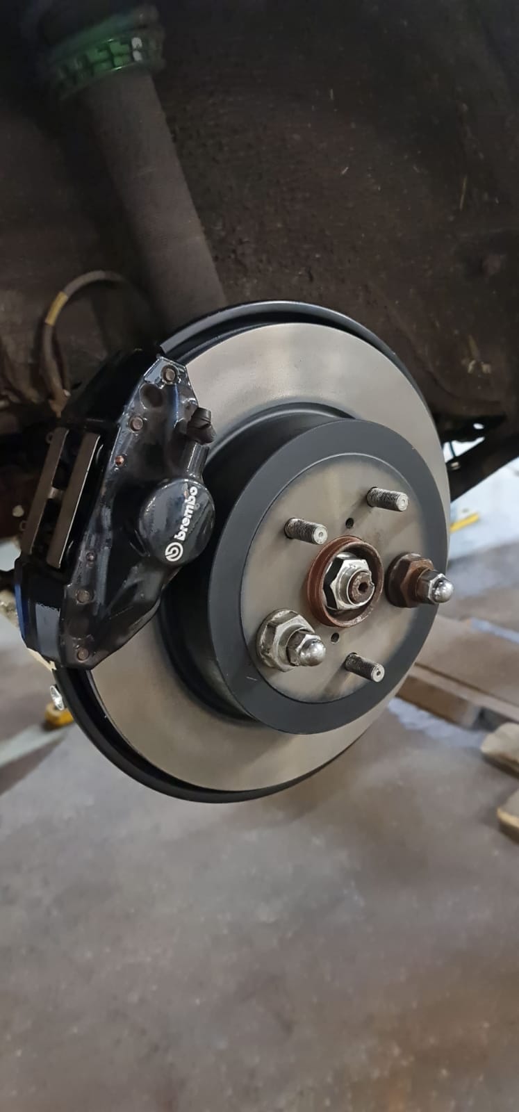

I had the replacement backing plates powdercoated as the paint was so thin and just unwrapping them caused some undercoat to show - hopefully they will last a bit longer than as standard
could do, time will tell. hubs are pretty solid chunks
one side done, other side is waiting on a bolt. wont know if the sensors are ok untill they road test it.

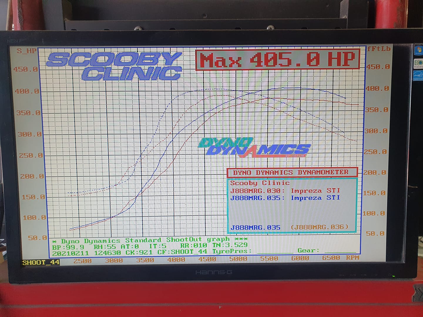

So got back from clinic, and just about thawed out, duck me it was cold lol
Results are in and I'm pretty pleased with it.
The boost went up slightly (about 2psi iirc, although forgot to get afr/boost graph so will confim) without any input from the mapper, map was generally the same other then a minor tweak in fueling.
It gained 25bhp, 15ftlb and a nice amount of spool.
I'll get the bhp/father graph up tomorrow as it doesn't seem to want to take it straight from my phone.
On 2/12/2021 at 10:33 AM, Jay762 said:
not bad from just a larger diameter pipe
yeah, hoped for a little gain and maybe break 400, although wasnt expecting it too 😄

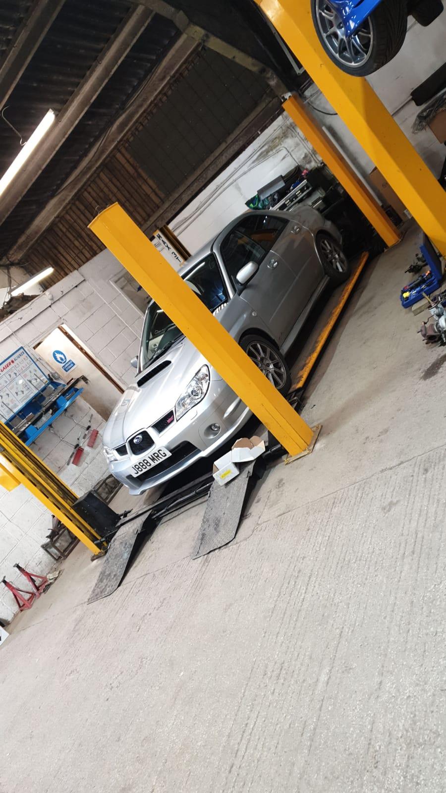

Well balls. Went for its mot yesterday and failed 😞 sills need doing.
So back on a flatbed and off up to clinic for some tlc, I can't imagine this is gon a be cheap 😞
