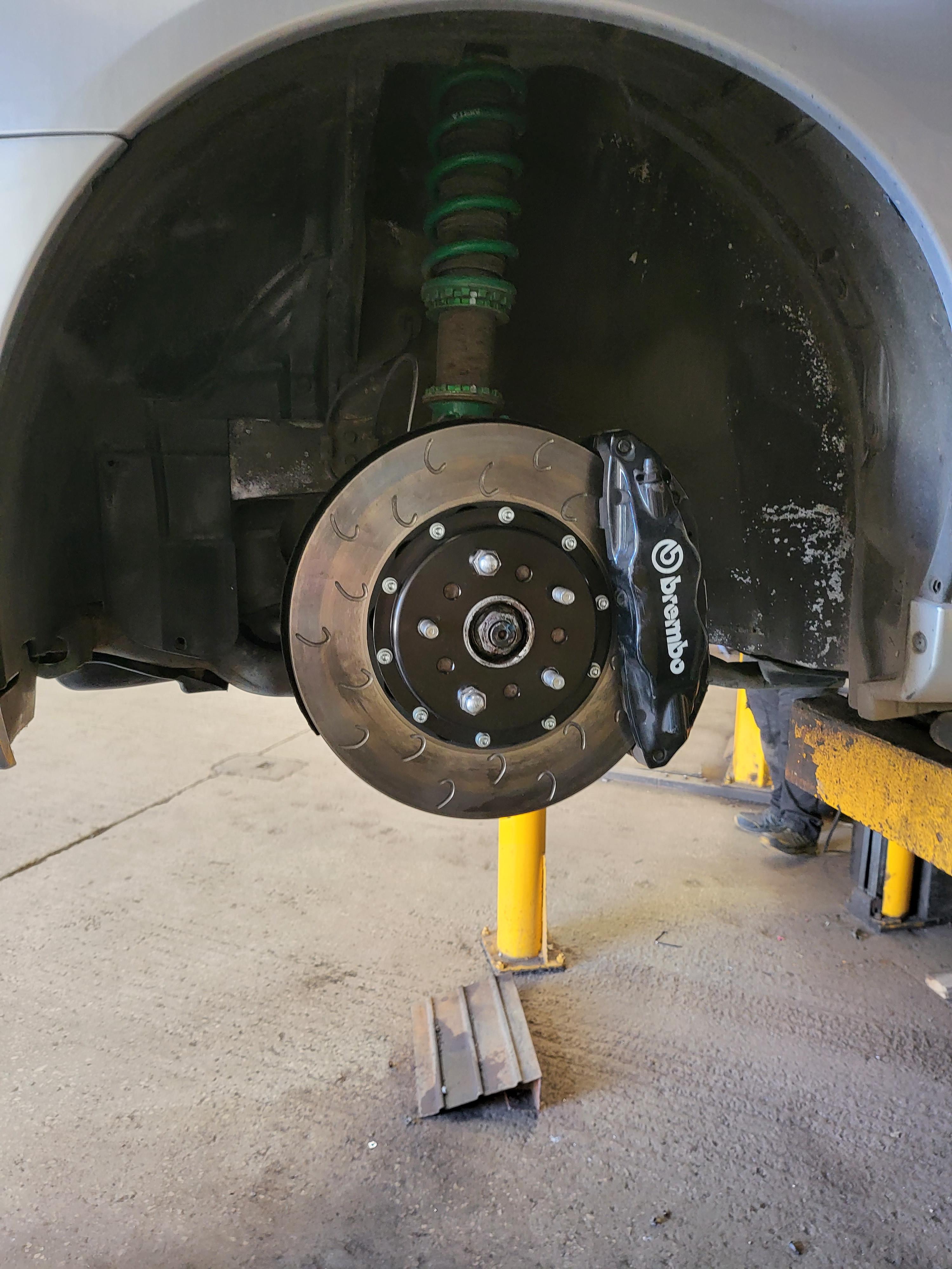

Bought a set of godspeed j hooked floating bell disks and KL rc+ pads and went to have them fitted and after all in (amazingly none of the bolts snapped or anything 😮 ) and once on, they were binding. bit of investigation and found the offset appeared to be 1mm out, which was enough to push the disk far enough back for the pad to not clear the disk when the brakes are off. Few phone calls to Godspeed and they are being returned for a refund (can't fault their customer service so far, not had refund yet as they are on the way back).
Ended up with some blueprint disks and the KL, which i was warned squeek like a ******, and they do,  so need to decid what to do about the disks now :S

Disks were returned to godspeed but no refund arrived. When i rang to chase they said that they were damaged during road test (well not reallyt damaged, more marked)so couldnt be resold so didnt want to refund me. While i could have demanded a refund as they didnt fit they offer to machine the bells to suit and then send them back. which i have no issue with, although a bit cheesed off as its gonna cost me labour to get them swapped again.
It's highlighted a couple of things,
1. what initialy caused the issue was the disks are just under 0.9mm less offset than standard disks. Godspeed are actualy gonna change their machining to amend that.
2. the brembo calipers have a pad guide plate on them. Over time rust gets underneath and lifts the plate and pushes it slighty outwards (1mm approx). add the 1mm and the 0.9mm and the 2mm means they bind, personaly i didnt realise 2mm made that much difference.
Shall get some pics up next week when the disks are refitted. I'll try and get some pics to show the guide plate issue as well.

So as above, disks came back after modification and good news for once. Went straight in, no binding etc.
One issue that is well known with the KL pads is they are noise, squeaky etc. The mechanic who fitted them had some liqui moly anti squeal paste to use qnd have to say it's night and day, since the new disks were fitted had very little squeal at all, so would highly recommend the stuff.
