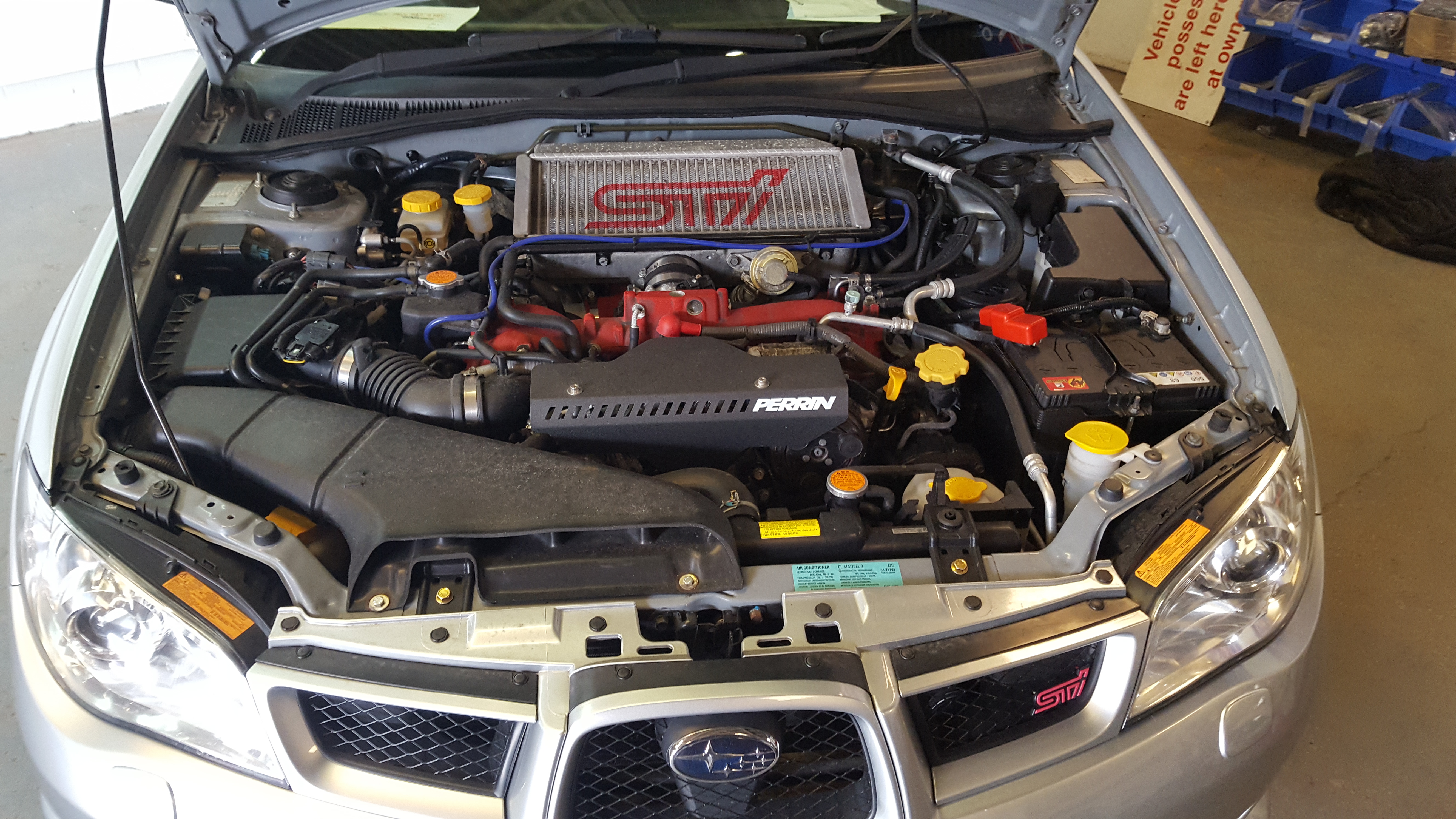

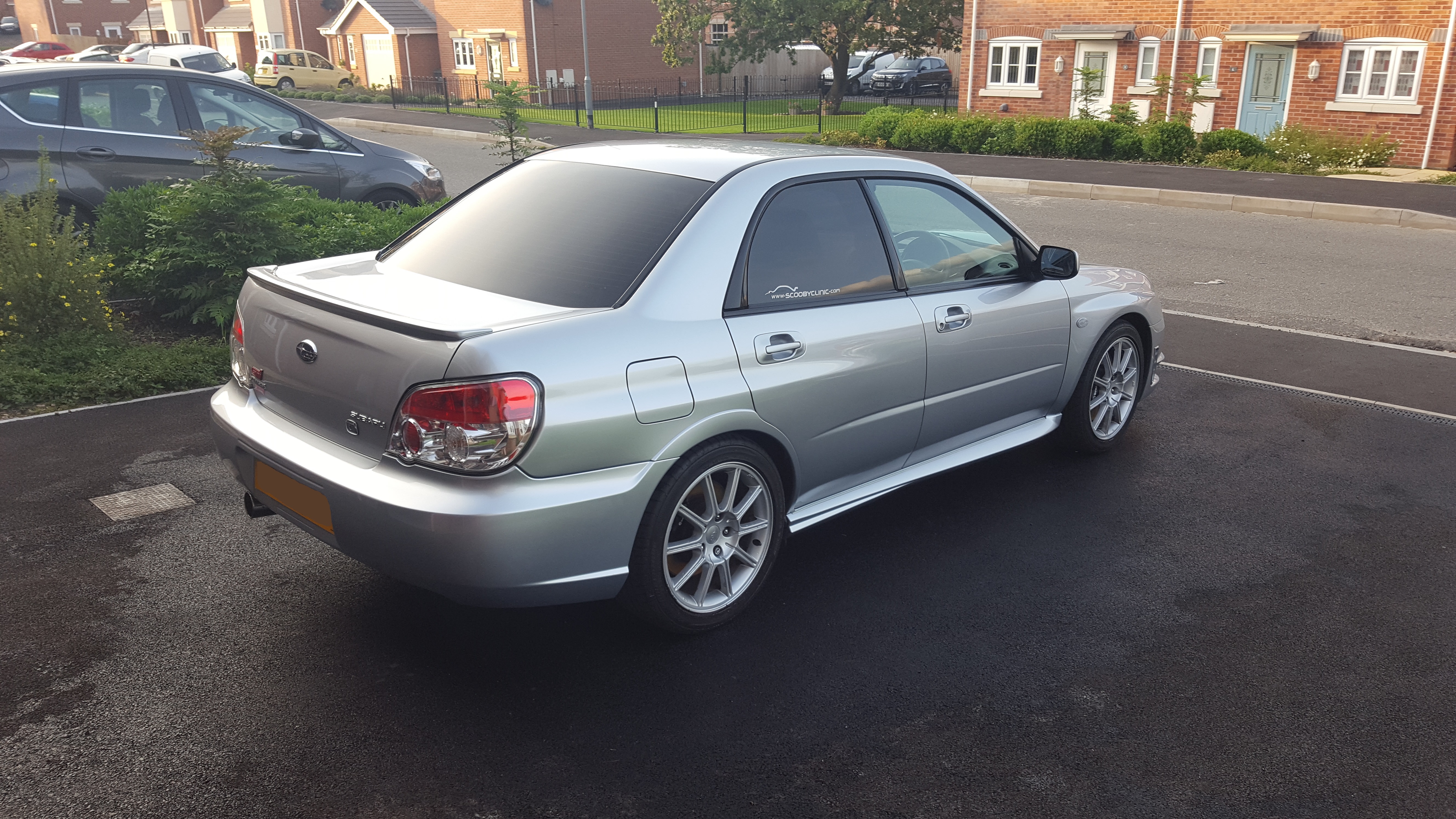

In case folks aren't aware I have sold my Type R and hawk wagon and two weeks ago i picked up my new car. I wasn't gonna be without a subaru of course :D
So here's the new one. It's a 2007 WRX STI Limited. It's based on a eurospec Spec D STI but is 1 of only 25 RHD produced and imported into the UK.
UK spec D is a more subtle STI, same drive train, engine brakes and suspension but with front fogs, leather interior, silver wheels, no roof spoiler and low level spoiler (WRX spoiler), also only come in silver.
STI limited is closer to a spec D than normal STI, but it has black painted brembo's, later revision engine and gearbox, A line lip spoiler and S204 black centre console.
Car has 63k on it and i found out i know the old owner who has really looked after it so well chuffed.
It's already had a couple of mods, Remapped to 340bhp 370ftlb, perrin belt cover and back/rear window tints.
So far I've had a few things done, full detail and ceramic laqure applied, pedders suspension, Uprated drop links all round, rear anti roll bar, front castor kit (also acts as an anti lift kit) and braided brakes lines and a sony DAB headunit.

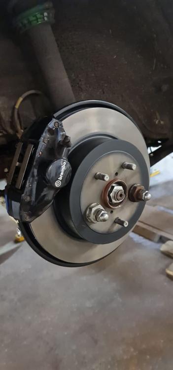

  • Not been much of an update for a while now as it's hardley moved for 10 months. Been dropped of at scoobyclinic (again hahaha) for a few bits.   Rear brake backing plates are rusting through

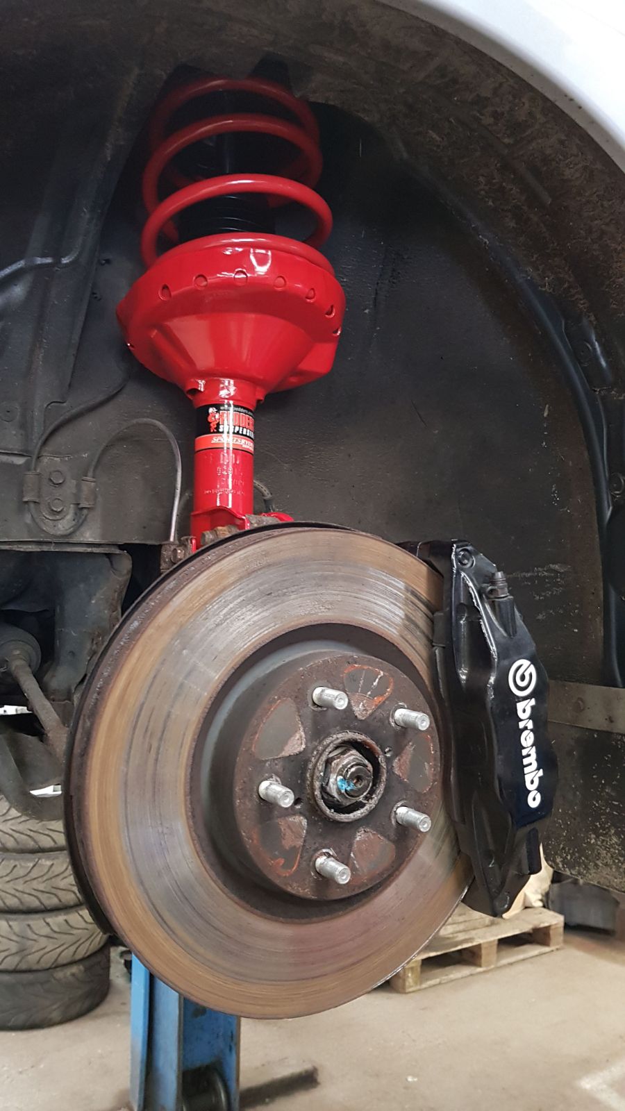

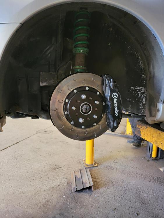

Been having issues with noisy and knocking suspension from the pedders on the rear end. Top mounts were found to be at fault so they were replaced. The new ones were even worse so a full set of rears were ordered and fitted. Problem still persisted so its been decided to replace them with a set of Tein Flex Z
http://www.tein.co.uk/product/flex_z.html
Have to say im pretty disappointed with the pedders and wont be recommending them to anyone.

Small update, new suspension is great. Quieter in general, doesn't knock and rides better (less crashy and less bouncy).

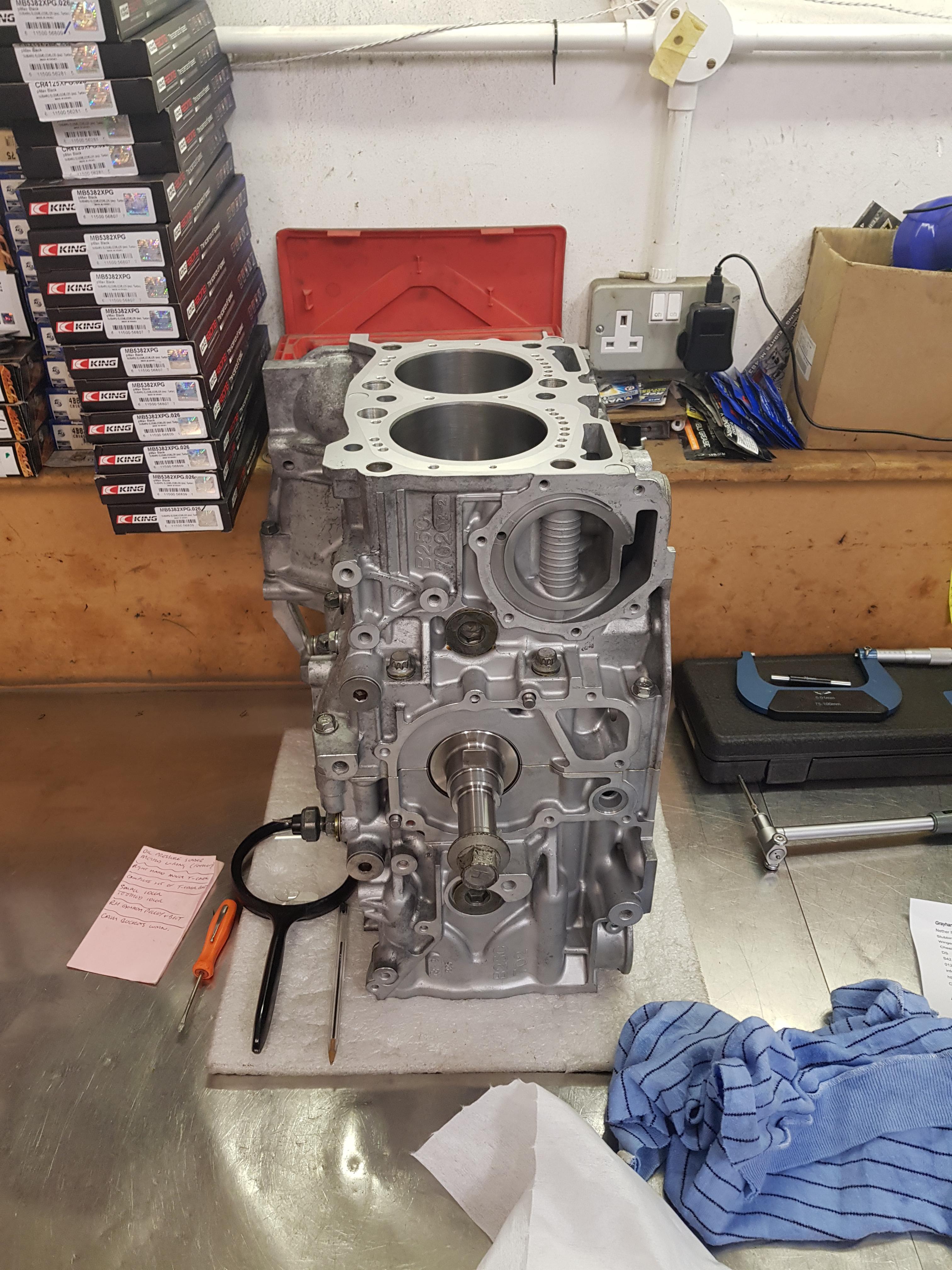

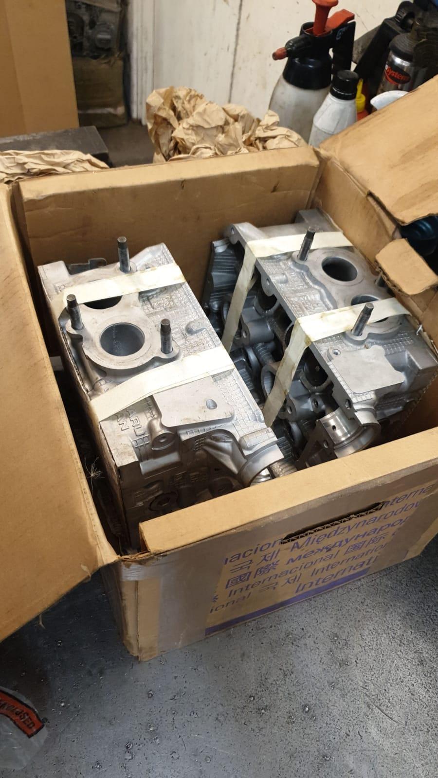

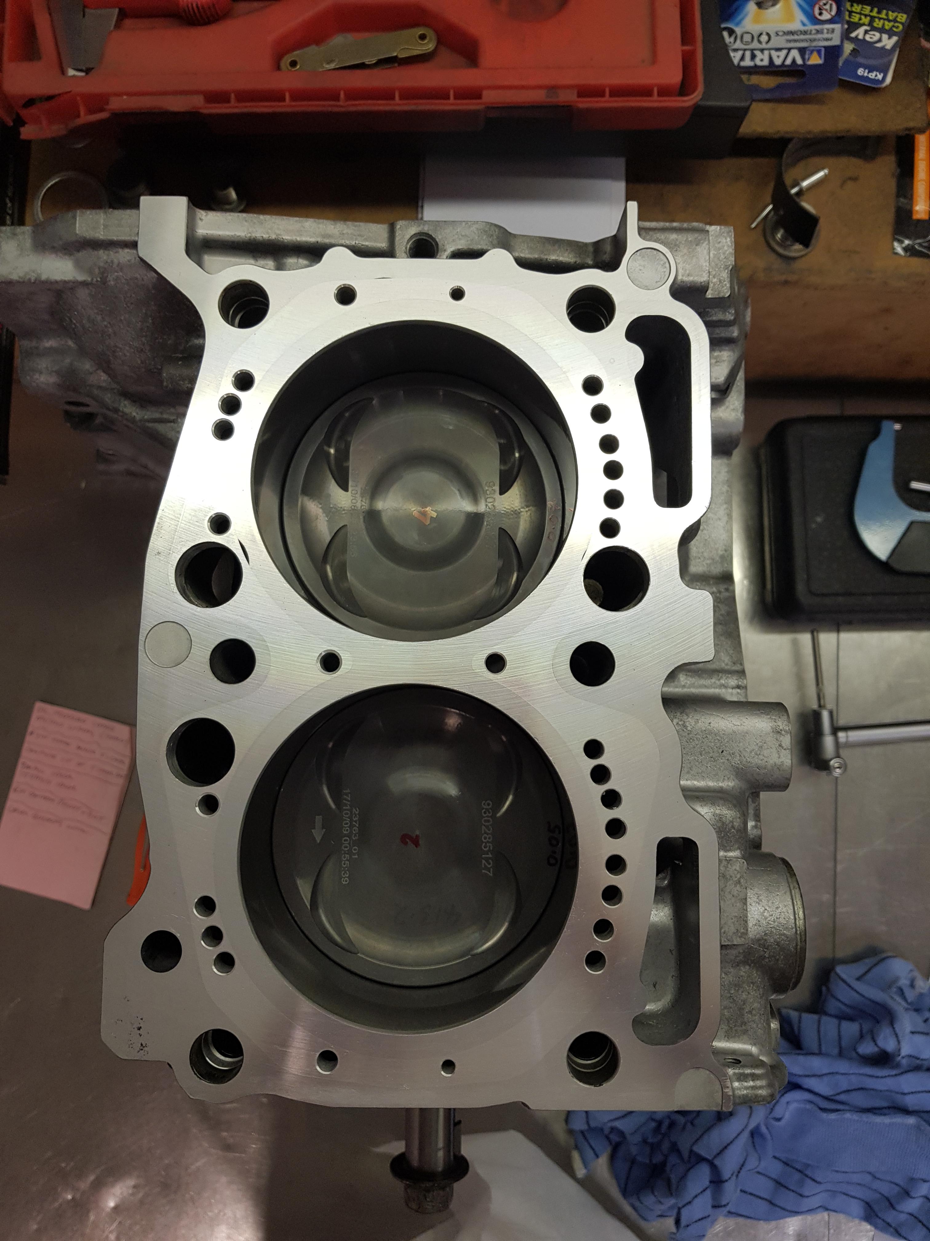

oe pretty big update. Finally a couple of box's arrived back from the machine shop 😄
Wasn't expecting much to happen for another couple of weeks due to not being first in build que, but poped up to clinic today to say hello to be greeted by this,
So looks like unless something crops up it should be back in the car and all the new bits bolted on and ready to pick up to run in in a couple of weeks 😄
So bit more of an update.
20180908_110932.thumb.jpg.4b8991cf2c7d2ff54d759bdc8da31899.jpg20180908_110920.thumb.jpg.761204650301b99273f864cd3ddcbc80.jpg20180908_110912.thumb.jpg.597282a22fc4d2d40ff9ed6cc3286d1d.jpg20180908_110904.thumb.jpg.33d036b158d732c67eb5dedb708a6967.jpg

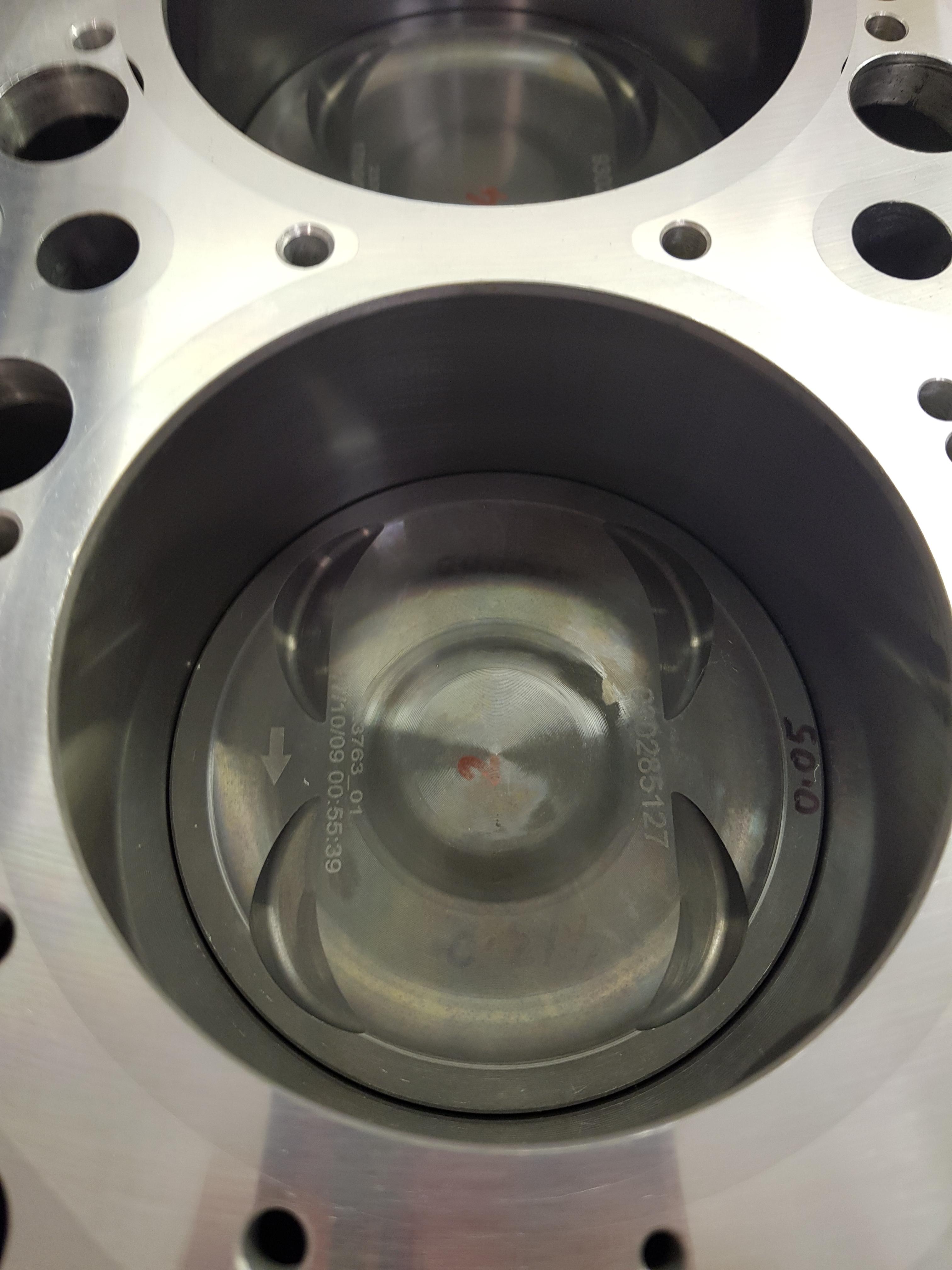

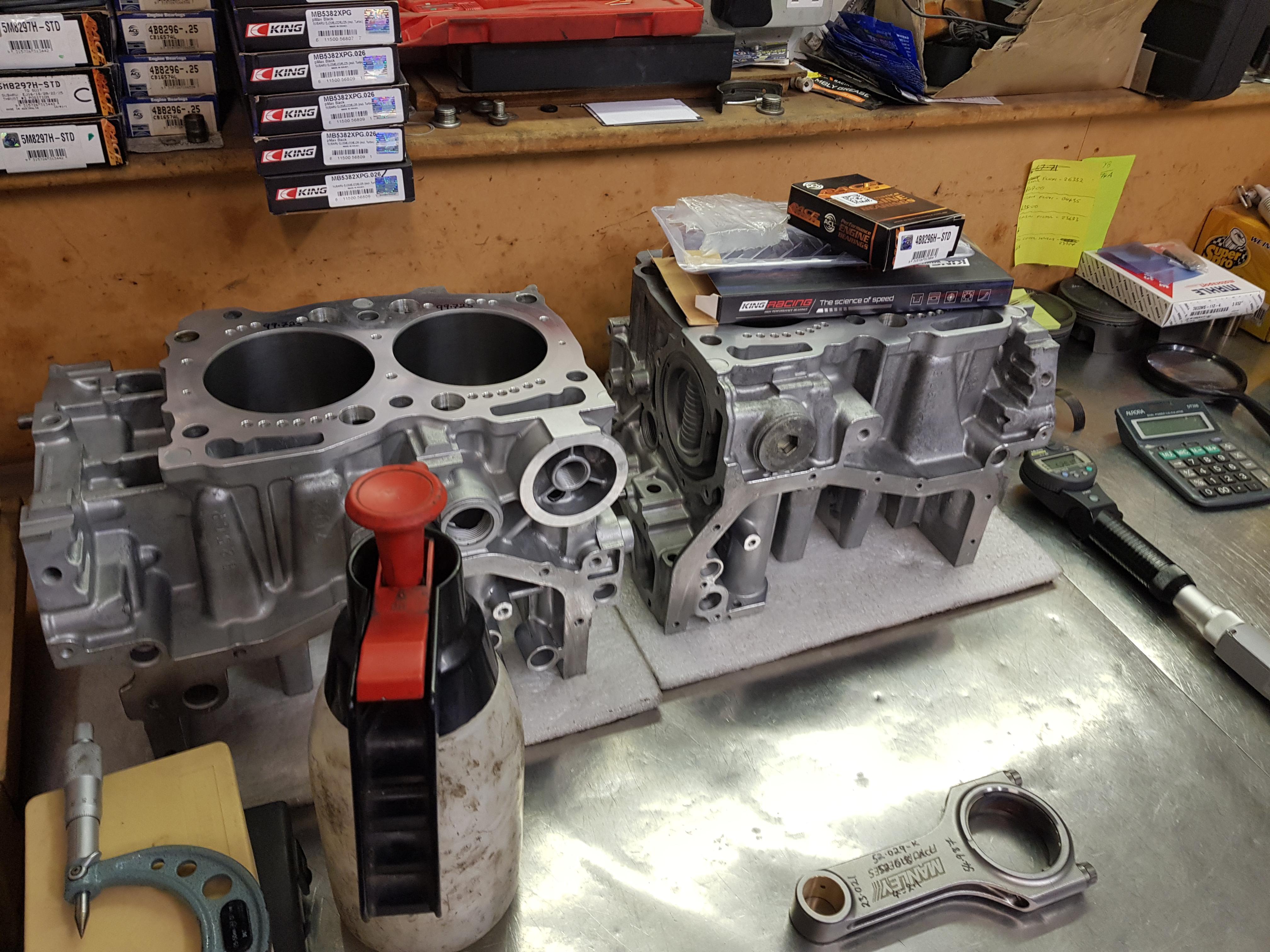

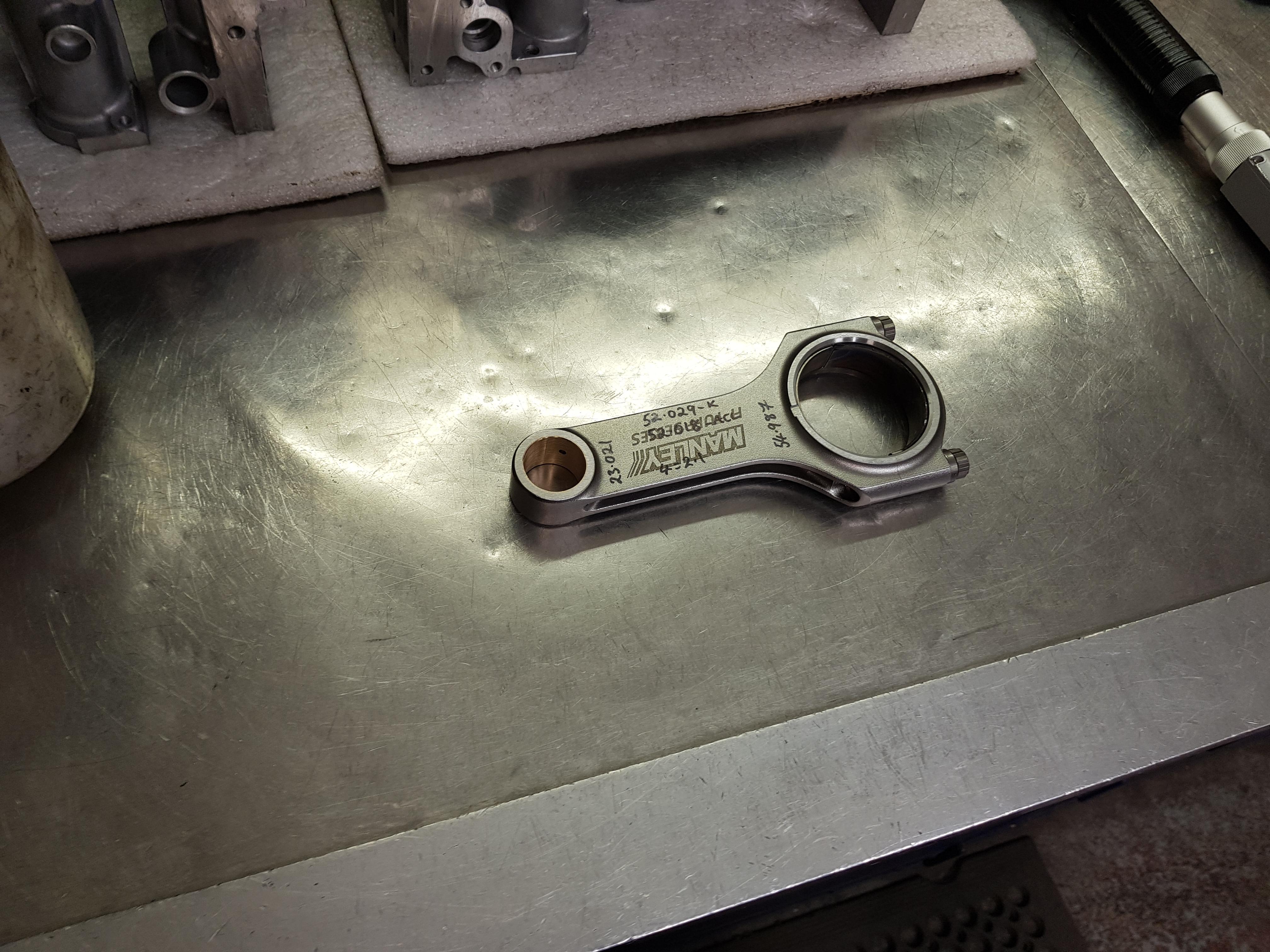

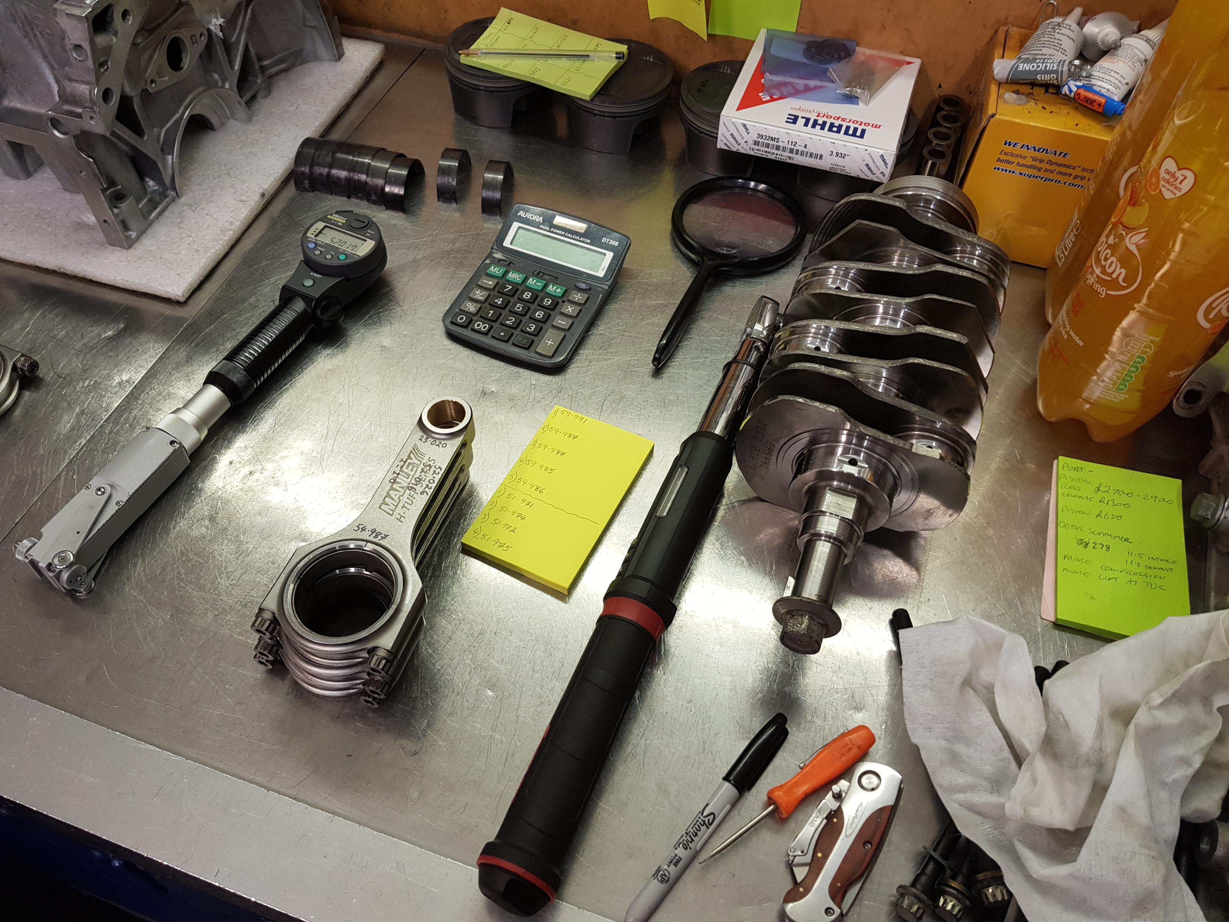

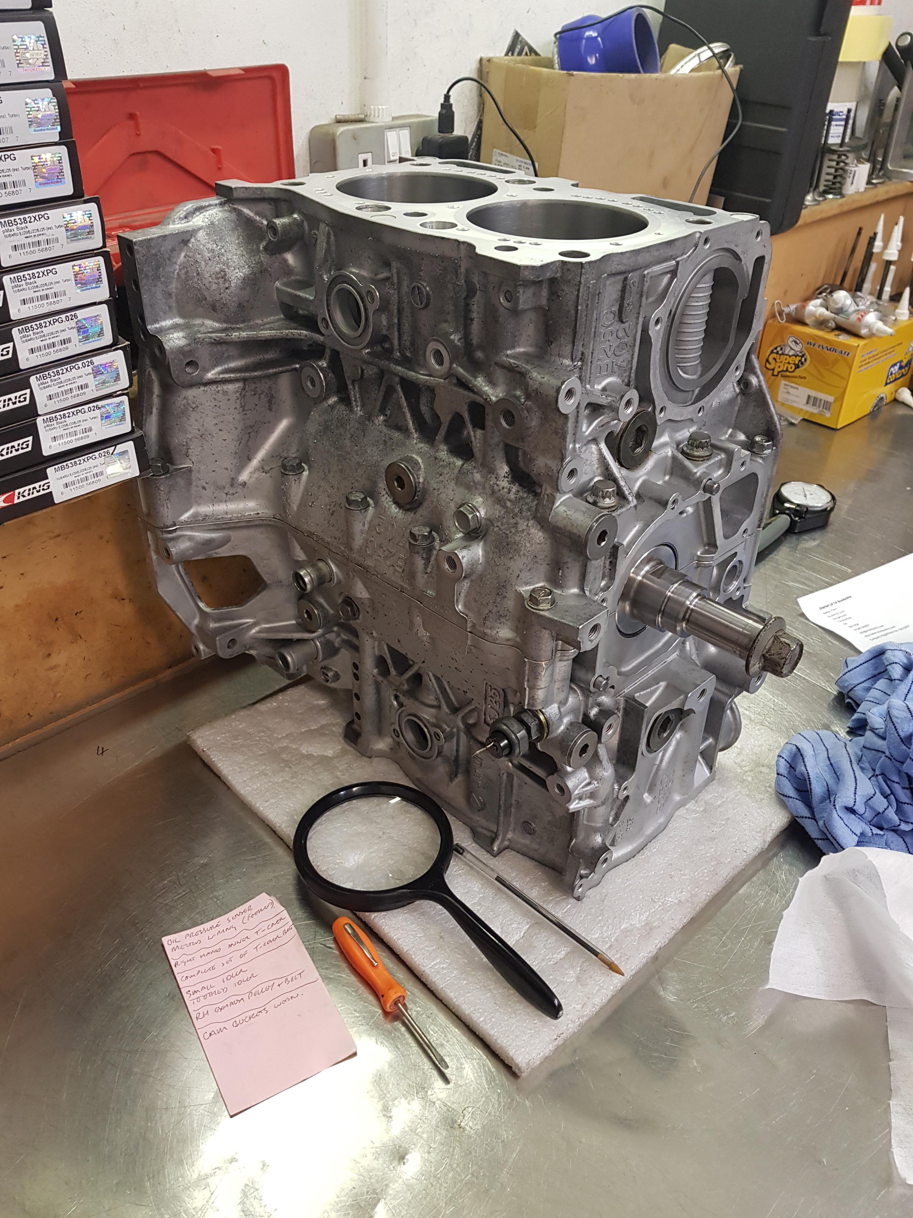

Slight delay due to what appears to be a faulty rod. Crank/rods were mock assembled to check tolerance and the rod bolts seized. Very strange as they have used the same method for hundreds of other rods and a replacement set for mine and no issues :S
So short blocks is ready to go 😄
