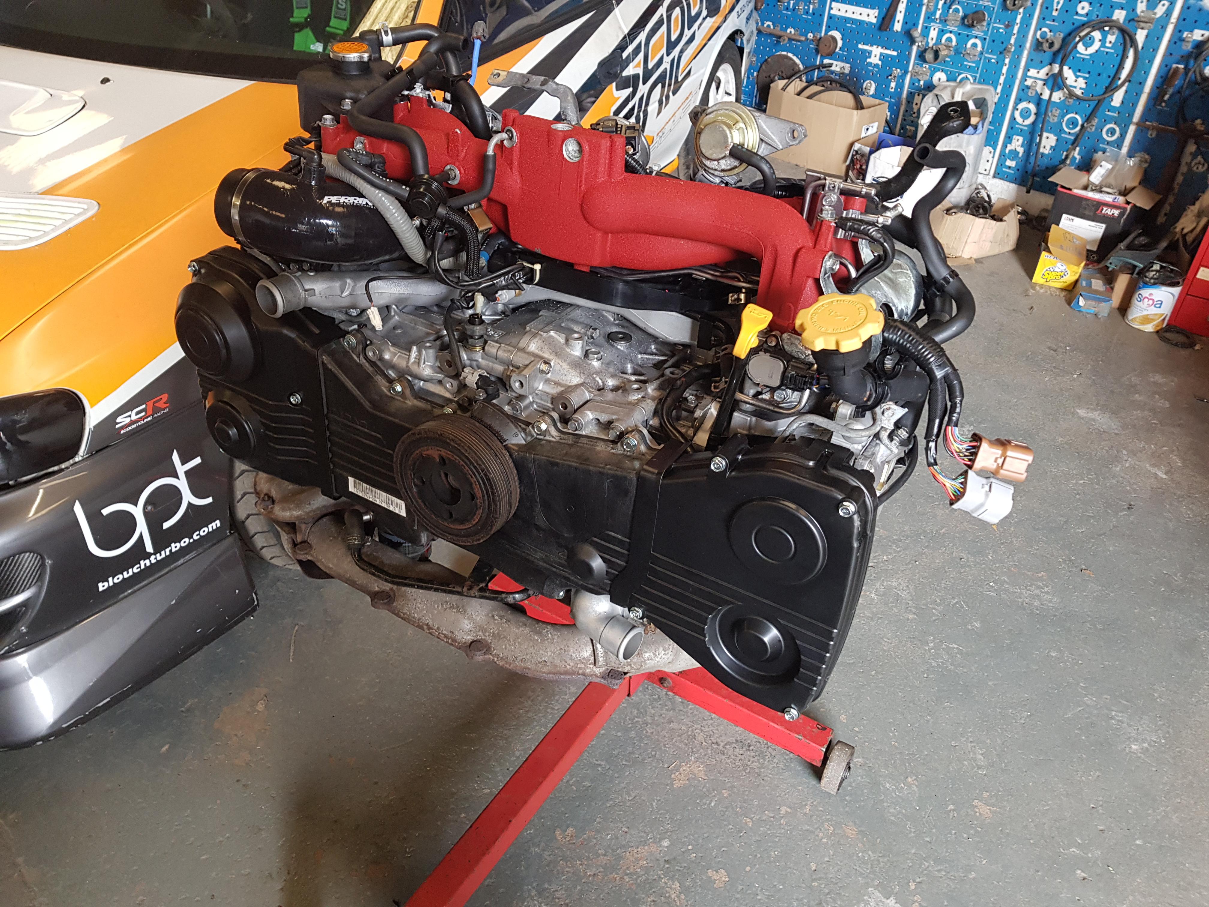

Engines now built and ready to go in the car, although ginna have the crabk pully repainted as it looks meh.
Looks like it maybe ready for next sat but im busy so cant pick it up till thr week after 😞

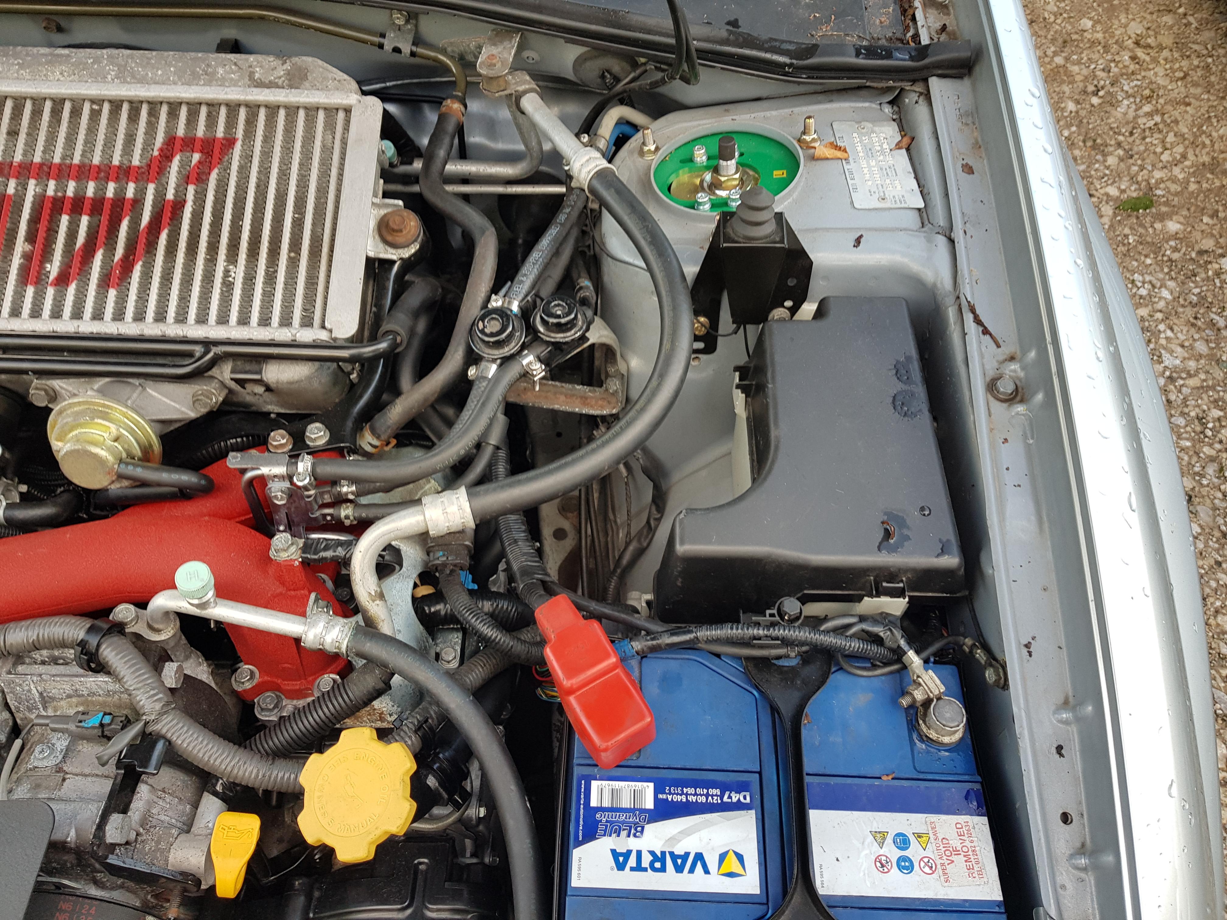

Looking good mate. Who needs to be able to see out of the window anyway 😄
6 minutes ago, Tidgy said:
washer bottle is in front and blow the battery 😉
Ah sneaky!
1 hour ago, Tidgy said:
where it is on the hawk 🙂
thats not whats missing hehe
Oh really? Didn't know they changed location of it for the 2.5
yeah they had to make way for some other crap that's now been removed.

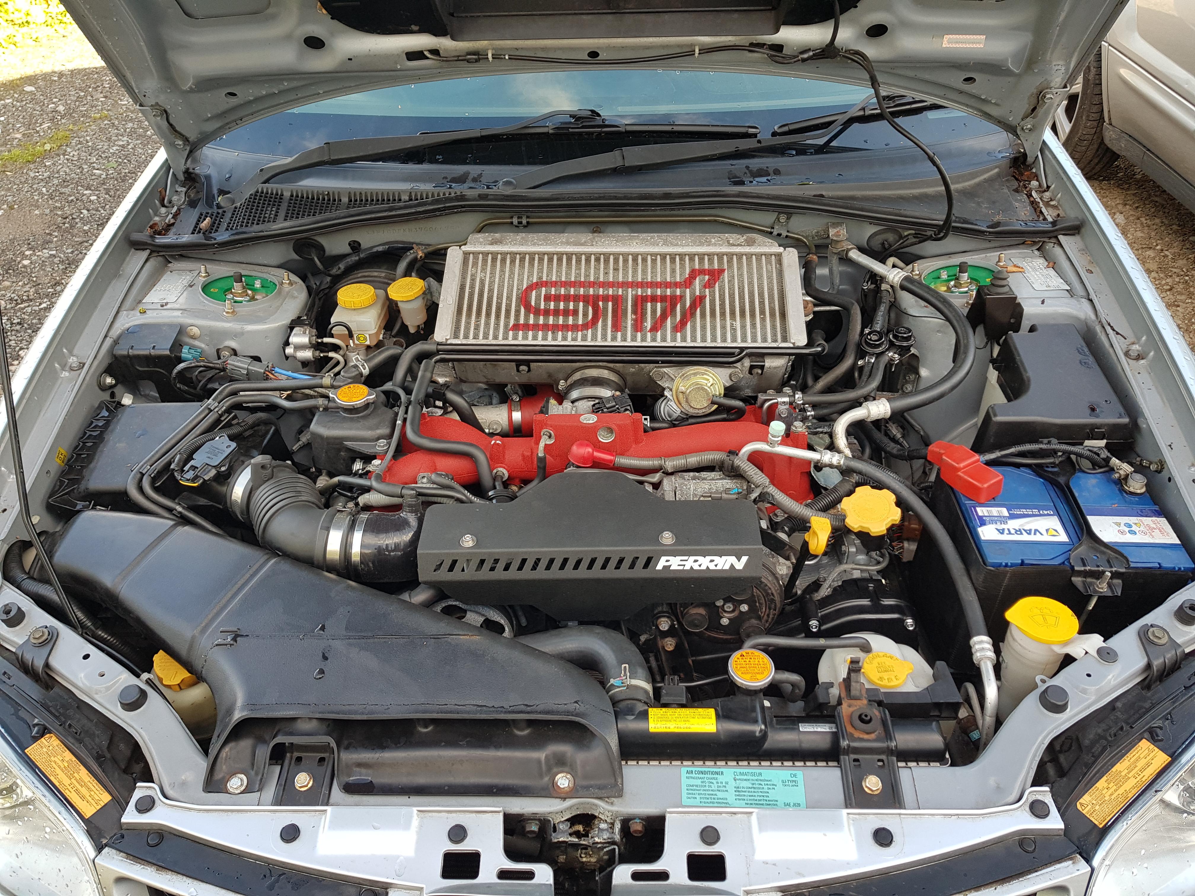

Finally managed to finish the running in and now cars dropped off at clinic for few bits and finishing off,
Oil Cooler
Geom
3 port
map
hopefully have it back next sat 😄
Onto plan B, dropping syvecs for now, price was gonna be more than expected due to sensor pack and also delayed things time wise which i can do at the min (need my car back for work by monday)
So cars done and i picked it up 😄
Managed 330bhp 360ftlb. Pull really strong all the way throught he rev range 😄
Forgot to pick up the graph so shall get that next time im up lol
Turbo is maxed and injectors are at 95% so next step in a few motnhs is prob gonna be swap those out and remap to see what it gets too

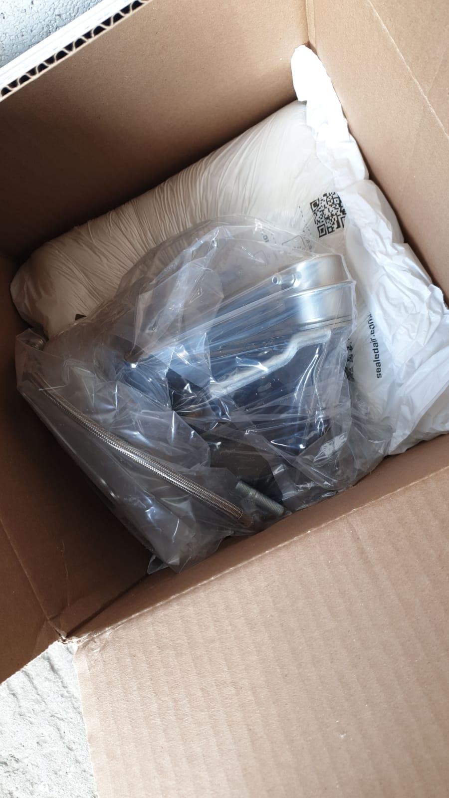

So, over night (that wern't so overnight) parts from america have arived, mianly a nice white box about a foot square 😄
Injectors have been done and existing turbo removed, should just be acase of fitting new turbo, and reassmbling all the other bits and its ready for mapping next week 😄
What kind of power are you expecting/hoping for?
honest answer is not entirley sure. turbos good for the full 500, so gonna be limited by a few things, TMIC, standard headers, ecu and clutch. in theory around 400ish depending on what those cry enough at.
Oooo shiney bits, nice me like 😎👍
