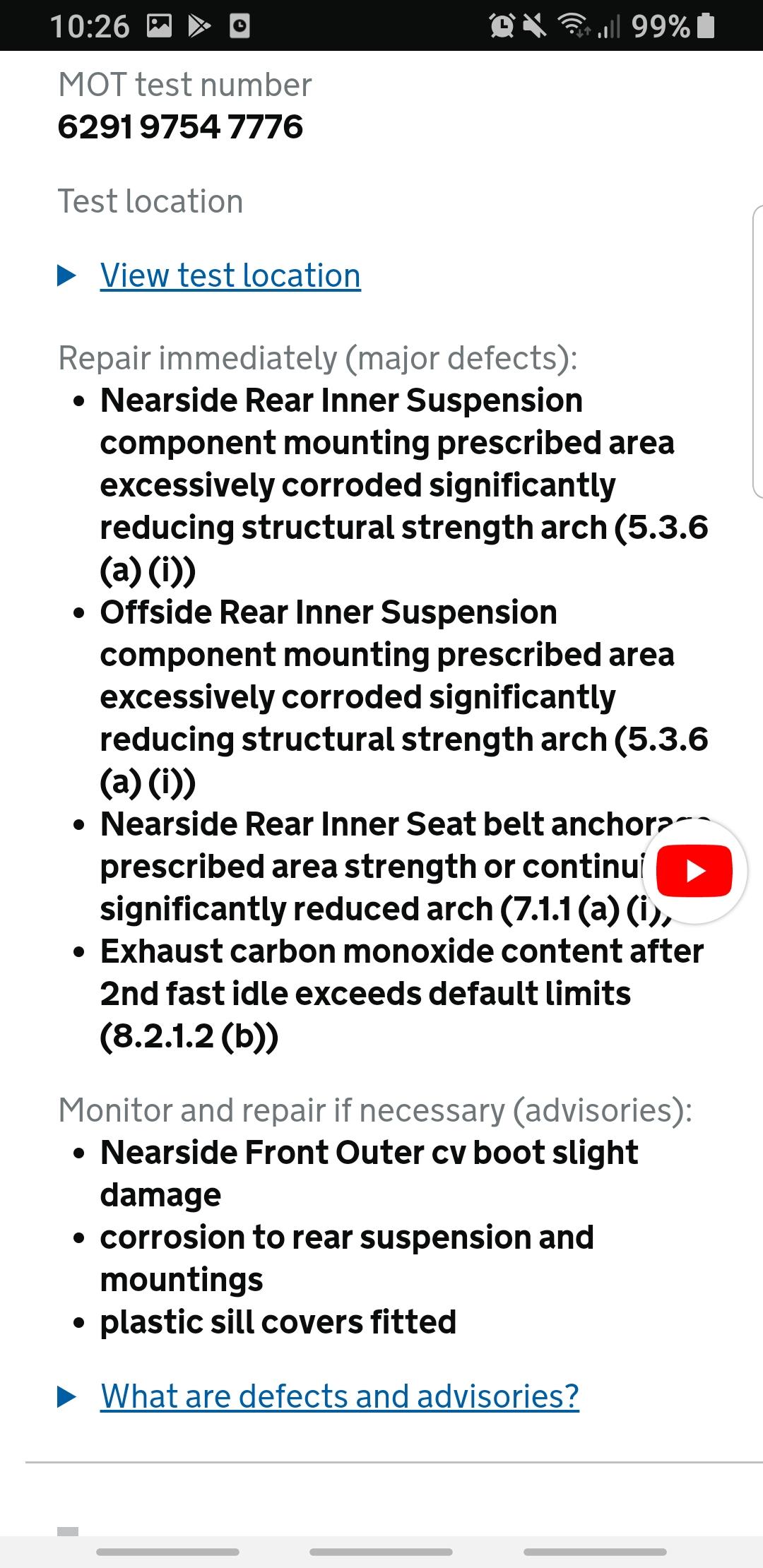

Cheers lads appreciate the advice, I'll just keep looking around I'm not really up on any of the mechanical side so.ill just have to use your advice best I can an hope i land a goer, so not messed with much matching tyres evenly warn  check around exp tank, service history etc, cambelt w pump n idlers, only thing is if I did see one slightly modded most of them I've seen are in used car lots cant see them knowing if it's been mapped? So say for whatever reason I picked one up that had rust issues is it a disaster?
757215926_Screenshot_20191115-222609_SamsungInternet.thumb.jpg.380410c30204cc69fc588fe23757447f.jpg
One I was gonna look at Monday I'd.guess it's been fixed but doesnt bode well for the rest of it ?

The Prodrive Performance Pack is fitted by subaru so you should expect to see a certificate proving it and as a bonus it’s completely legal. Same with mapping if no receipt then they are lying probably 🤣 That one looks alright in the pictures but again best to see it in person so you can look under it and shove your hand up it’s arches etc to check for rusty. The biggest downside with rust is welding costs a fortune you can get replacement panels fairly cheap if you keep it long term. These cars hold on to there value fairly well
