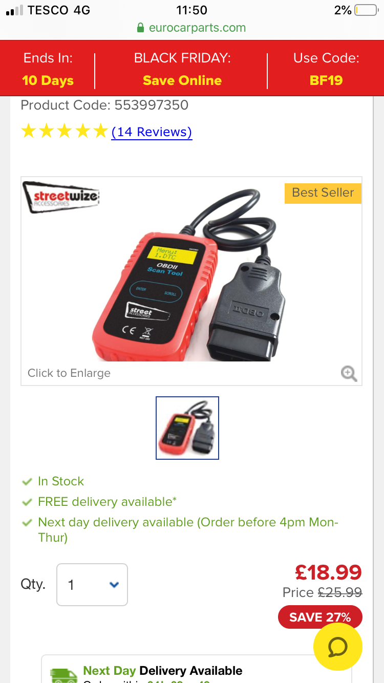

I’d first buy a cheap scan tool you can get them for about £10-15 so you can find out what the code is. I’d guess it’s P0420 if it’s not flashing.
Yeah not flashing mate . I'm feckin flashin though red 🤣 where will I get one of them? Seems to be running fine
I’m sure if it’s flashing that means misfire. Euro mate if you want it now I’m sure you can get them cheaper on amazon

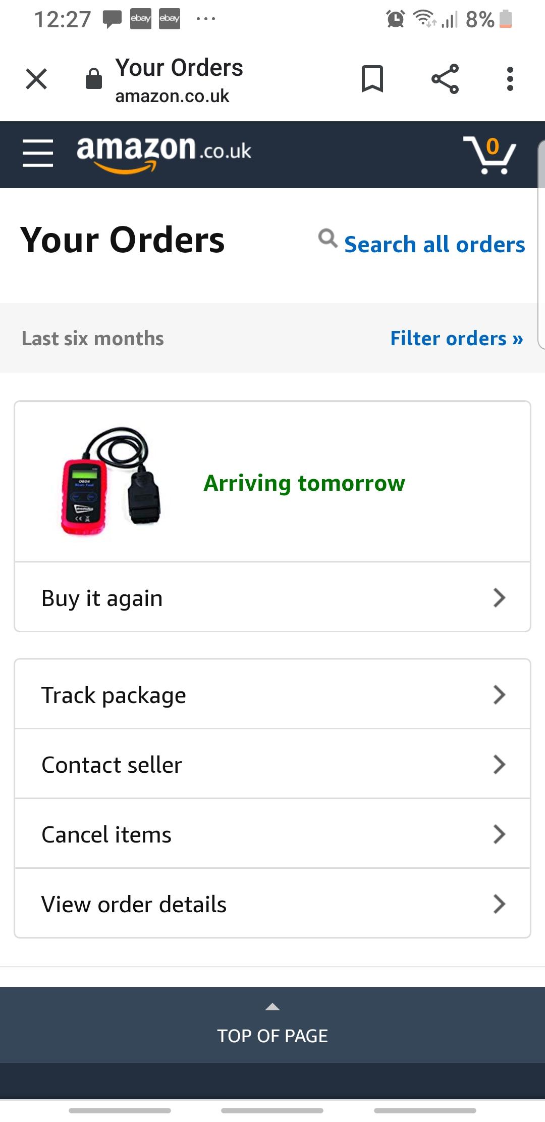

https://www.amazon.co.uk/s?k=obd+bluetooth&crid=2H3XB9B9RQLCG&sprefix=obd+%2Caps%2C136&ref=nb_sb_ss_i_5_4
I bought this one:
https://www.amazon.co.uk/Sp-full-Diagnostic-Scanner-Android/dp/B07RHRMG1B/ref=sr_1_6?crid=2H3XB9B9RQLCG&keywords=obd+bluetooth&qid=1574429367&sprefix=obd+%2Caps%2C136&sr=8-6
and this app
https://scanneranswers.com/torque-pro-obd2-app-review/

Too late mate got that other one now lol, ah well so can I not do much with this one? Been using 97 octane fuel put esso's stuff in then BP's yesterday
