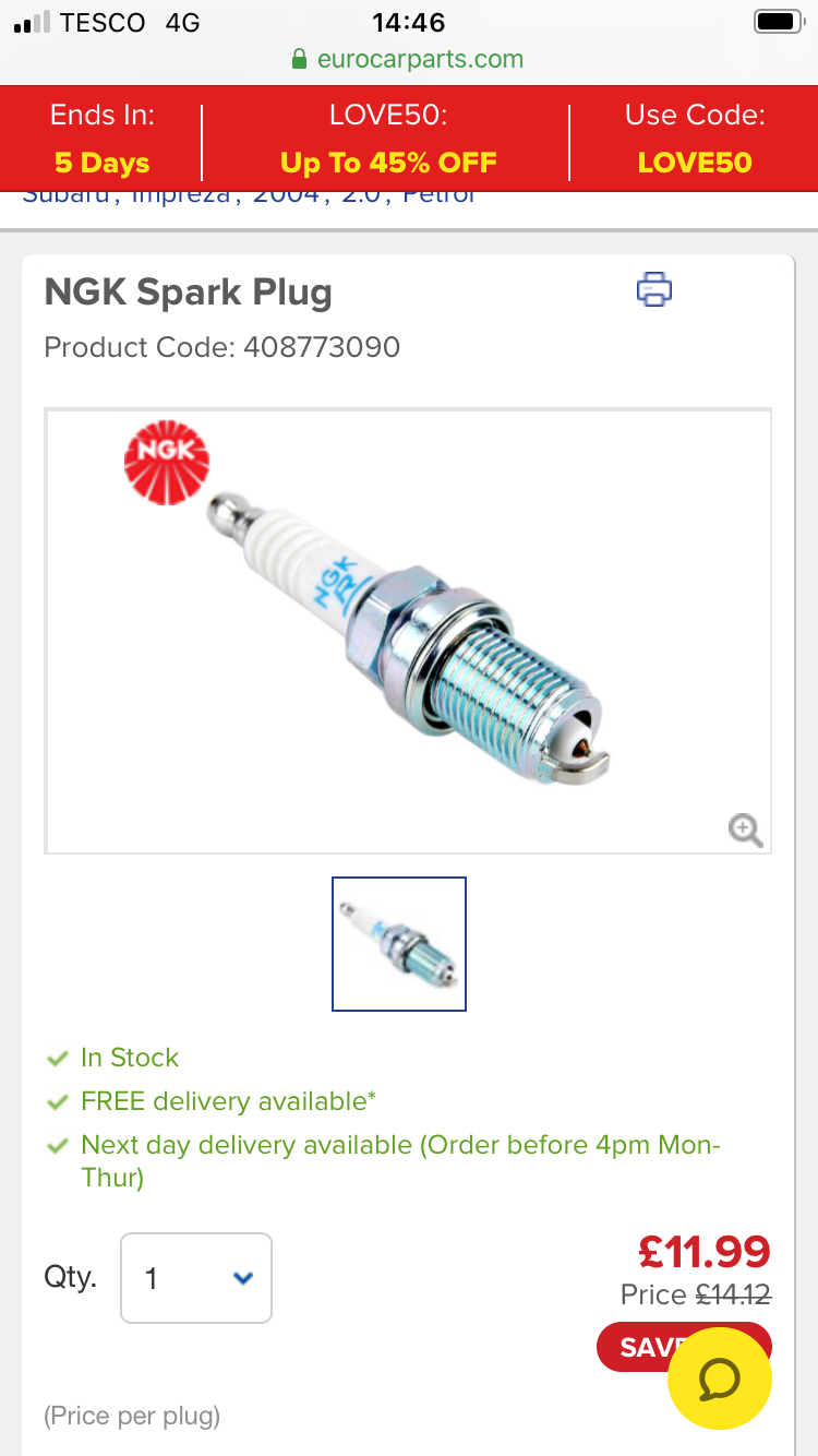

There's 4 plugs mate 2 each side and i think the plugs are pfrb6 but can't remember off the top of my head, they are import car parts for about £35 👍

You can get them from euro aswell mate with there online deal probably about the same price. Stuartie is right PFR6b 👍
