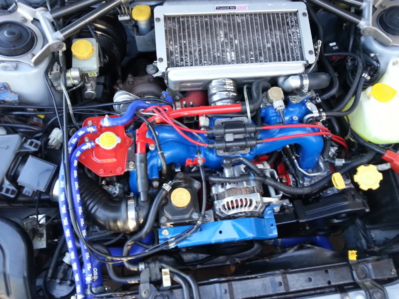

Got some nano drive oil and mahle filter so while doing the oil change I decided it would be rude not to fit some of the new vacuum hoses I got for xmas of the mother in law .
Not much of a visual difference at the moment as I wont fit the full kit until I fit the hdi fmic , but I noticed that some of the original vacuum had become brittle when fitting the engine last year .
before
Spot the difference :-)

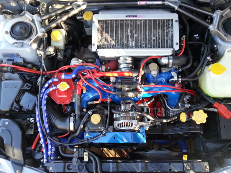

Didn't manage to fit anything today but I did a mock fit of the fmic inlet pipework to check what hoses I'd need to plumb in the recirc .
was going to paint the pipework but the hdi pipework looks to shiny to cover in paint tbo .does look like I'll have to relocate my adjustable fpr as well :-(
Also ordered a 3" entry k&n cone filter as I've found a suitable bit off ally pipework to delete the maff
I won't cut it to size until I fit the fmic pipework (and finished polishing it lol), but it gives you the general idea ;-)
Still got to get the intake air temp sensor and weld a bung into the fmic to inlet pipe and find a second hand 3" decat , latter of which to be like hens teeth at the min .

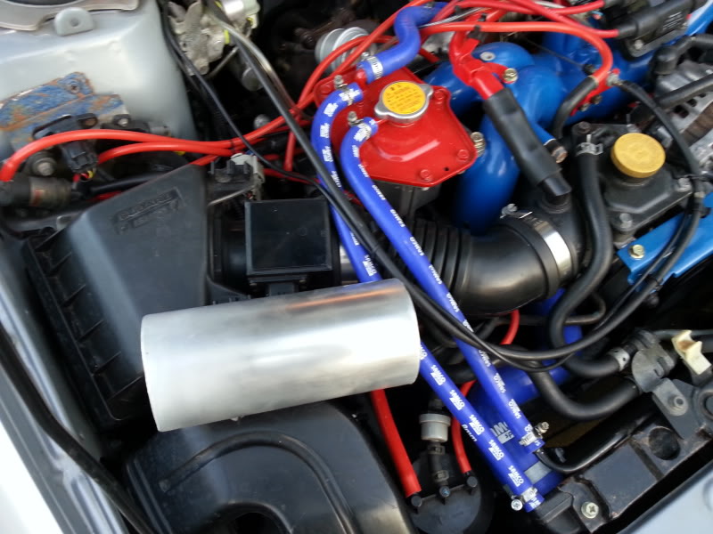

After offering up the 3" dia K&N it looked to big to fit in the bay :-(
I had found some 3" outside dia ally pipe (in the pic above) while working on site. which I had intended to polish and use to delete the maff .
So I thought fook it lets whip the standard air box out and see if I can make it work
Had to keep the ally pipe short (75mm) which means that you can only just see 10 mm of the shiny pipe between the K &N and the inlet pipe .
Took it for a test drive and it seems to spool a bit earlier and the noise is sublime , it's even made the recirculation valve sound louder .
I've chucked a fair bit of money on mods at my scooby but ,think for £42 and 30 mins work it's probably one of the best value for money ones so far :-)
