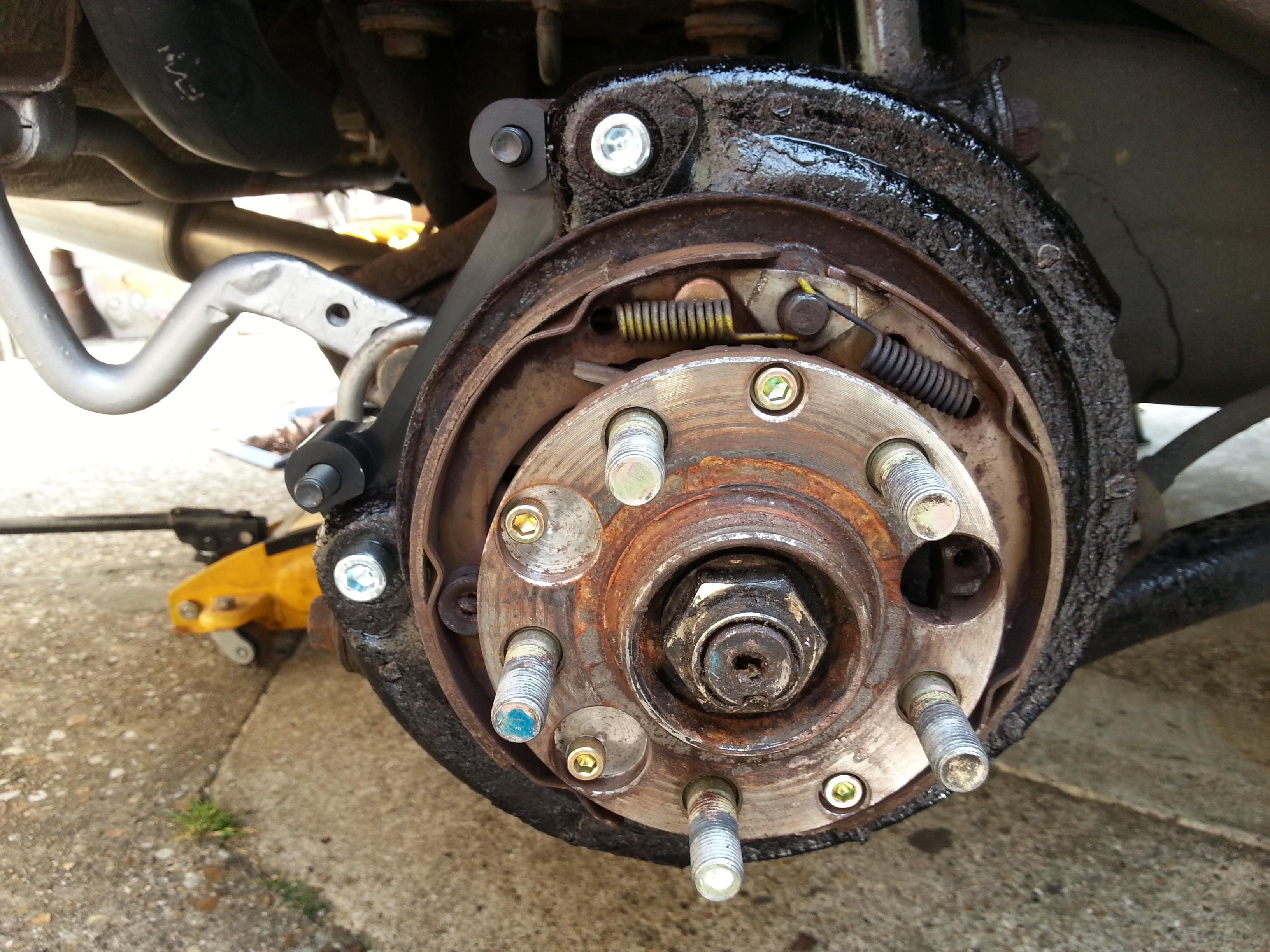

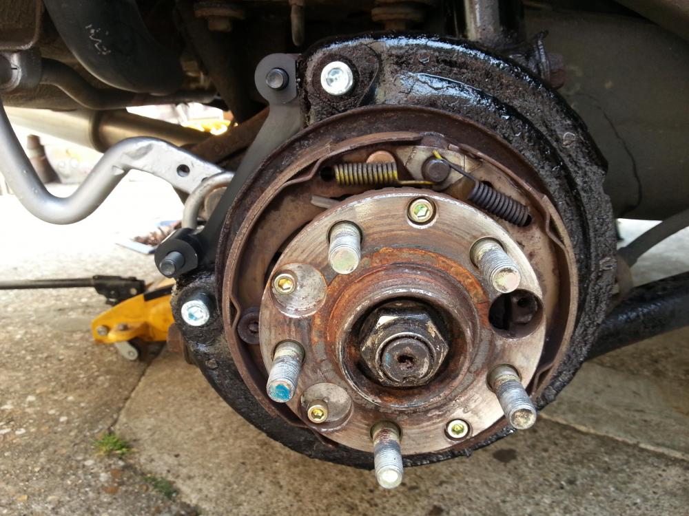

Due to the 2 pot newage rear calipers running bigger discs you have to remove the !Removed! guard's and buy conversion brackets to make the bigger set up fit the classic 160 rear hubs (handbrake shoes are compatible though).
could see it wasn't going to take much effort to remove the !Removed! guard's as they were in !Removed! condition (rusty as fook)
Once removed I gave the hub a bit of a clean up slapped a bit of hammerite on the hub and fitted the billet ally conversion brackets

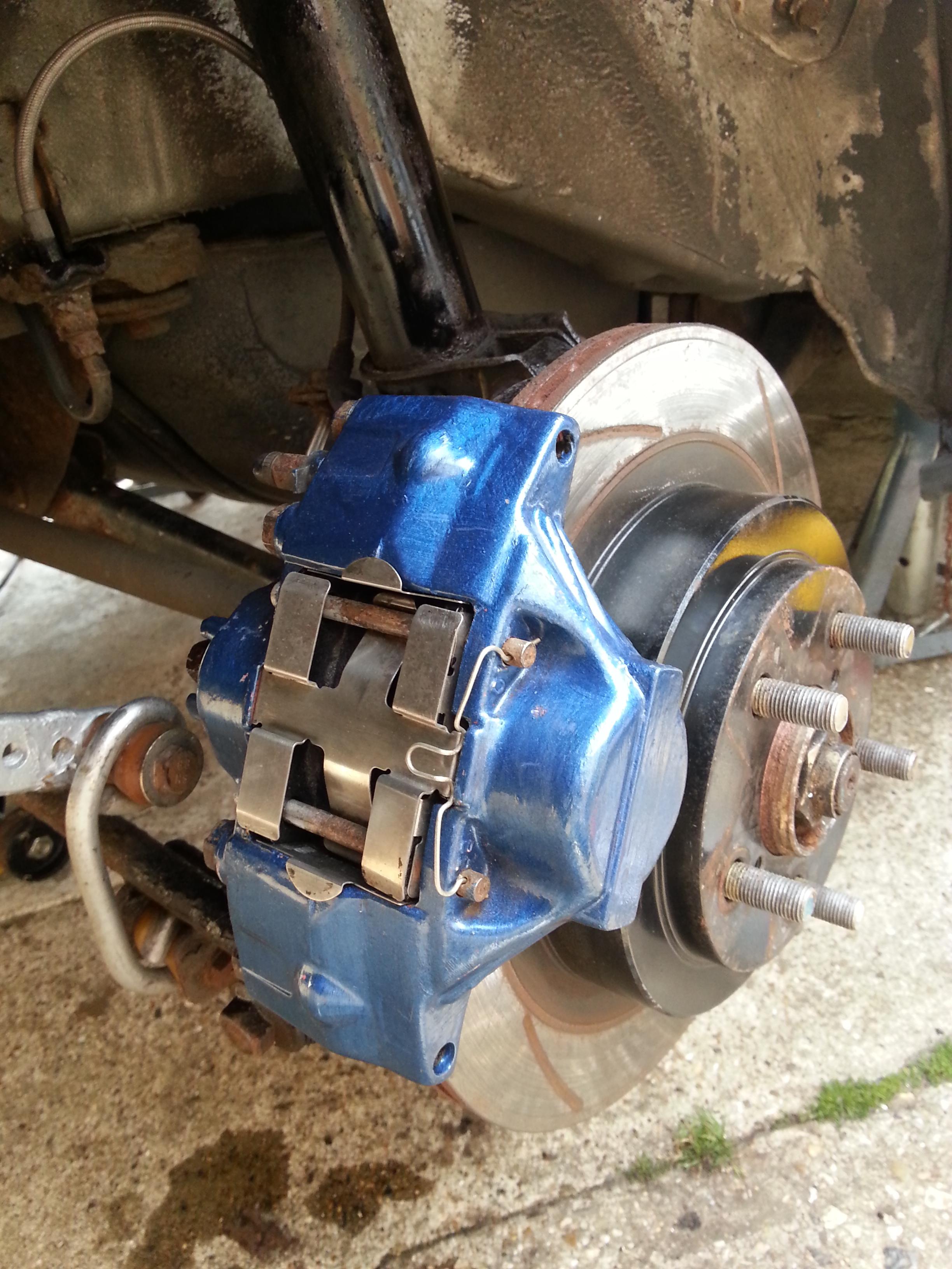

Changed the brake fluid , fitted a new set of pads all round tthe rear discs and calipers then adjusted the hand brake shoes .
can't tell you if it's made much of a difference as I'm trying not to brake to hard untill they've bedded in a bit but they certainly look like they're gonna work a bit better
Done 100 miles or so and the new pagid pads all round and rear 2 pots have made a world of difference as it's not squirming under heavy braking and stops much quicker .

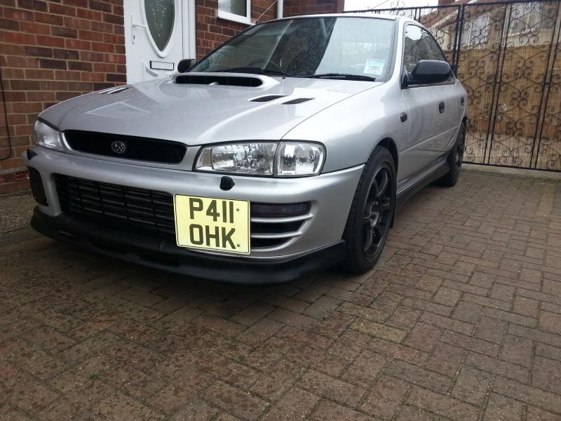

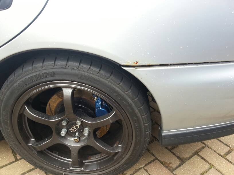

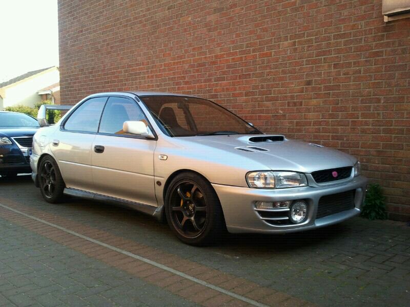

I have been running 6 mm spacers as I found my speedline chronos wouldn't fit over my upgraded brakes .
so I stole some rotas off my brvs classic which we'll be braking at the end of next month 🙂
Pics not the best quality but here's one with the rotas fitted
the offset is much wider so I don't need the spacers anymore and their not actually black more gunmetal (dark grey metalic) I'm still not 100% sure if I like them more than the speedlines but if I do keep the rotas I think I might fit a black scoop and mabye some tinted crystal head lights to keep up with the black n silver theme .

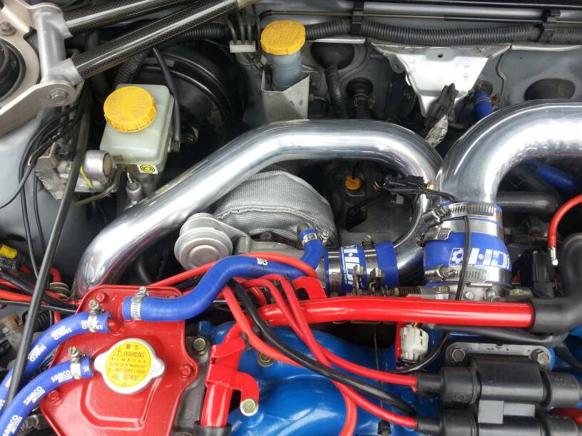

Like most people that fit a bell mouth de cat, I had removed the turbo hotside heatshield . the fmic pipework passes over the turbo exhaust housing and although inlet temps are good after the fmic core the turbo outlet pipe was getting very hot .
So I've since fitted a cheap (£45) turbo blanket
Although the pipework's still warm it's now much cooler [emoji4]

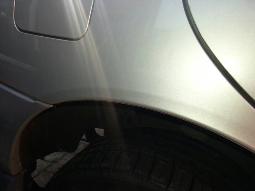

Well as some of you may know while cleaning the scoob I managed to jet wash the bubble off my rear arch and rip the rear arch bumper mounting point off[emoji35]
I had originally planned to do a 2 door reshell rather than spending a fortune battling the UK rust .
My brv owns a v1 sti which although is older than my uk shell , it's mint underneath due to only being in the uk since 2009 .
20 yr old jdm arch
