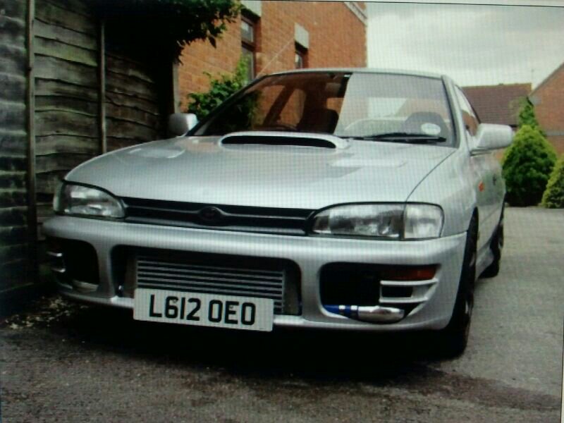

It did look like this when my brv picked it up 2yrs ago post-1399-14045622091_thumb.jpg
That was a nasty ebay special so we switched that for the autobahn fmic off the breaker .

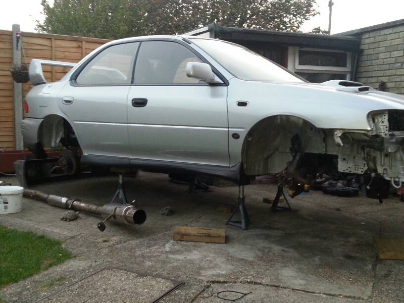

The car was made in may 94 so has obviously got a few marks on the bodywork .
The general idea is to remove any rust , prep, repaint and protect the underside of the car .

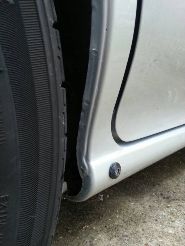

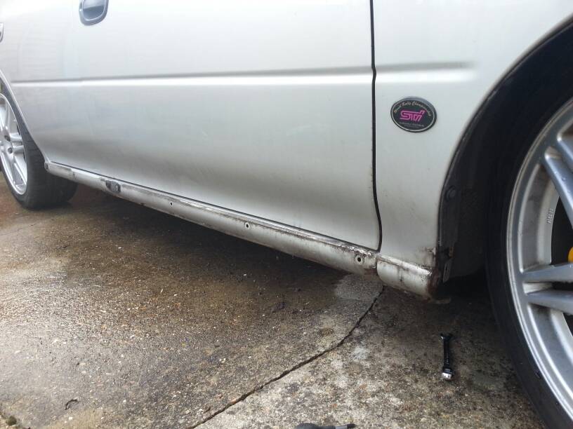

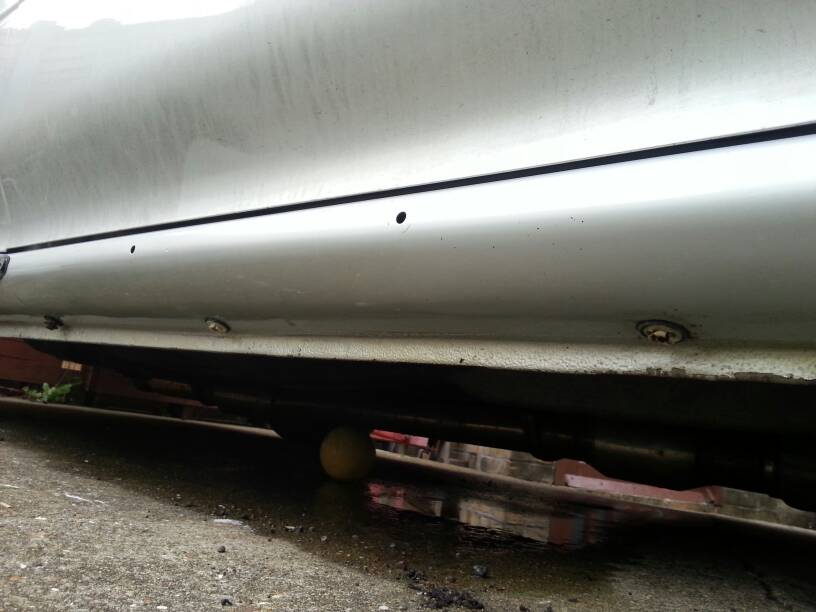

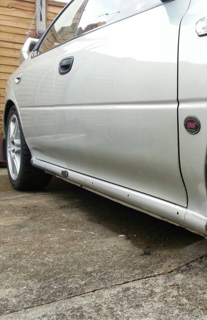

so I thought I'd remove the side skirts and see what lies beneath .
Just a tiny amount of rust along the lip of the sill post-1399-140856805258_thumb.jpg
rear arch this side is in slightly better nick than my 17 yr old uk[emoji4] post-1399-140856813972_thumb.jpgpost-1399-140856815163_thumb.jpg

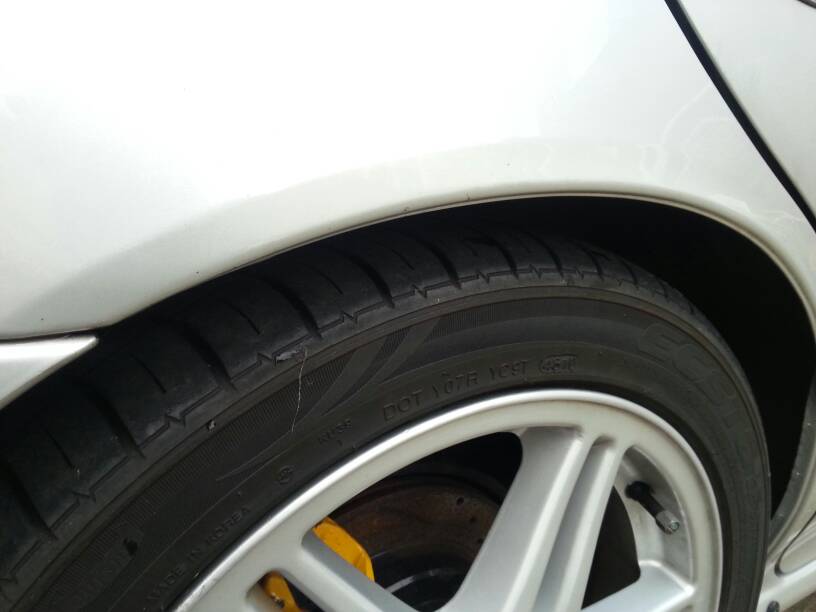

Hopefully the other sides will be in the same condition and once done I'll start on the inner rear arches . Unfortunately they've been rolled but fairly well and have been resealed (painted)

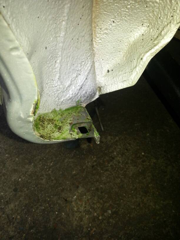

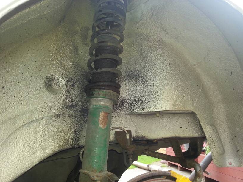

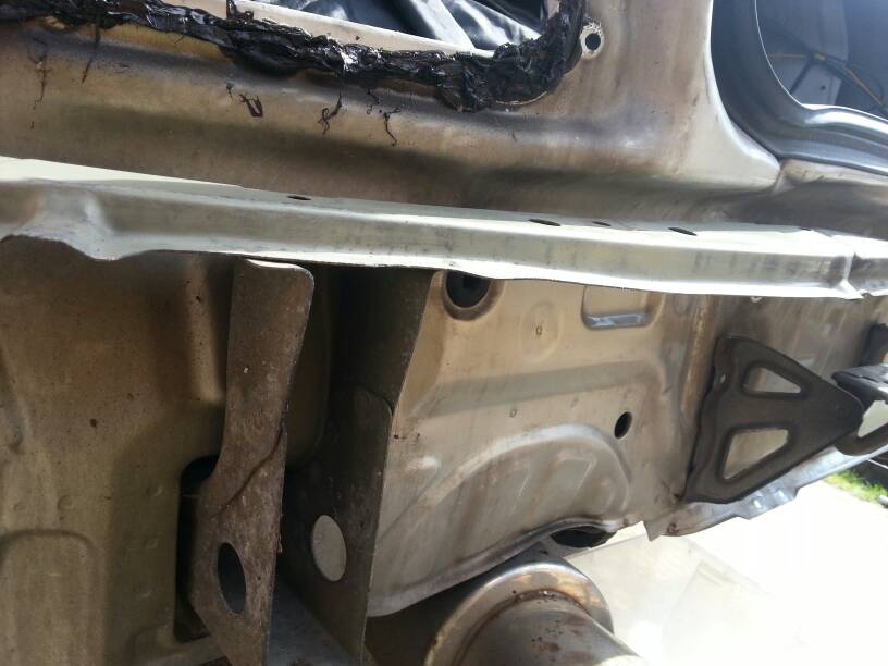

I've been stripping the shell down a bit more today in order to get to the main areas that are prone to rust on classics .
Bottom of the wing/ sill
Rear arches/bumper bar
Although the shell is uber clean for it's age ,I wanted to try to protect the underside while having it off the road .
what few bit's of surface rust I found (after a clean up ) I sanded , treated and primed ready for stone chip and paint .
Before
After
Unfortunately I won't be able to paint the arches yet ,till the engine's gone as I want some weight out of the car before I remove the coilovers.

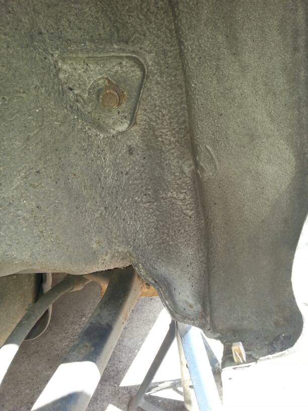

I'd recommend to any one who's got the dsr wheel of to give that area a clean as well as the back of the inner arches .
They've completely disintegrated on my uk [emoji19] and that was clean when I bought it 3yrs ago

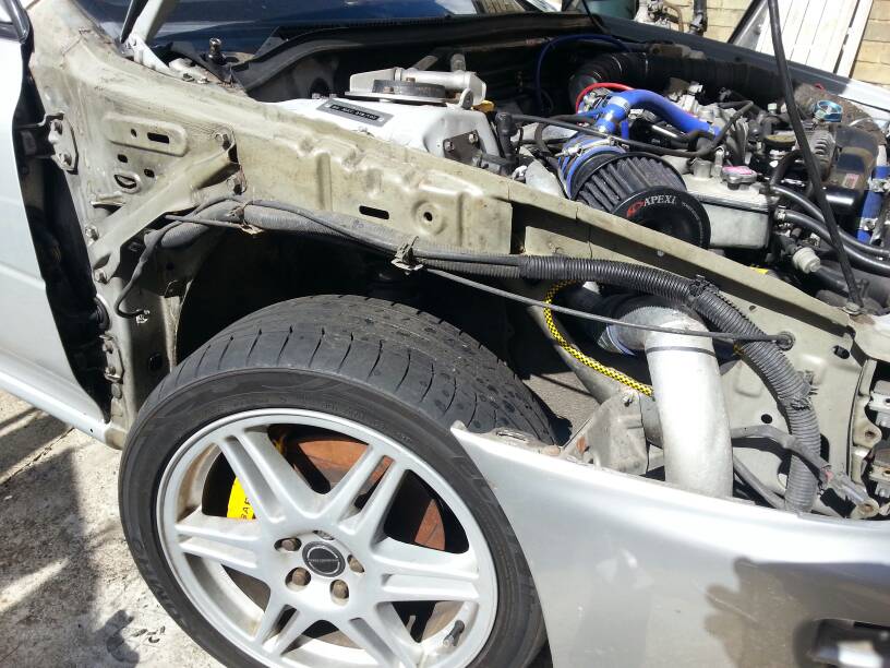

Now the v1 sti's engine's been re home'd t thought id remove both wings and the scuttle pannel to make sure the drain channels were clear .
got a bit sidetracked and 5 hours , 2 toothbrushes and half a bottle of machine cleaner later
Just need to find a product to seal the paintwork that can be sprayed on .
as I don't fancy waxing and having to buff it off .

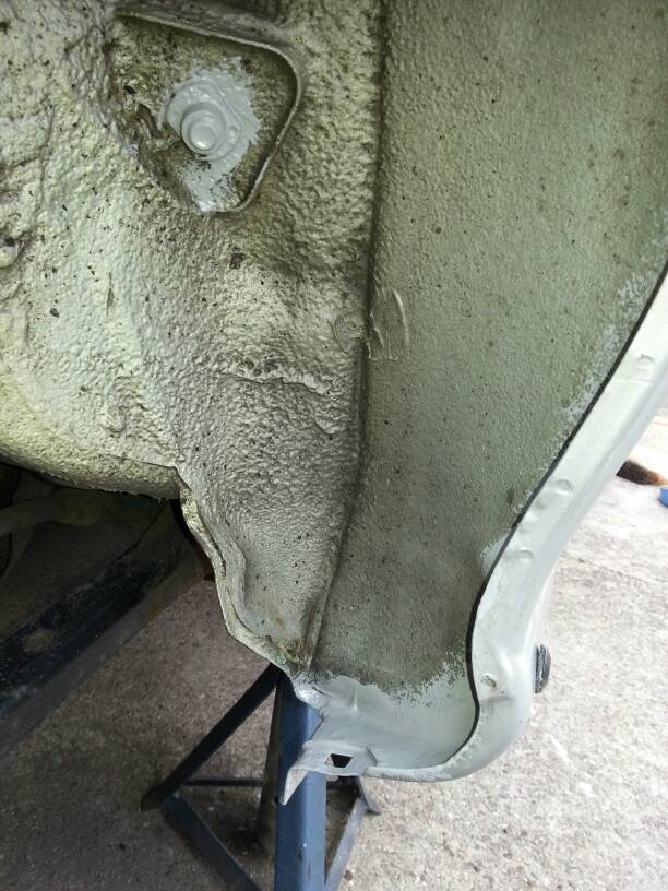

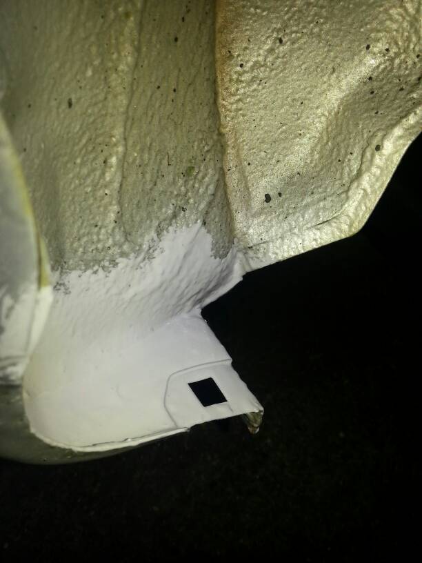

Done under all the arches as well now [emoji5]
They've come up well for a 20yr old car , without any rust or flake y stone chip anywhere.
I'm not a fan of underseal as when it flakes it traps moisture behind it .
So i Think I'm gonna give them a coat of silver paint.
I'll wipe with some thinners to degrease and supple up the stonechip a bit , which will also help the paint adhere better .
What little surface rust that's been found I've sanded back and treated with rust killer .
then gave the area a coat of zinc heavy rust killer primer .post-1399-140994932643_thumb.jpg

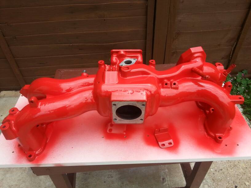

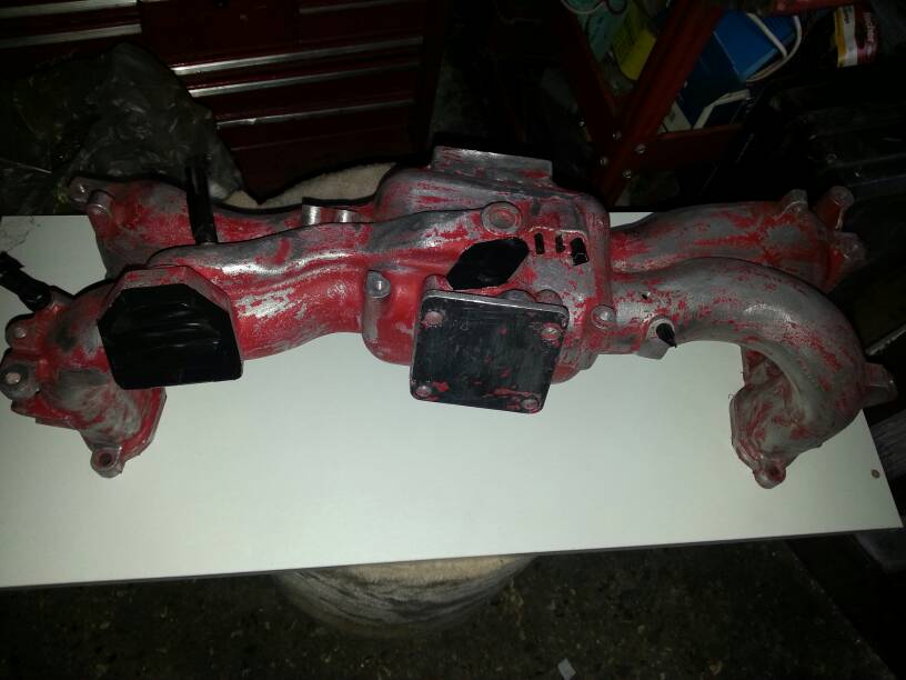

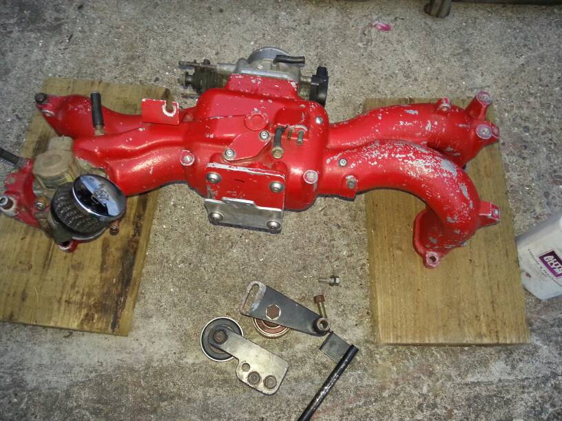

Had the (untidy looking) ex andy forest race car reverse v1 inlet and alternator relocation bracket turn up today [emoji4]
So stripping , prepping and painting this will be the next sub project
I stripped the Inlet as it had to be sanded back as the paint had started to flake [emoji19]

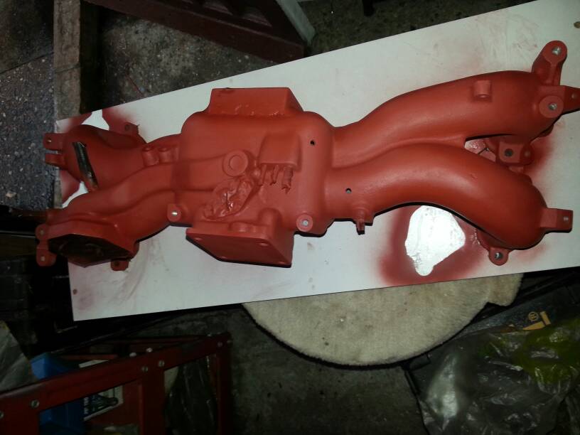

masked all machined surfaces and After 2 hrs sanding I sprayed it with adhesion premotor (it's clear in colour) post-1399-141129713411_thumb.jpg
Colour coat
Got to let it dry for 24 hrs [emoji19] before I can flatten it off and give it the final coats of lacquer . So hopefully mid week I'll start to build the inlet up with the phase 1 fuel lines , engine loom, vacuum lines ect... of the sti inlet

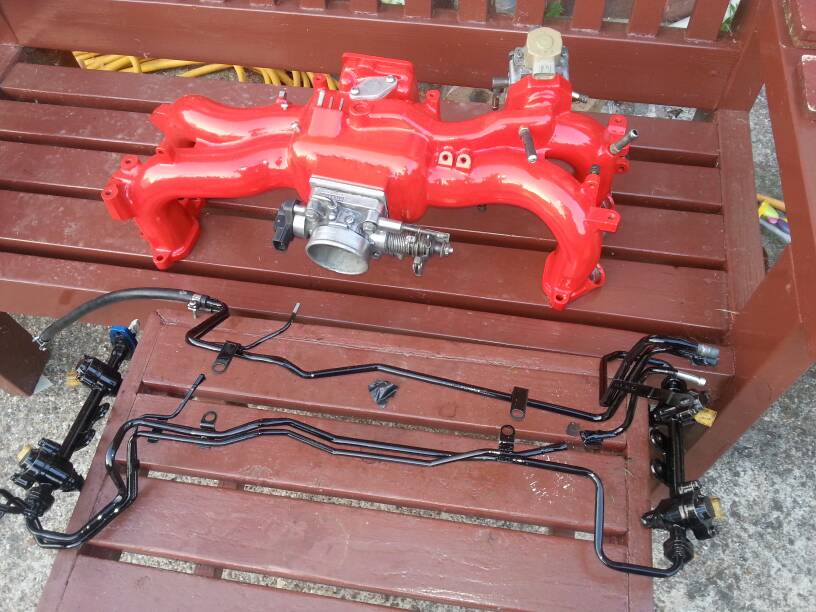

Made a bit more progress with the inlet today by stripping down the v1 sti's inlet .
cleaned and checked the engine loom for damage/breaks in the insulation
Cleaned and polished the throttle body and icv
Stripped , cleaned and painted the fuel lines
