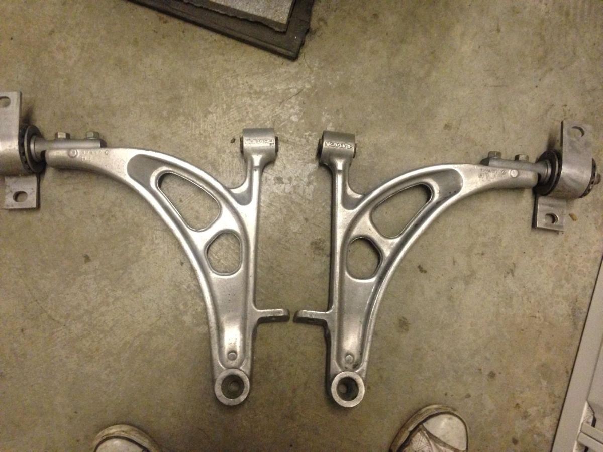

I have a question, will alloy wishbones from a classic fit an early new age? Also... are they worth it? I can get a pair for £70!
I read that classic and bugeye share more parts than classic and blobeye upwards but hey I don't believe everything I read on the net
I'm fairly sure that anti lift kits are sold for either newage or classic fitment and they bolt to the wishbones .
Ally one's are lighter and don't rust but bear in mind you'd have to change the front droplinks to suit ally wishbones as well .
Personally I'd leave the steal ones in situ unless yours are showing signs of excessive rust or your replacing/upgrading some bushes in that area
I was planning on getting some CDF drop links and these alloy wishbones got offered, thoughts being... may as well do both ;)
I not 100% sure about the wishbone fitment but if the part numbers for the ally wishbone bushes on classic and bugeye are the same then in "theory" they should fit .
If you do buy any ally arms make sure the seller includes the "cones" which are sleves that sit on top of the balljoints to stop them wearing the taper in the ally wishbones they sit in .
I'm running a bump steer kit on my classic and had to make sure it was suitable for my ally arms so check the balljoint part numbers too bud
I sold my last set of classic ally arms with cones for £40 but they only had standard bushes in
post-2084-0-46728100-1422224864_thumb.jp
Those are the wishbones, my mechanic reckons they will fit so I shall contact the guy tomorrow and see what he says. Thanks for the advice again Savage :)

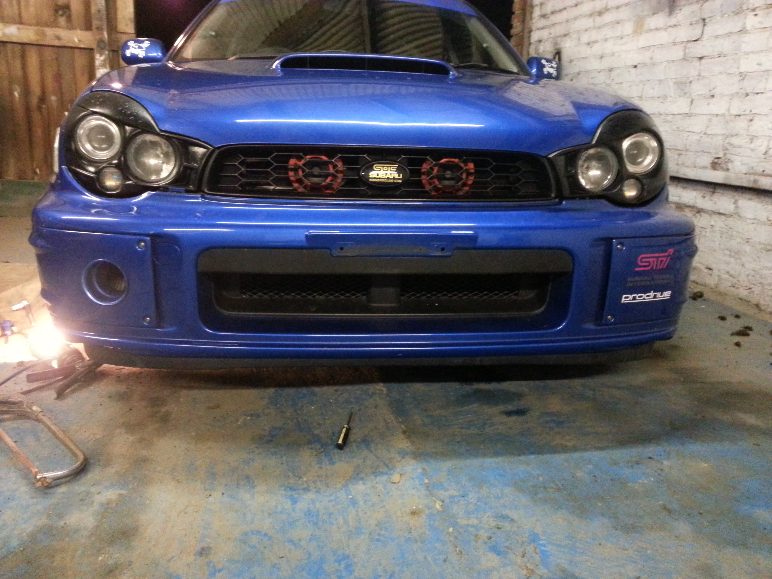

But heres what I've done new bumper fitted and pipe to the induction kit.
Liking that bumper!
