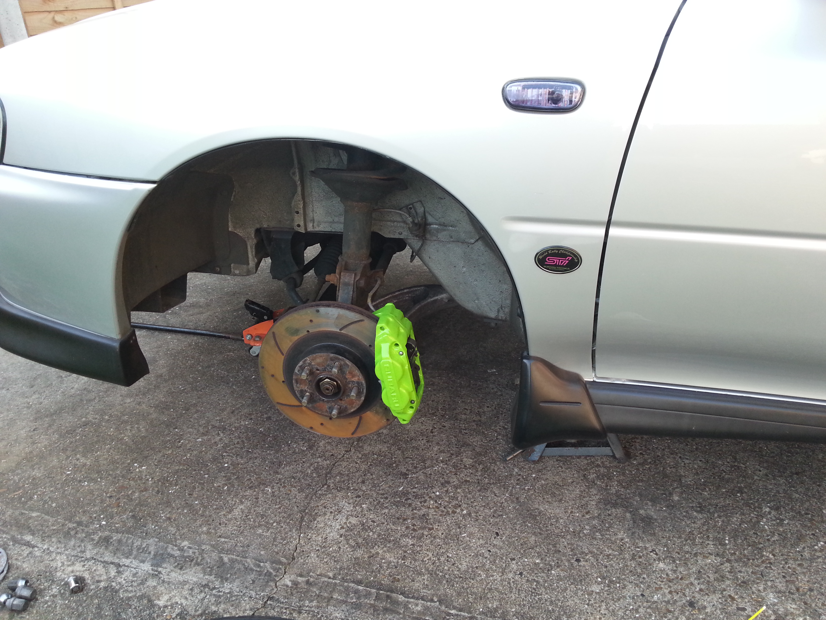

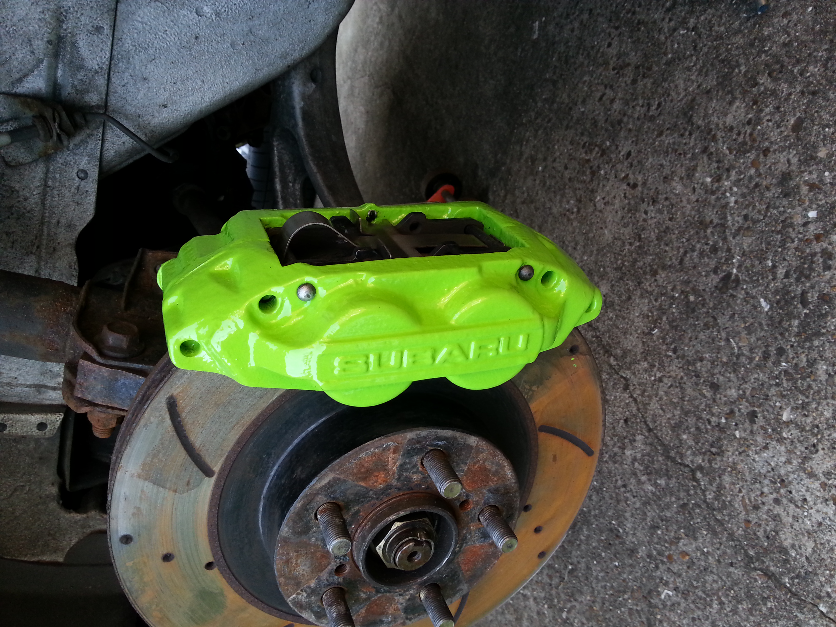

What's involved in painting calipers, much prep ?

Mine weren't too bad as they were shot blasted , primed and painted 3yrs ago when I refurbed them with stainless steel pistons (so I did them in situ)
Pulled pins and pads out
Sprayed them with degreasent and wiped them over with thinners .
Wire brushed and sanded them a bit with a scotch pad to give the paint a key , wiped them over with thinners again .
2 coats of brush on lime green paint later
Might paint the "subaru" bit in black at a later date but I've still got the rears to do first
