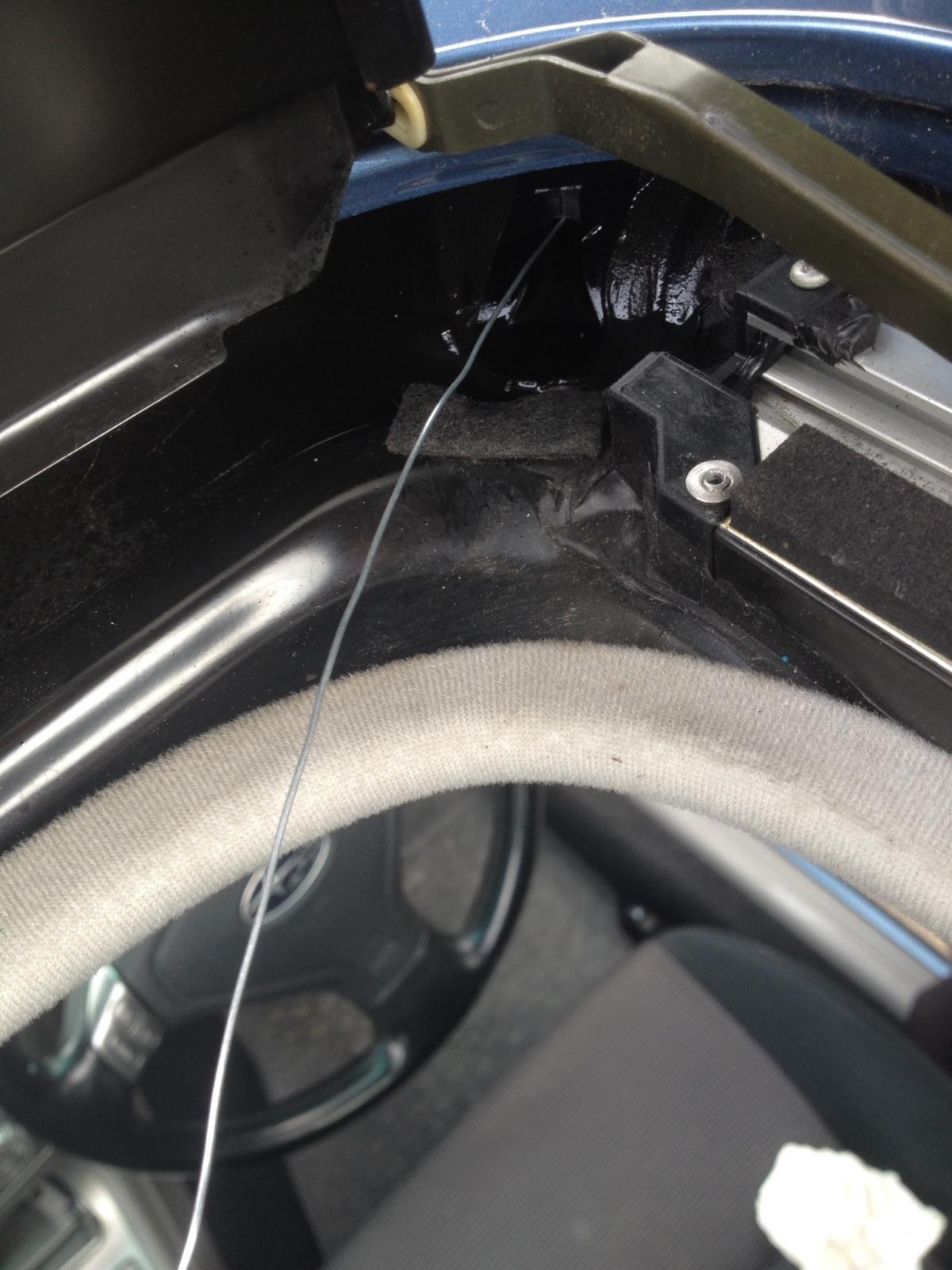

I wonder if anyone has come up against this problem I have a water leek that drops on my accelorator foot happnes not very often vets food no wet carpets went in to subaru garage fault not found only very small amount the car is a 2011 forester please help if you can also intrument light seen to brighten on ther own then go back to normal settings.
Maybe from the internal heater. If you've just started using it then sometimes all the crud gets trapped in there because its the lowest point. Soon as you turn on the heater and try to push water around it, if blocked it will leak from where the heater hose joins. Maybe worth having a lot around the back there.
